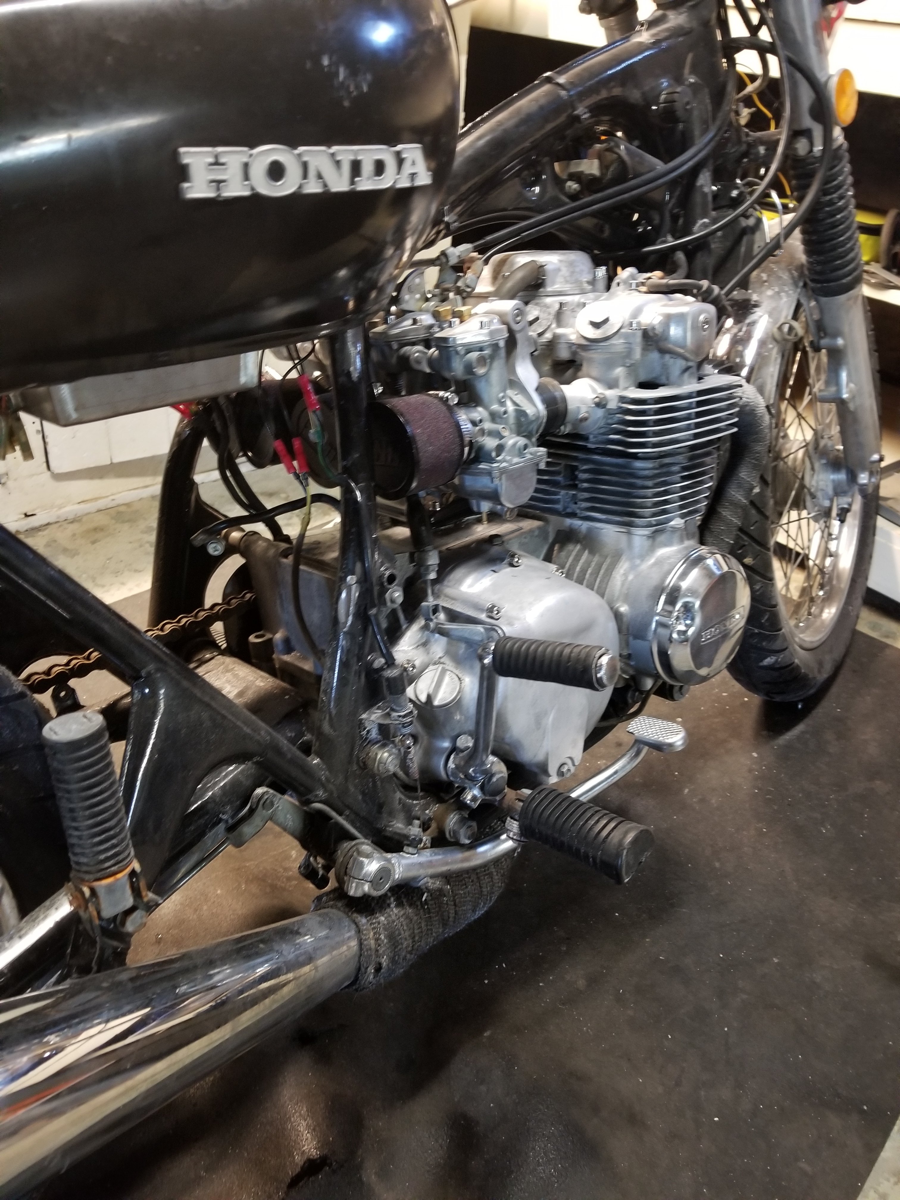

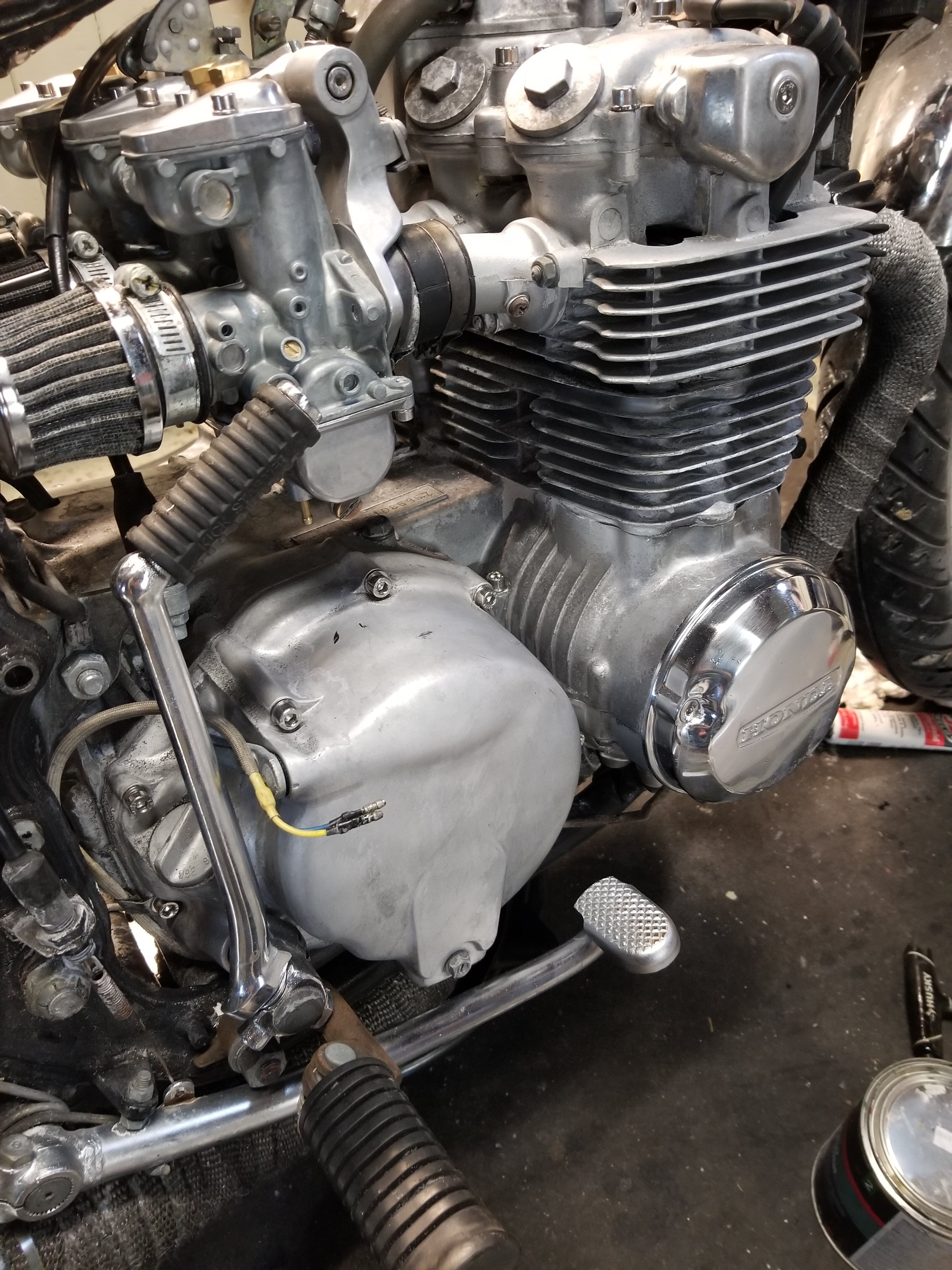

1976 Honda CB550 (my first build ever) rebuild cafe
Added some support beams for the seat mounting, got a magnetic drain plug, and added polished Allen bolts to the entire engine which I think looks really nice. Working on wiring next.
Also did an oil change and will be adjust cam chain, valves next

I agree they are lame :/
But my question is do the K&N provide any benefit other than looks for the bike? They are quite pricey...like 150 for 4 :/
The cheap pods are known to block air inlets on the back of the carb. You can modify them if they do. They're also known to let way too much air in, and need some restriction to work well with stock jetting. TBH, the ones I've bought in the past had filter media so thin it didn't look like they would filter much of anything.
Look into UNI. Your air intake is one of the 3 important things that make your engine run and run well. Why risk getting dust and dirt in there to save a few bucks? Just my .02

Any idea if these need to be modded to not block the opening and do they need to be oiled?
.....I like the look of those and will get them as I like the look and if better performance def. are worth it

Yes, the UNI's are really good filters. They'll perform much better than the Emgo pods. Remember that they need to be oiled as well.
You can also find K&N style pods for less than K&N's at https://www.aperaceparts.com/

No they should not need to be modded. I get the UNI brand filter oil it comes in a spray can but you can also just use engine oil I believe.
