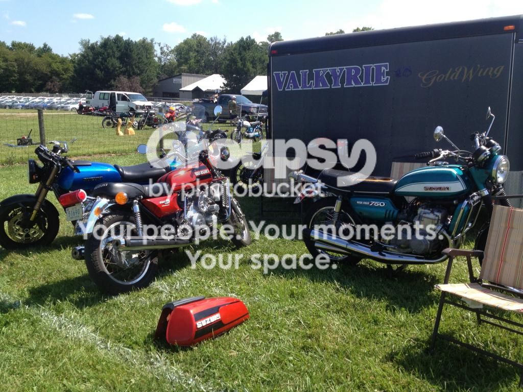

Set up camp in the Vendors section to sell my original 1972 GT 750
1972 GT 750 California blue sold....

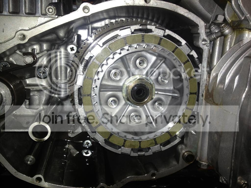

So I got back from Mid-Ohio and decided to install my new performance clutch and do some annual maintenance. The original from 1976 had done its job, but was beginning to slip in the power band over 6000 RPM. The plates were glazing and the cork/fiber was breaking down. The new Barnett clutch DOES NOT, and probably will not slip ever. Initial engagement is easy and lock up sure. Of course the new springs and clutch pull is for real men.

After install

Thanks for continuing to share your exploits on your Buffalo. I have found the stock clutches work even with more HP if you bead blast the steel plates. Once the steel plates glaze they lose grip. Also bead blasting makes them a little thicker as well helping them grip more. Measure them out and use the thickest for blasting.
Using the Barnett give you Popeye arms as they have heavier springs and usually and extra steel and friction plate. Making the clutch lever on the engine longer will make it easier to pull as well.
Thanks Eric! I really got the Barnett to satisfy my curiosity and to compare to the stock clutch as the steel plates were glazed and slipping badly over 5500 RPM. Even though they measured out fine and looked like they could be scotch brited I opted for the newer setup to see if I was missing anything. The clutch pull is really not bad as I am use to Barnett's from using them over the years in my other bikes. I am curious to see how it will stand up in the GT over time though. I think the bead blasting is a great tip as I usually just clean them up with a scotch brite wheel on my DA. Jury is out on the Barnett for now, but I will put it to the test. ;D

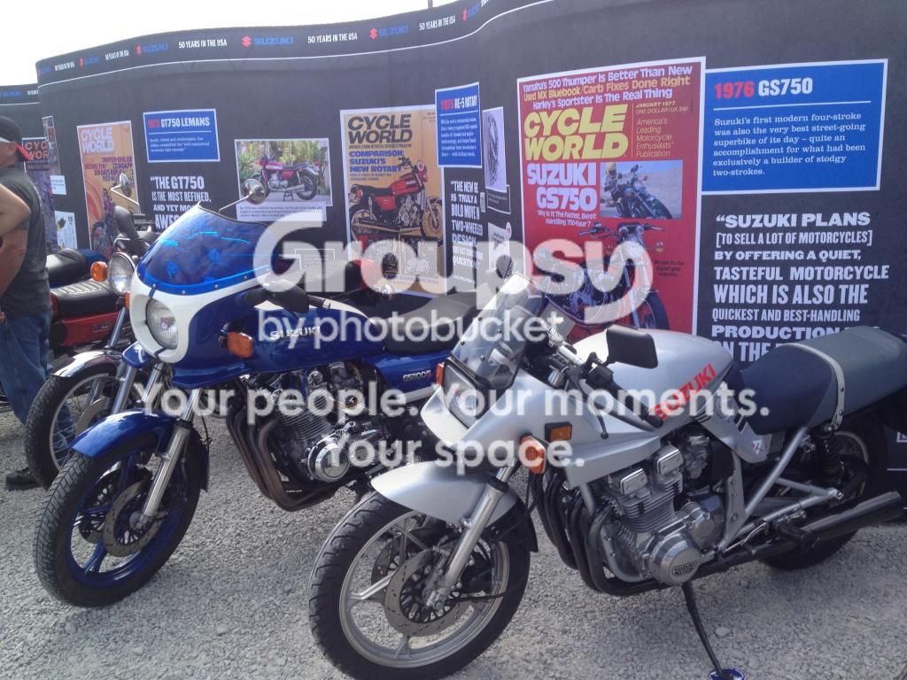

My father flew in from CA to ride my GS1100 G Cooley Custom while my son rode my Katana 1000S, and I bombed along on my GT 750 Sport Cafe. We rode roughly 500 miles for the trip. We watched practice and did the track lap Friday on our three vintage Suzukis. On Saturday we were at the Cycle World Rolling Concourse with 150 other vintage bikes. We had 3 generations riding my Suzuki's for the weekend, Grandfather (66), father (44 me) & son (21).
My classic Katana ready at the show after Rolling.
82 1100G Cooley Custom AKA ViperG that I have had since I was 19. I finished the mods in 1997.... 40,000 miles later...
Bad Buffalo flexing some Suzuki Smoker muscle in the modified class.
Bad Buffalo getting the once over.

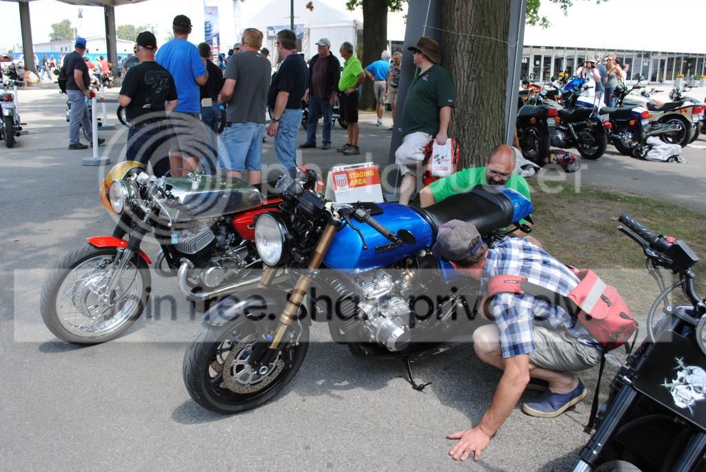

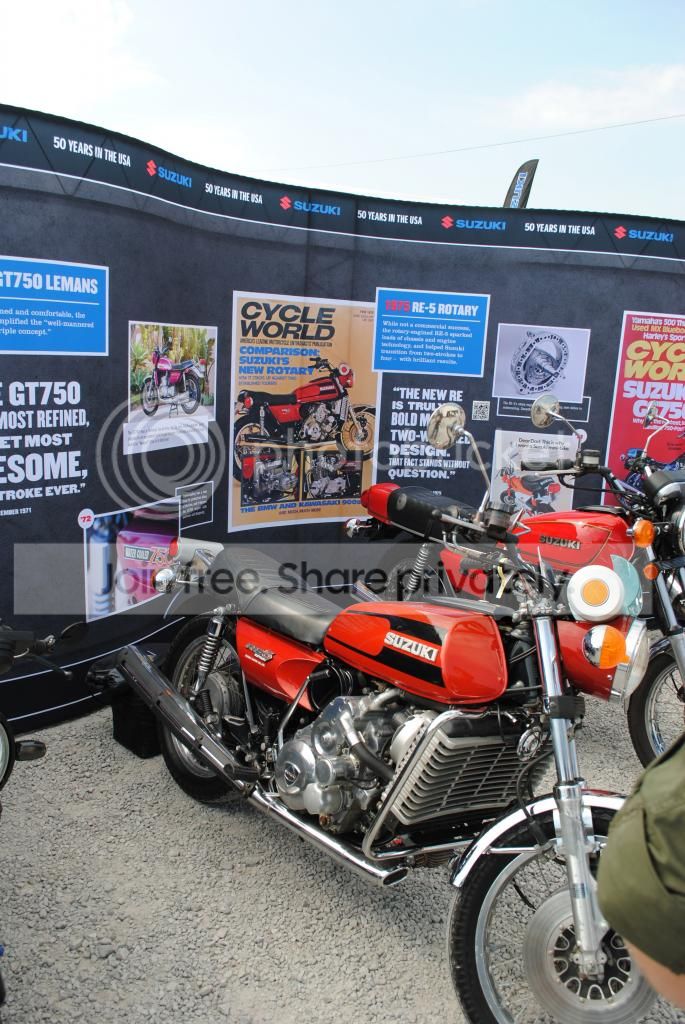

A guy from Suzuki asked us to bring the bikes down to the Suzuki Tent to put in the USA Suzuki 50th anniversary historical time-line for Sunday.
My 1976 GT750 Water Buffalo. As many of you know my GT750 representation "Bad Buffalo" is slightly different from the original 1972 J model on the time-line wall. I have owned both and assure you my current set-up is more fun to ride and just as reliable (more so) than the original. My buddies original, low milage, running RE5 next to my Buffalo. His exact model represented on the Suzuki wall behind the bike with Cycle World cover pictorial.

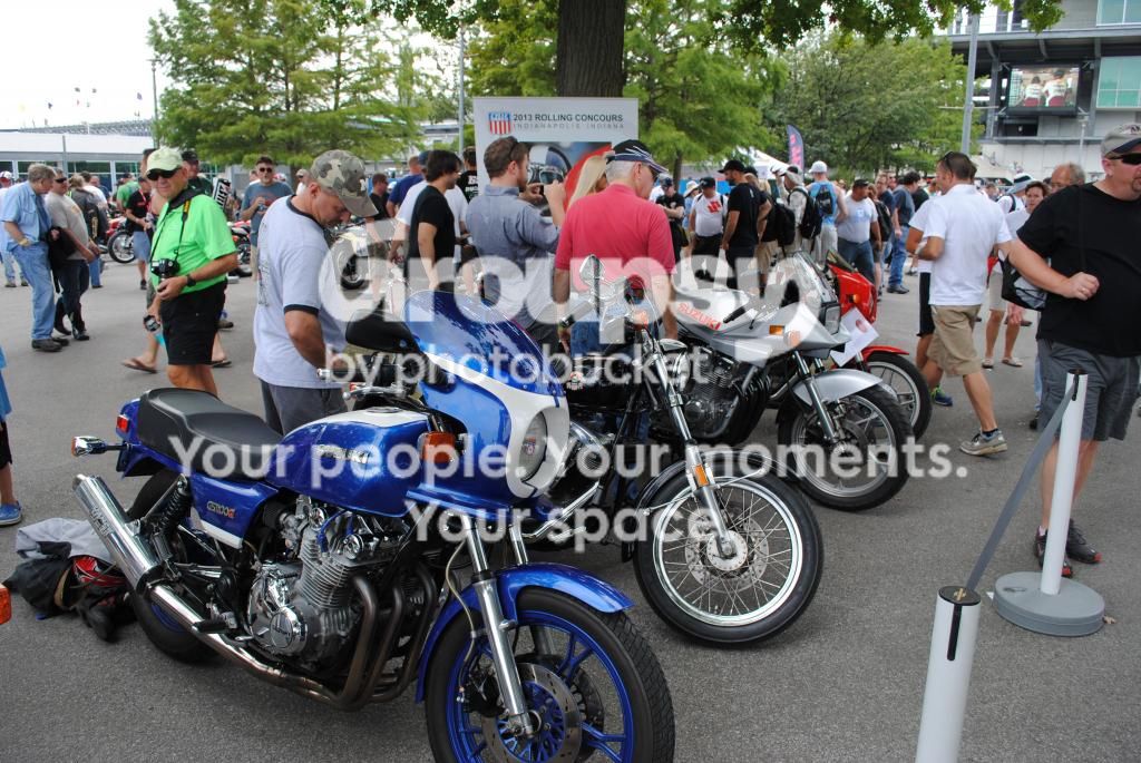

Indy Moto GP 2012 Cycle World Rolling Concours

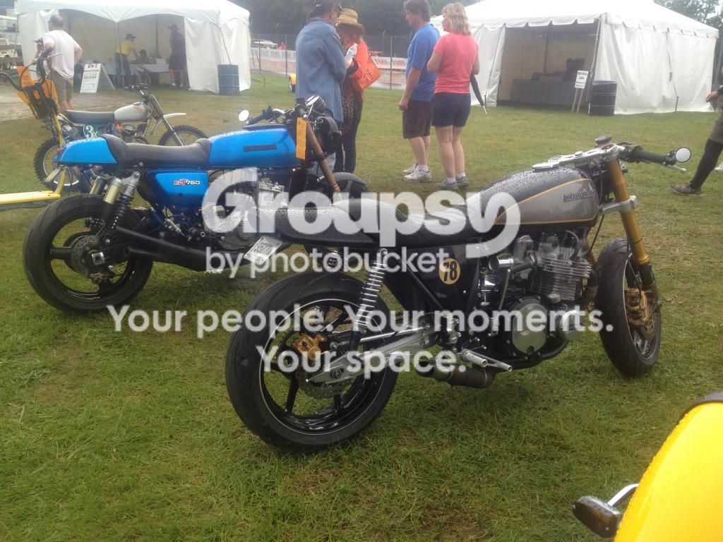

XS650 Rat in foreground with Bad Buffalo. The XS650 was one of the most interesting bikes at KKD
