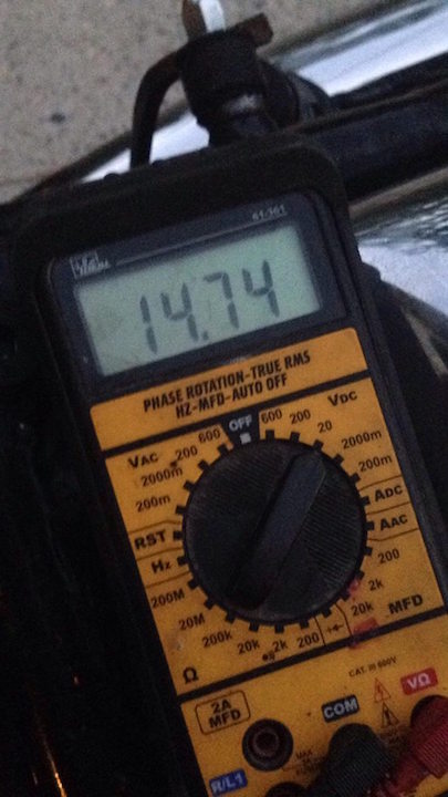

After chasing gremlins in the charging system on this bike for months, I've finally gotten it all sorted out. First issue was the stator, which got replaced and seemed to get it running for a bit. Second issue was a bad reg/rec that apparently was wired for a DOHC yet marketed for an SOHC, or something like that. Bought the cheap reg/rec off eBay like we talked about up there ^^^ and it ran well for a bit. Third issue was the field coil. At the beginning of the summer, the ignition seemed to start dropping out and fouling plugs. The charging system could hold a charge sitting in the garage at idle, but as soon as you take it on the road voltage would drop below 12v. You could rev it up to 12v+, but it got to where it was worse and worse. I tested field coil at 7.8 ohms resistance, so bought a unit off of eBay. On a hunch, I replaced all of the wire to the field coil and instead of bullet connectors I soldered the wire under the shifter cover. A layer of glass tape, individual shrink wrap, bundle shrink wrap and an abrasive resistant sheath later and I hooked it up. Finally, after all this time the bike might actually charge like it's supposed to...
