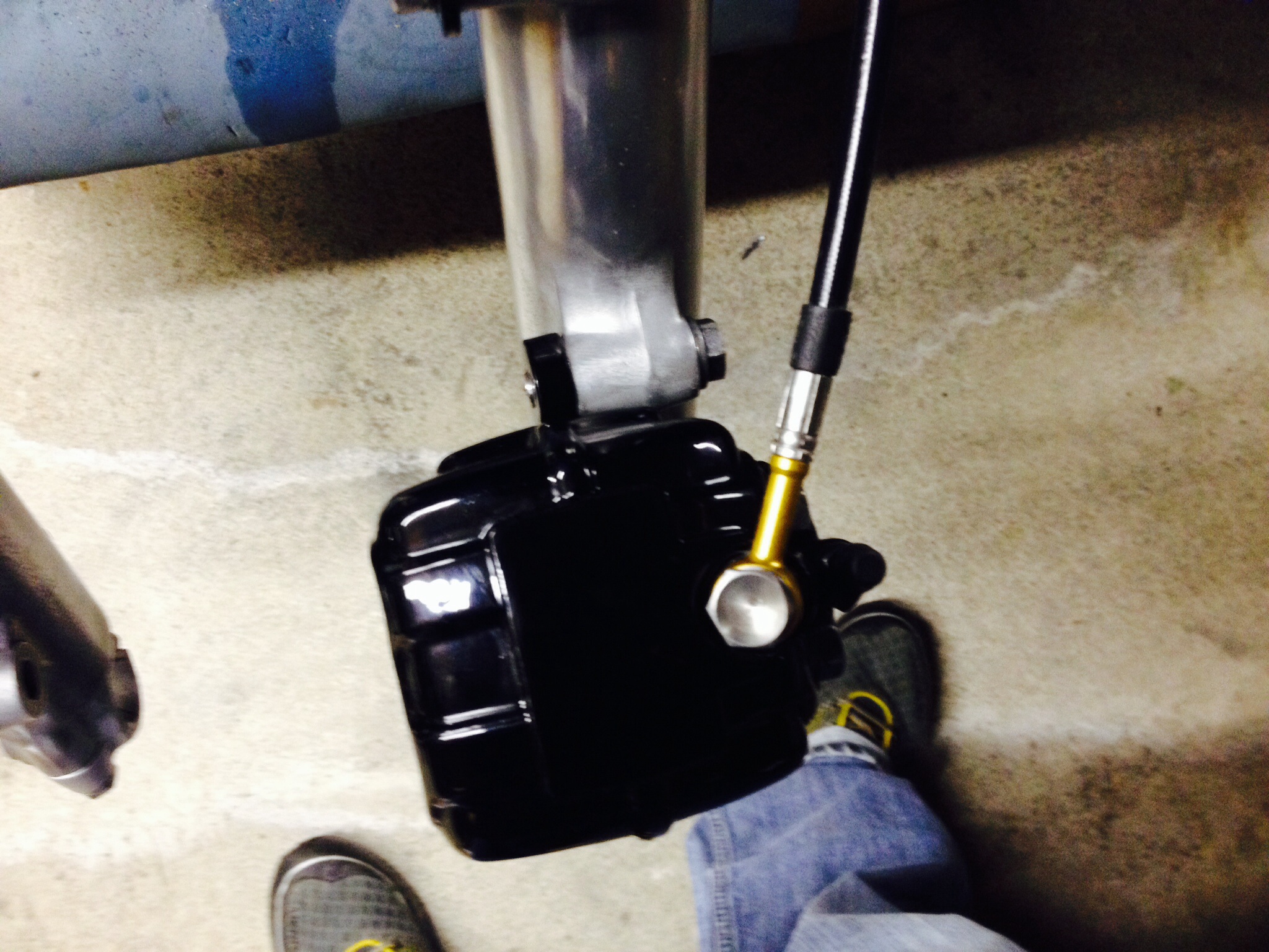

Rebuilt powdered caliper with new pads,all new seals and stainless banjo. Also have custom Spiegler line and Busa master to go with..

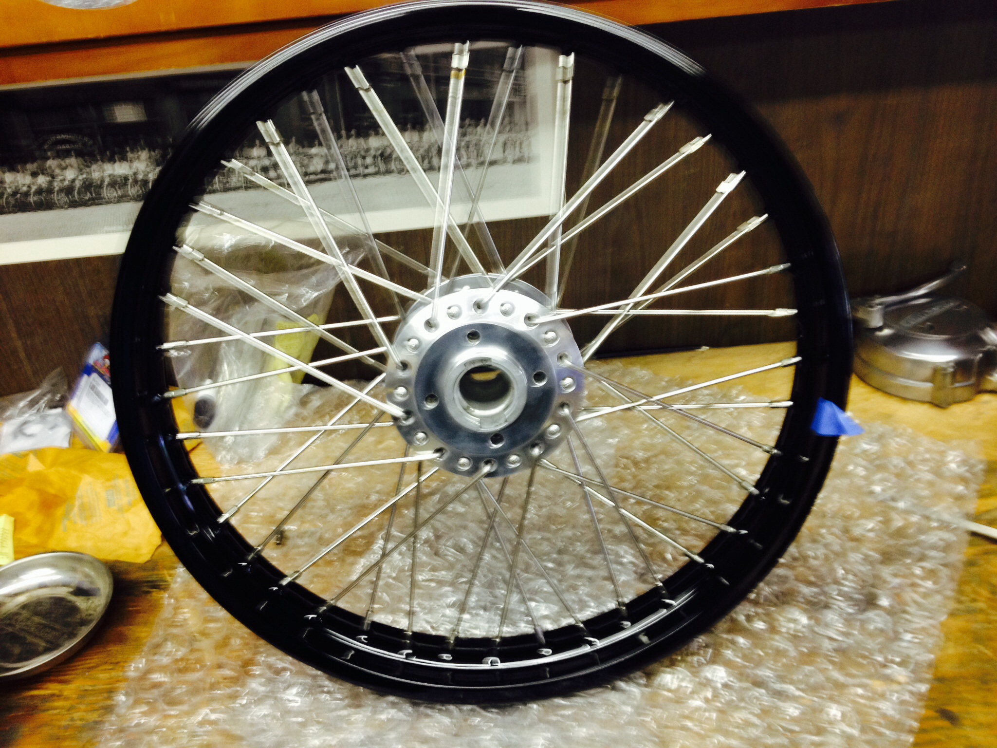

Front wheel powdered and laced up with Buchanan stainless spokes and nipples ready for truing. It took about 30 min to lace up. I'll have about $300 in the wheels between powdercoating,spokes and bearings.
