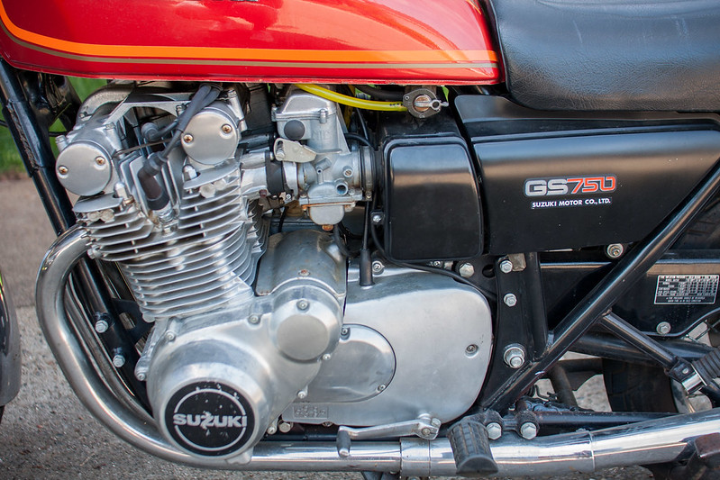

Hey my name is Josh, I picked up my first bike, a '77 GS750 about two months ago. Since then I have mainly been focusing on learning to ride. Thankfully I have my dad who has been riding for 20+ years who has taught me a lot so far. I have been thoroughly enjoying the bliss that is riding a motorcycle.
Here are some pictures of how she came.
jackbday-8-3.jpg by macbethpoe1, on Flickr
jackbday-6-4.jpg by macbethpoe1, on Flickr
jackbday-3-4.jpg by macbethpoe1, on Flickr
jackbday-1-3.jpg by macbethpoe1, on Flickr
It has about 10,000 original miles on it, and appears to be well kept. Since it is riding season now, my plans are mostly to ride, and learn how to do so safely. And also, I want to get it running as best as possible, without doing anything too drastic to take it off the road for too long.
