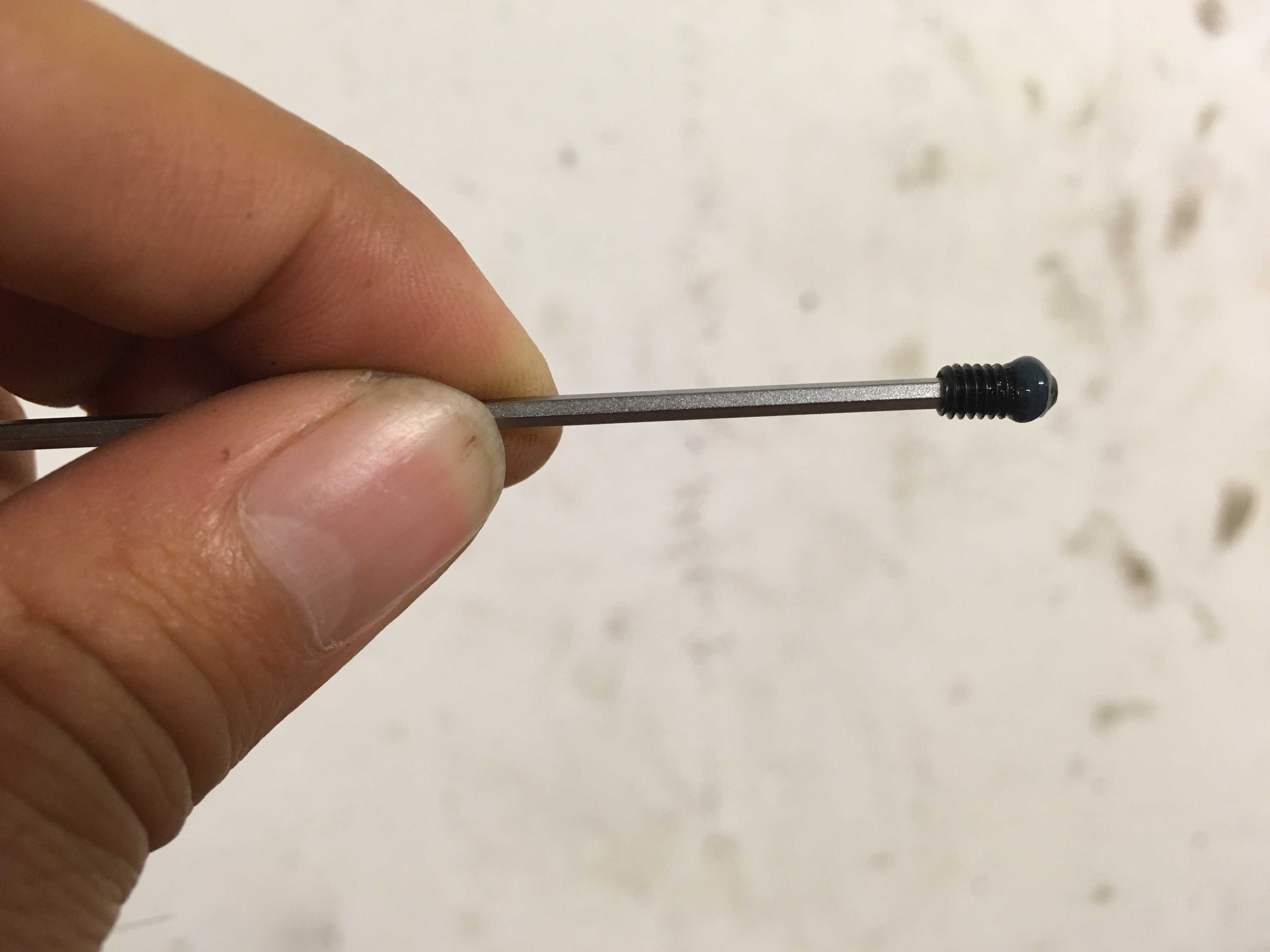

Anyway, to my horror, two of the tips of the pilot adjustment screws were broken off in the the carb bodies. Some ham hand had screwed them in so damn tight they snapped off. Turns out this is more of a common problem than it should be… My options at this point were to junk the carbs and try and pick up a second hand set, try repairing these ones, or do like the previous owner and sync the carbs so that it is biased towards the right hand carb where the pilot screw was still functional - therefore allowing the engine to barely idle by relying heavily on that cylinder over compensating for the other two cylinders which were almost receiving no mixture at all until around 1/8th throttle (thus explaining the discovery I made when syncing). I thought fuck it, I’ll have a go at repairing them and worst case scenario I stuff them a bit more than they already are!

There seemed to be plenty of info online where people have gotten broken adjustment screw tips out of carbs where the screw sits a top the carb - inline with the flow and perpendicular to the axis of the throat. These particular carbs have the adjustment screws on the sides of the tops of the carbs - lying flat with the axis of the flow. I couldn't find any info about this issue online, I am sure there is somewhere and many have probably solved this issue one way or another (please share if so!), but there seemed to be no way to get at the other side of those broken tips to be able to push them out and remove them.
So my solution was as follows:
Punch a centre mark for drilling right in the middle of the boss that contains the mixture screw on the opposite side.
Drill a hole with a 3.3mm drill bit so that you can later tap this hole to M4. Drill just deep enough that you can see the very tip of the broken tip. It should be pretty clear because it is brass in aluminium so it will show up goldish against the silver background. Don't worry, by doing this, you are not actually affecting any of the orifices that control fuel metering (I think - I have looked at it for so long trying to be certain…).
Now you have a clean shot at punching out that broken tip. Depending on how hard the muppet who got it stuck there in the first place screwed it in, depends on how hard you will have to hit it out. These were stuck real good. I used a hardened steel mechanics pick to start with, then ground down a small carbide drill bit to a point and continued punching till it came loose. Notice the drill bit had a slightly smaller diameter than the pick and I think this was the ticket. Eventually got both bastards out. Look at the state of these screws! They are even bent in two places, indicating they have been screwed in so damn hard!

Once the tips were out, it was time to tap the holes with an M4 tap. I went as deep as the tap allowed, but if you were really well equipped, you would have a M4 tap set with a bottoming tap to get the thread all the way to the bottom of the hole. Anyway, I figured it would be good enough/deep enough because that hole just needed to be permanently blocked off.
Then I went to the local bolt supply store and picked up some M4 grub/set screws to screw into the tapped holes. Here it would have been better to use stainless and to use a shorter length, but this is what they had in stock so I took them. After applying some permanent thread locker to seal everything up, I screwed in the screws, hopefully never needing to be opened again!

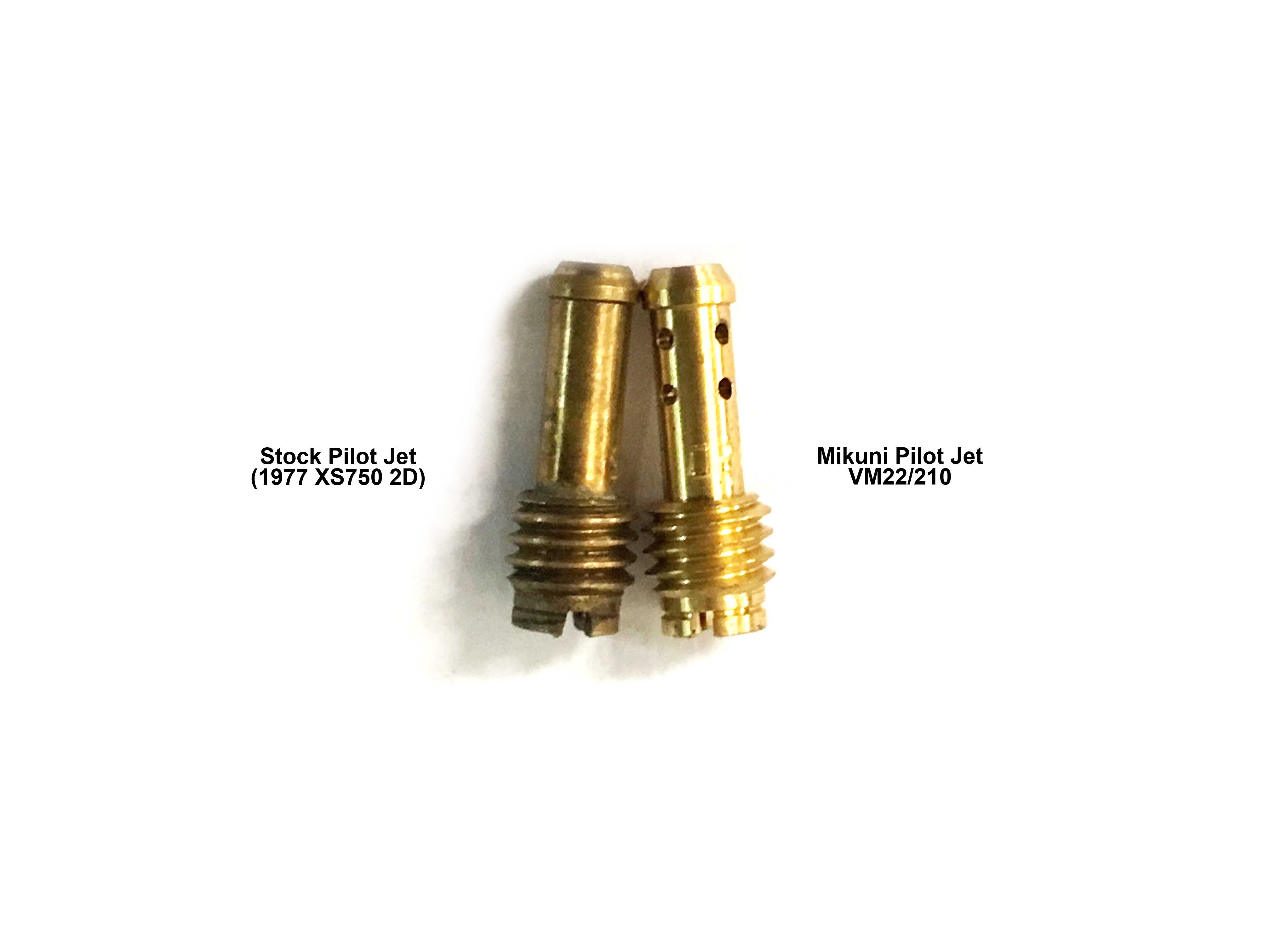

The last hurdle was finding the right pilot jets (mains were easy). The stock pilot jets have the same dimensions as the Mikuni VM22/210 but do not have any holes in the neck. I needed to go up in pilot size so I needed to order these ones. I have no idea if they flow any more fuel or not but I went up 2 sizes to begin with and that was too much, ended up going back down a size. Anyone else have any knowledge on this?

Very nice write up! Seems like you could use the standard VM pilot jets as is. The perforations for introducing air shouldn't make any difference since there evidently isn't an air supply for the solid ones. The VM jets are actually pilot jets and emulsion tubes in one part. The jet itself is just the drilling in the threaded end. The tubular section with the holes fits into an air well and seals with the conical tip. Air supply to the well is controlled by the air screw on the VM's, but presumably there is simply a straight bore in your bowls to house the jet. Potentially there might be a hiccup with there being a tiny fuel reservoir around the perforated tube that the straight tubes don't have, but I bet they work just the same - worth a try as they are very common.
Nice thread. Mikuni made a bunch of different BS series CV carbs and they used different pilot jets. The usual VM22/210 won't work well in a BS because it meters fuel at a different point in the jet. BS30/96 with holes but different is used in BS40 on a GT750 Suzuki.
And then there is the N151.067 without bleed holes which is apparently used on many 4 strokes including Suzuki GS1000 and Kawasaki KZ1000. They are available at most jetting sources.

I removed 2 broken tips using nothing but pliers and cut off nails btw, but the holes had to be fixed with jb weld and reamed after, your method seems a bit easier on the carbs!

Yeah, check those screws man. I spent a good half a day trying to tune these carbs before realising the tips were broken - rendering it a complete waste of time!

Thanks for the info teaser. I looked at the N151.067 jets but they looked a little different - especially around the nozzle/tapered area. Perhaps that is not important? If not, then maybe they would have been a more accurate replacement.
Well at least you got them out! Common problem huh. I can't imagine trying to get them out from that side, must have been damn difficult?!

Edit: i pushed the ends back out the way they came from of course, centered a small piece of nail on the tip and used a small polygrip, holding on the lip of the carb, pop they went! Took the damaged orifices to braigasen for the final mending and reaming.
