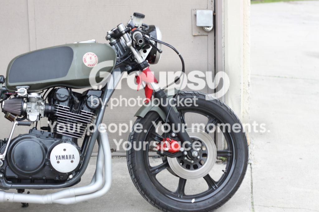

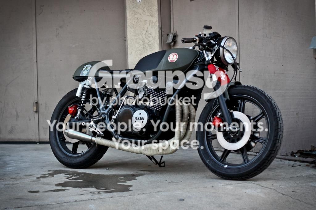

Well I found the site a bit late. Picked my bike up this summer, June I think, and have it mostly finished now. I've been riding it the past month as my only transportation since my car decided to blow both head gaskets :( The bike is mostly powdercoated minus the seat, tank, headlight bucket, and front fender. They are just spray painted flat olive drab green. When I get the car back up and running I'll give the bike a real paint job to go along with the quality powdercoating it already has.
I'll post pictures in a bit, but there aren't any tear down photos. Just the build
Pics as promised.

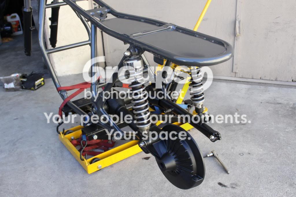

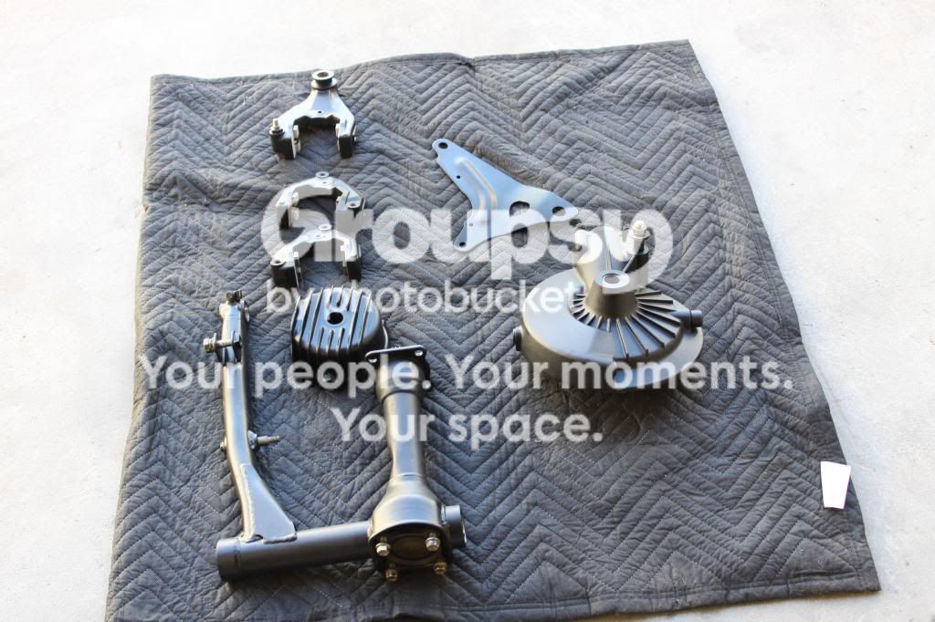

This is my first build so it's a bit of a learning curve. For instance I wish I had fabricated a recessed tray for the electronics instead of a flat plate, and some higher mounts for the rear sets. But the frame was already powder coated when I thought of this stuff.
I didn't want to pull the diff apart and replace it's seals so I just had it sandblasted then painted regularly

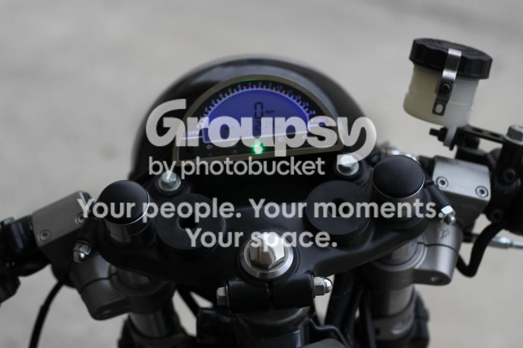

Dan Moto 180 gauge
Cheapy Ebay shocks, will be up for sale and will be replaced by progressive shocks.

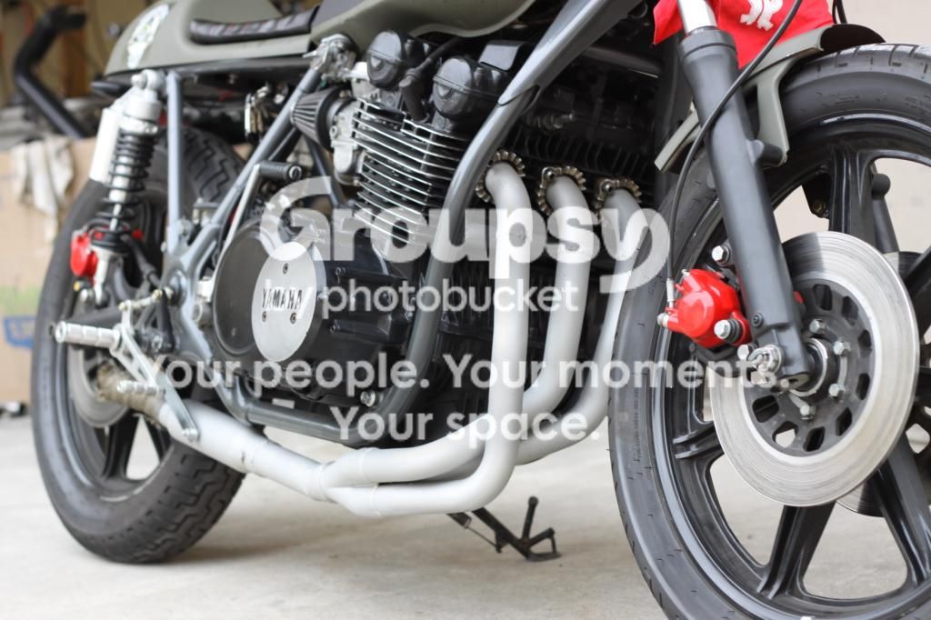

Triumph Daytona header I welded onto the stock flanges.

Man,
I really like this bike..... You knocked it out of the park. Very clean, yet still has attitude. The green works well.
looks really good! I love seeing other Triple projects! mine is not nearly as complete as yours! I kinda slapped mine together on a low budget, and am going to slowly start powder coating things as I go. I have a 77 also and love seeing other D/2D's

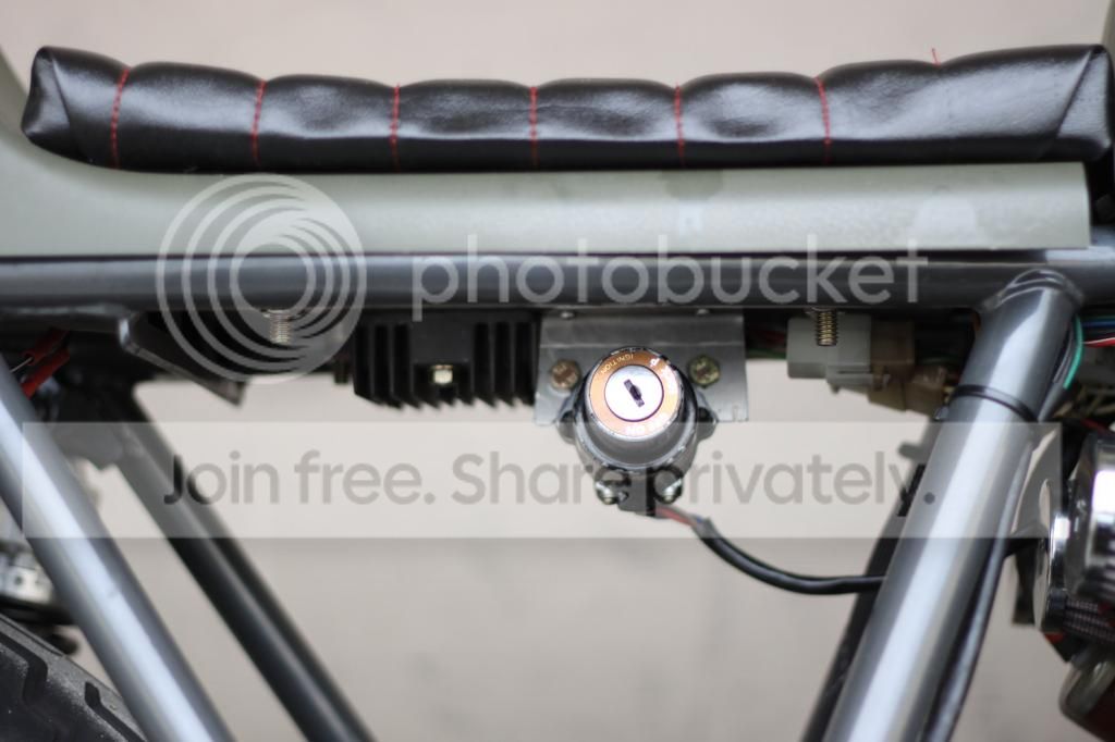

Where did you relocate your Ignition switch to?

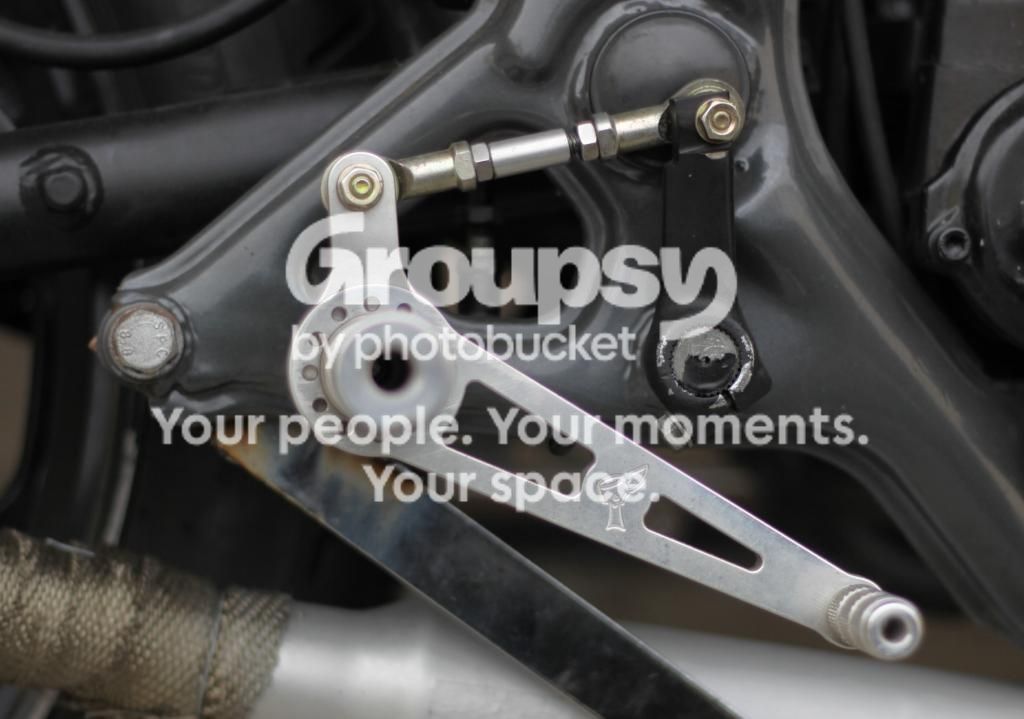

What rear sets did you mount on it? and can you take a few more up close pics?

The ignition switch is mounted to the metal plate under the seat. Still have to finish wrapping the wires and tucking them.
The rear-sets are from DCC http://www.dimecitycycles.com/vintage-cafe-racer-caferacer-custom-motorcycle-chassis-transmission-shifter-parts-dcc-originals-fully-indexable-aluminum-rearsets-rear-sets-dcc-rs10.html

off hand do you remember what size/type/length shocks our bikes run? I would like to pick up similar style to what you are running

Off the top of my head it's something like 320mm length with 12 or 14mm eyelets. These shocks have worked for me pretty well, but my rear tire is rubbing on my rear hoop on big bumps so I'm going to go with longer progressive shocks 14"- 14.25" range. But first I'm going to throw the stock shocks back on to have a comparison, I never rode with the stockers.

coming along nicely! gauge looks awesome on it, really like digital on old bikes. what are you running for a master cyl on front brakes?
Thank you
It's the Universal Nissin one from DCC 14mm piston.

I got a new reverse cone muffler from Cone Engineering, the shorty 12" SS one. Also wrapped the header today too.

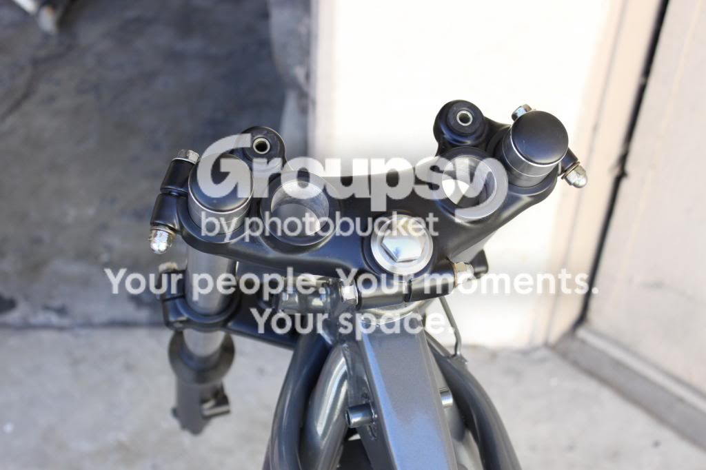

I didn't like my clip-ons too much anymore either so I ditched them for some Woodcrafts.
