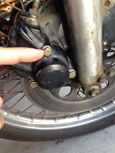

when i got the bike, the front brake lever squeezed, but had almost no impact. basically none. so i opened what i thought was the brake mechanism housing. (not sure if this whole assembly is considered the caliper). 3 bolts as seen in this photo:
everything looks to be present, and sort of functioning. (with bolts removed, the brake lever pulls cable, against spring, and seems to compress a few greasy washer type discs, as well as the white plastic end piece. i notice that when a bit of pressure is put on the white plastic piece, its teeth/gears pull on a thin metal washer with angled arms, then upon release it slides over these teeth, a ratcheting motion.)
the problem is that with the casing off and no pressure on the white plastic end (and the whole assembly) there's healthy brake lever movement, but no braking action. when the casing is closed and three bolts are tightened any reasonable amount, the brake lever is fixed, and the brake is locked.
i tried adjusting the disc side of the cable with these two hex bolts/nuts, but it didn't seem to make much difference in either unlocking the brake, nor inducing braking action. two hex bolts in question:
unfortunately, the lever end of the brake cable has no adjustable parts.
also, my manual doesn't include the disc brake so i can't reference that.
seems like its all there, i just need a better understanding of why closing this casing would lock the brake, and why it wasn't doing that originally.
thanks for any input!
methinks i see the problem, the big black thingy is indeed the caliper and those 3 big bolts should be done up quite tight indeed (in the absence of a torque wrench or the actual torque settings we'll settle for one and a half grunts....). i'm assuming you have already lubed the cable and pivot points at both lever and caliper ends
it will help if you can set the bike up with the front wheel off the ground to do the adjustment
those two hex heads are the adjustment system, loosen the lower one (called the lock nut) off and wind it all the way up the threaded bolt (the adjuster), then wind the adjuster back into the caliper all the way. this should give you back movement at the lever but probably too much and also no actual braking
now wind the adjuster back out of the caliper and keep spinning the wheel every couple of turns of the adjuster, you'll feel the wheel starting to drag at some point, at that point screw the adjuster back into the caliper a turn or so then wind the lock nut back down the adjuster til it hits the caliper, give it a light nip up with a spanner (i think you might know it as a wrench)
if all has gone well you should still be able to spin the wheel, have a little bit of slack at the lever and when you pull the lever it should stop the wheel spinning. now try it with the bike back on the ground while wheeling it back and forward in the yard/garage/driveway with you sitting on it.
if all is well its time for a test ride, take it easy and slow and see how it feels, it may need a touch more or less adjustment, take the spanners with you
after typing all that lot i found these two youtubevids which are about a CB200 but it appears to be exactly the same caliper as you have so i hope they help

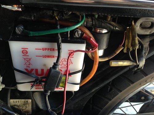

didn't get a chance to mess with the front brake, but i did replace the rectifier. (whether or not it was the problem)
charged the battery to 6.1v
rewired the rectifier using the wire color guide from a cb/cl 450(?) thread
crossed fingers
started bike on third kick
rode around!
got over zealous, fishtailed a bit when i remembered that going is good, stopping, not so much.
measured voltage @ battery terminals of 7.3-8v depending on if headlight or signals were on or not. figured that was pretty good.
bike off. measured 6.3v
not great, but seems to indicate that my 2 miles around the block means (i think) that the system is charging the battery.
will update next time i'm at the garage if the battery held its charge or not.

opened up the front brake after reviewing the videos spotty posted.
i think last time i opened them up, i may have clicked the racheting mechanism over a few times, thereby pushing the center (advancing?) screw out a bit, making the brake think that the brake pad was further worn than it was. so when i tightened down the housing, that was enough pressure to apply braking force to the disc. cleaned up the system a bit, backed out the center screw, added some aluminum based grease, and closed it back up. initially i got no braking force, but as i adjusted the adjustment nut on the brake cable, i got my braking back. its certainly not great (could've probably went another turn or two), but it'll slow the bike down. the lever doesn't really spring back, i assume that's from the spring being fatigued.
bike started, and now stops a bit better. another good day.

next on the list is more brake tweaking, cleaning (just a wipe down/spray down), and taking a look at the funky wiring (there is a blade style automotive fuse hanging from a random splice near battery world... interesting.
thanks!
here is a random picture that makes the bike look a little cleaner than it is. missing the side cover. and the foot pegs seem to be angled upward more than they should be.
this is part of the wiring mess i will deal with eventually.
glad i was able to help with the brakes, you're on your own with the electrickery though....
seriously though, there'll be someone hereabouts with the knowledge to get you started, just try and find a wiring diagram before you start asking, see what doesn't look right on the bike and compare it with what should be there according to the diagram - if you can't work it out, then ask questions
