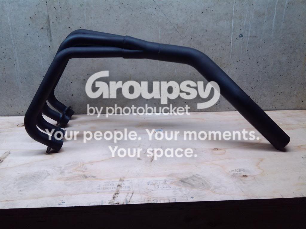

Going from spokes to Comstars sounded easy but it has been a chore. With the cost and hassle of new spokes I am still money ahead though. I bought a set of Carpy headers and a chain conversion set yesterday, pictures to follow as I know that's the fun..
downtown809 said:
Carpy header, bare as I am a cheap shit. I figure I can wrap this one for less than ceramic.
I'm thinking you might want to coat that with some high heat paint just to keep it from rusting under the wrap. I dig that exhaust a lot, it interfered with the rear set on my project though.
