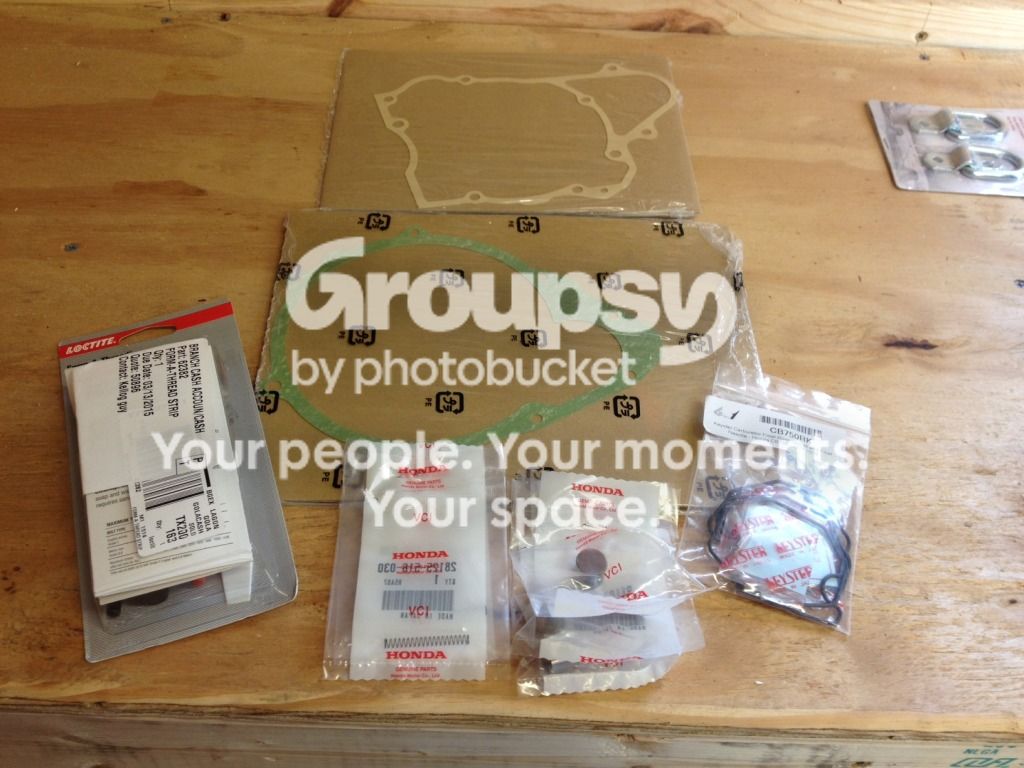

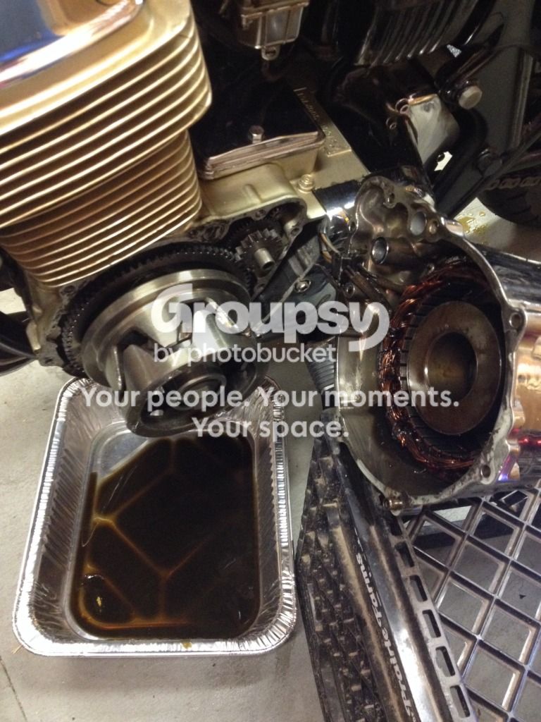

Fixed the noisy starter sprag. It had been getting progressively worse and I'd had enough. Pulled it apart and found this...
PO neglected to put all the rollers back in ::)
Three new rollers and three new springs later, she works like new.
I also developed a leaky carb. Which I initially contributed to bad bowl gaskets. After changing them and the float needles, I discovered the leak was coming from the 2-3 crossover tube. Sooooo, pull the rack again and change the O-rings on the crossovers.
I also took this opportunity to change the main jets. I bought the carbs off ebay and couldn't confirm the size of the jets in them. So I ordered the correct size #110's and installed them. Now I know they're the correct size.
The #4 carb had a stripped bolt hole that got a helical insert as well.
(I tried using Loctite Form-a-Thread on it first. That stuff sucks. You can read my review in the Product Review section)

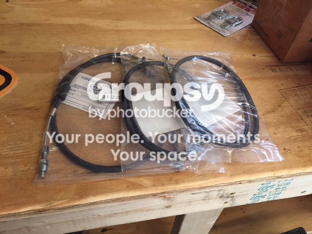

She got new cables...

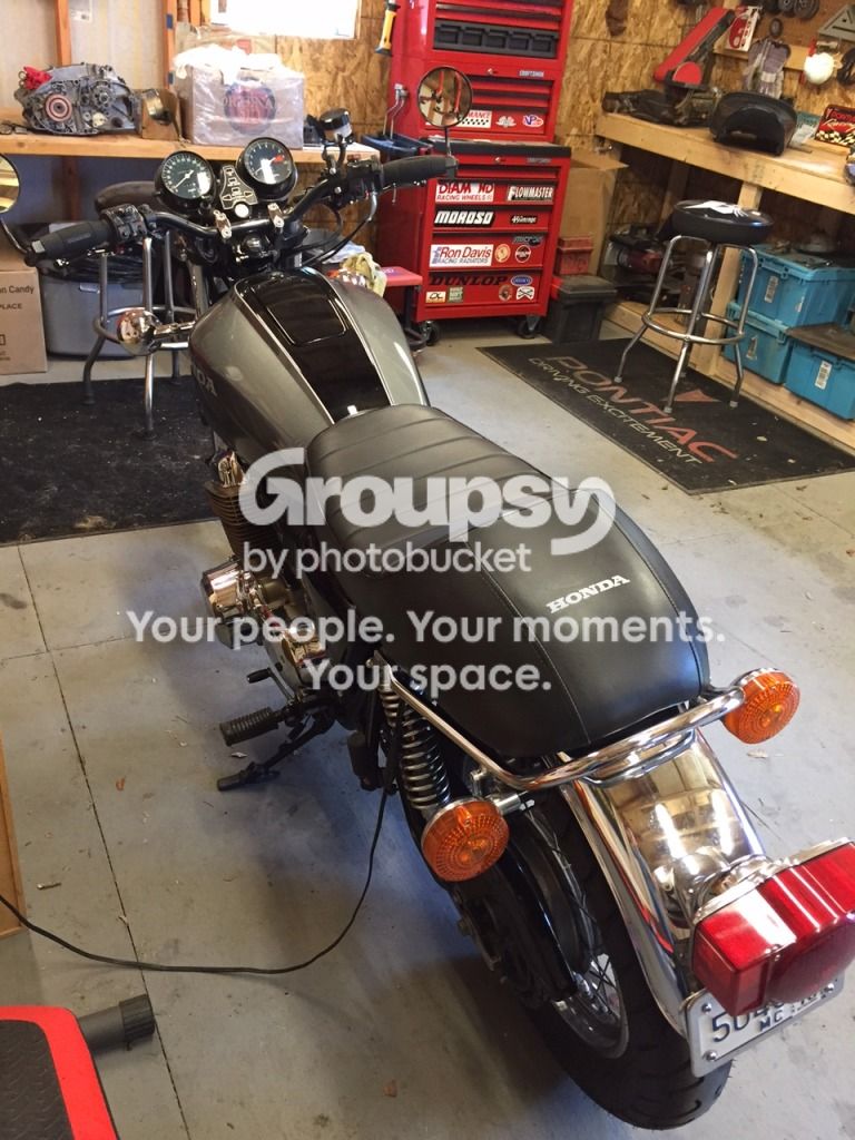

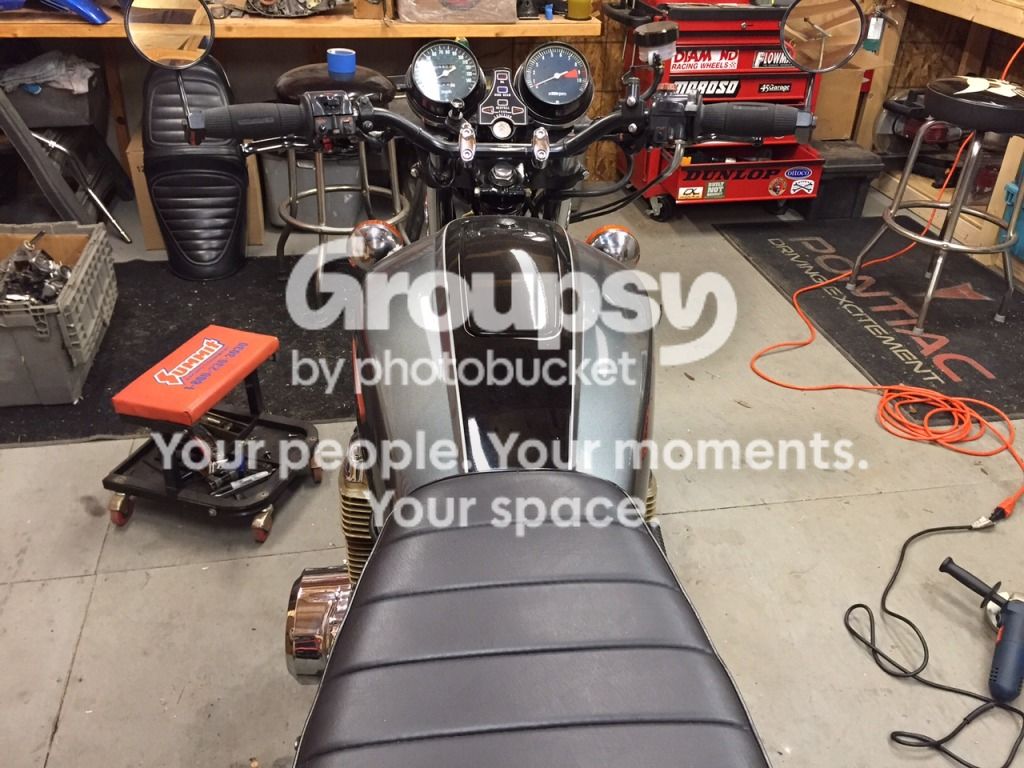

Picked up a new seat:
Gives it a sportier look while retaining an OEM feel to it.

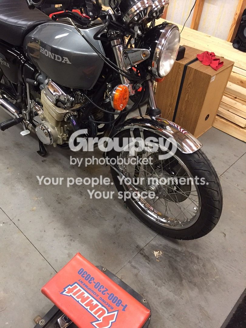

I also tucked in the front signals 1.5" to match the previously done rears:
They barely extend past the tank now. Much better looking without the outriggers.

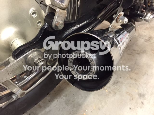

Mac/Kerker hybrid megaphone
I took an old beat up Kerker megaphone muffler, gutted it, and stuffed it into the Mac megaphone already on the bike.
Now I say "gutted" the Kerker, but really all I was able to salvage from it was the endcap. The baffle was welded into the shell, and trying to remove the rusty mess of it was doing no good. So I purchased a length of stainless baffle off eBay instead. I then removed the end pieces from the Mac baffle and fitted them to the new baffle tube. I trimmed the outer Mac cap to fit inside the casing, and is being used as a retainer to keep the packing material from blowing/falling out of the holes around the perimeter of the Kerker endcap.
Mac baffle before chop...
Mock up of new baffle...
Final assembly of new baffle...
Refurbished Kerker endcap...
(fresh paint and some 1000grit paper over the tip)
And final assembly, with new nameplate installed...
A Decibel Meter app has it at approx 80db at idle, and approx 100db at 7k rpm.
I didn't think to get a reading on the Mac baffle before I tore into it. But Id say the (straight through) Hybrid is no louder than the original Mac.

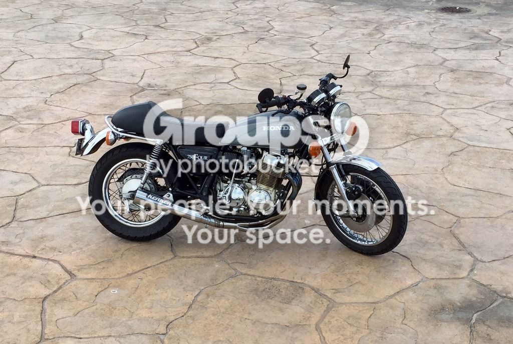

Totally digging that exhaust. I've said it before, I'll say it again: this is one of the cleanest 750s I've ever seen.

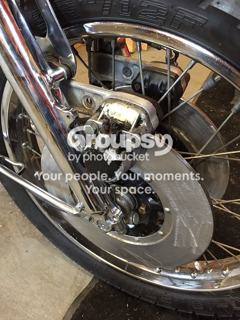

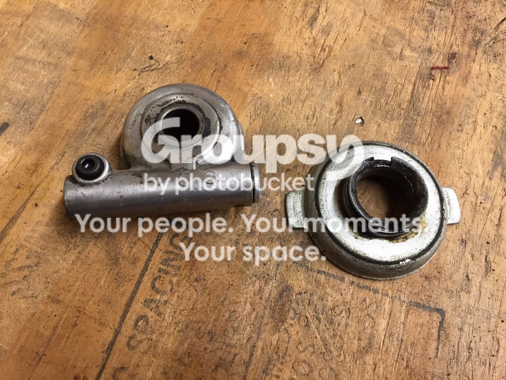

Latest upgrade... Dual Disc conversion.
This is pretty straight forward as explained in this thread... http://www.dotheton.com/forum/index.php?topic=1525.msg11304#msg11304.
The only snags involved were:

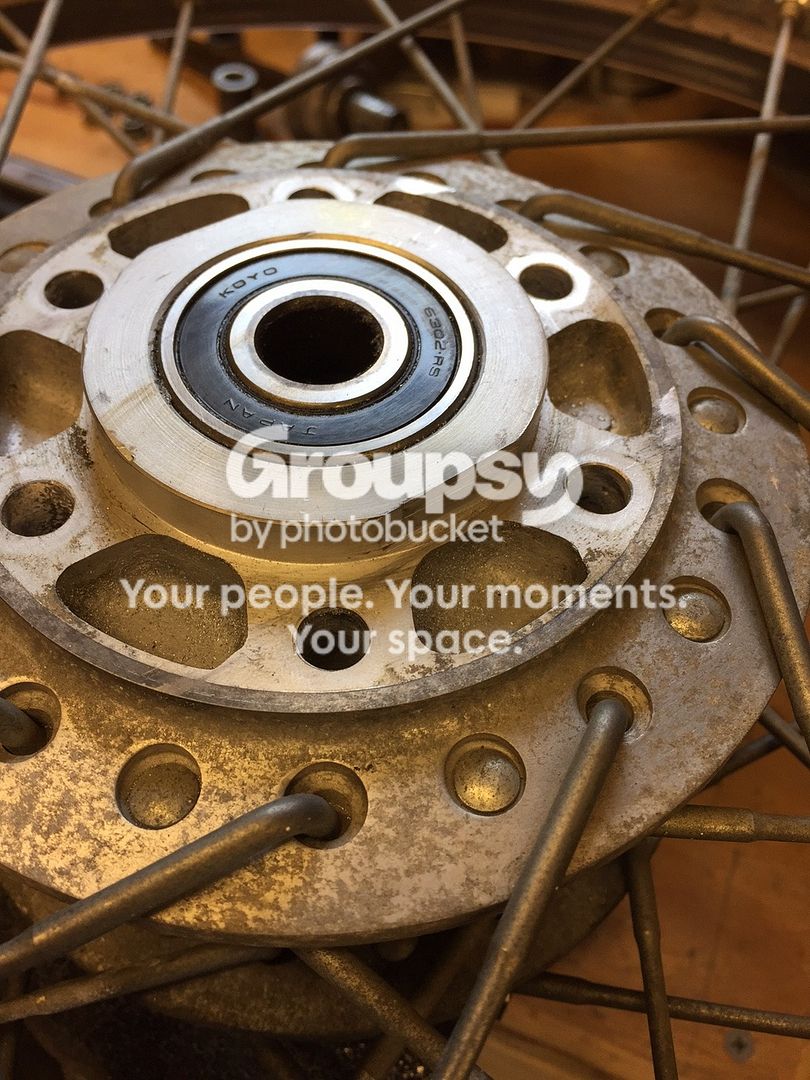

A) The first pic in the Anubiscycle article shows an incorrect "part required". It shows the speedo drive on the left...
What is actually "required" is the drive plate on the right. And even then, you may not really need it all. I didn't, as I modified my existing plate to work.
B) The speedo cable retaining bolt (in the speedo hub) may need to be shortened. Mine stuck out the back of the hub enough to interfere with the bolts holding the discs to the wheel hub.
The following pics show much of the conversion.

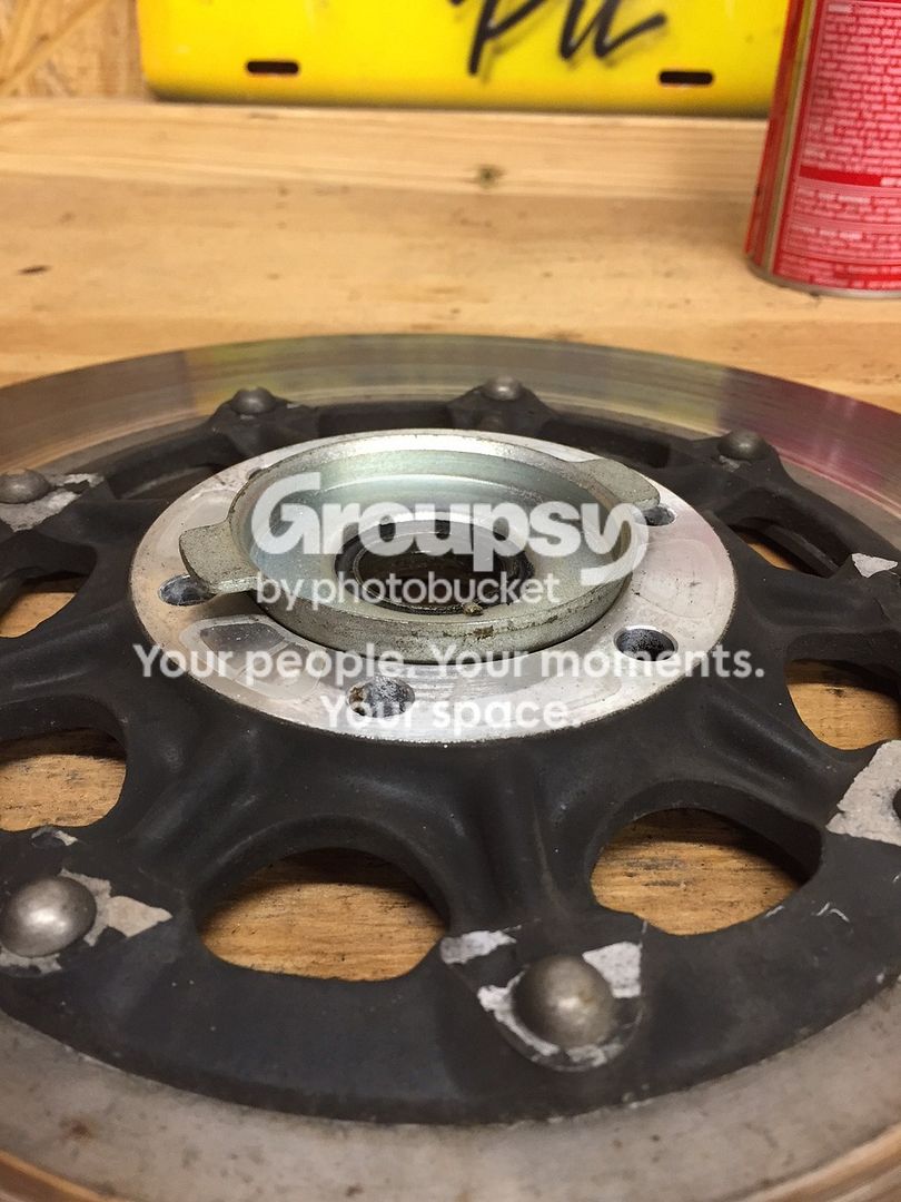

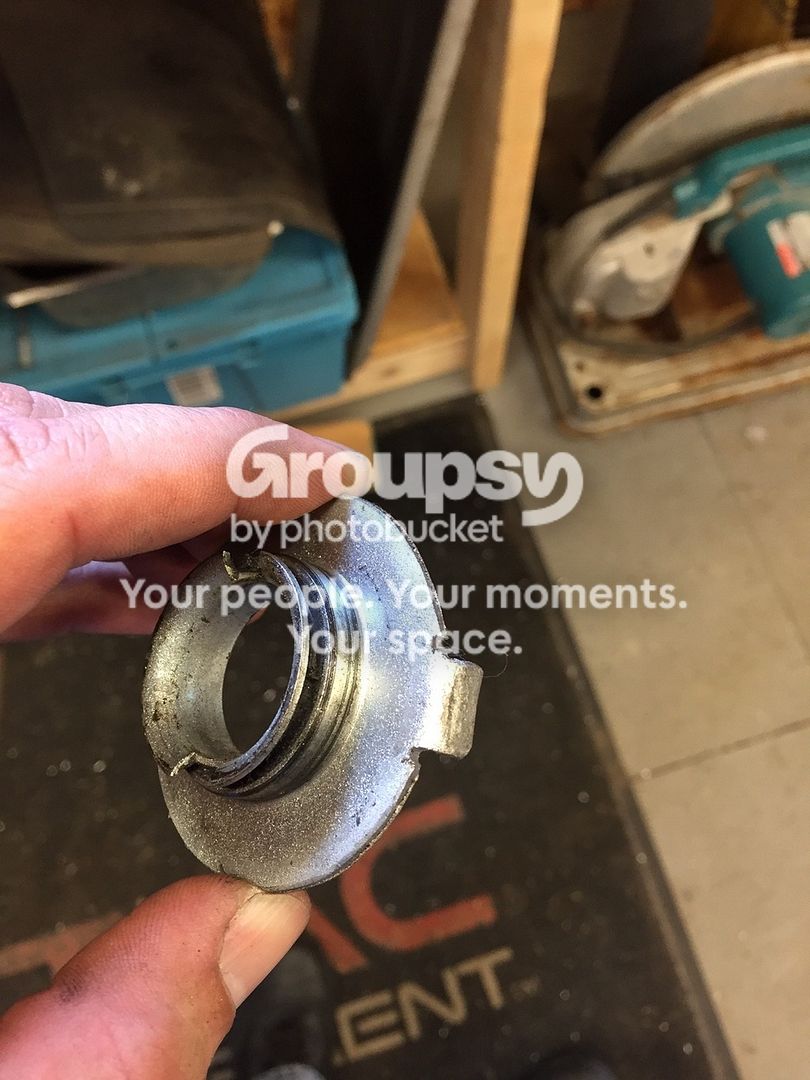

This is why the drive plate has to be modified...
The plate is too large to fit into the rotor, and the rotor fits perfectly to the wheel hub.
My solution was to cut down the drive plate to fit inside the rotor, while leaving two tabs protruding (similar to oem), and file two flats into the wheel hub to accommodate the tabs.

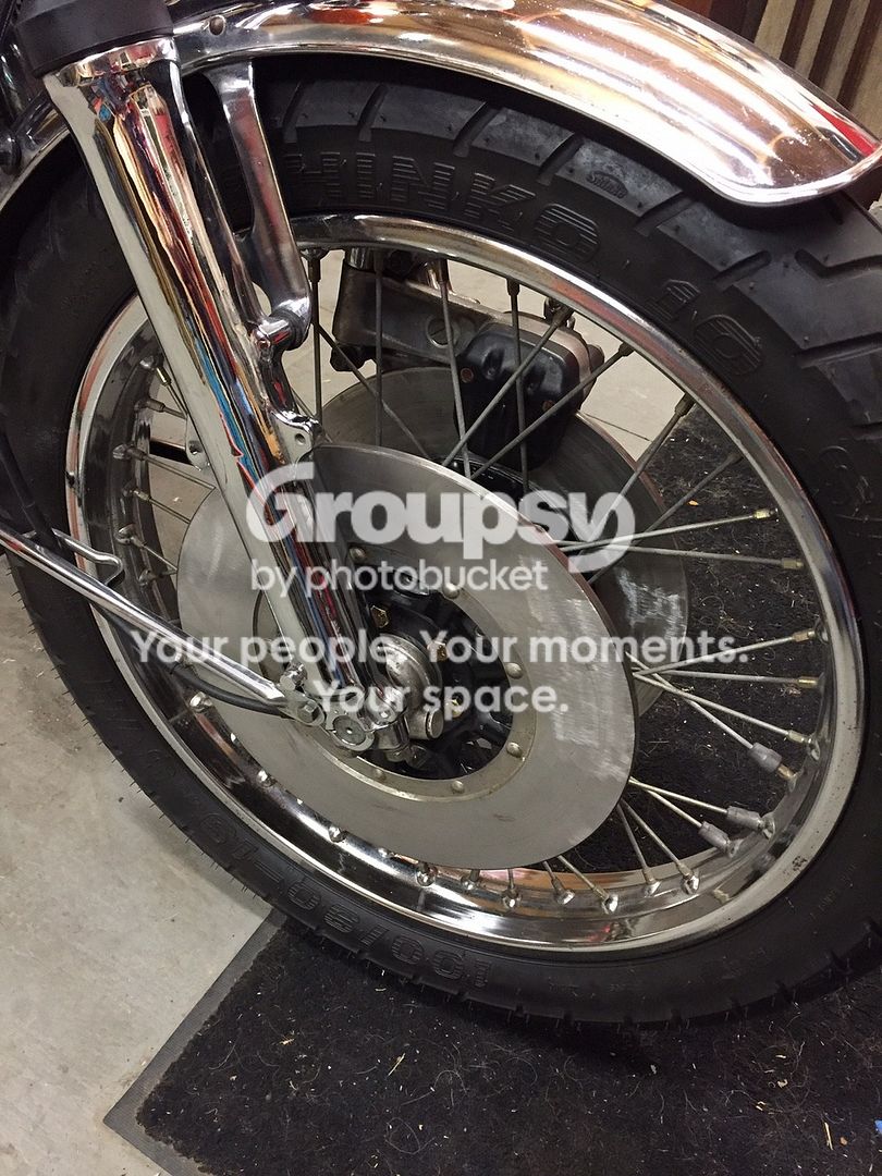

Dual discs mounted, modified drive plate installed, everything reinstalled on the bike.

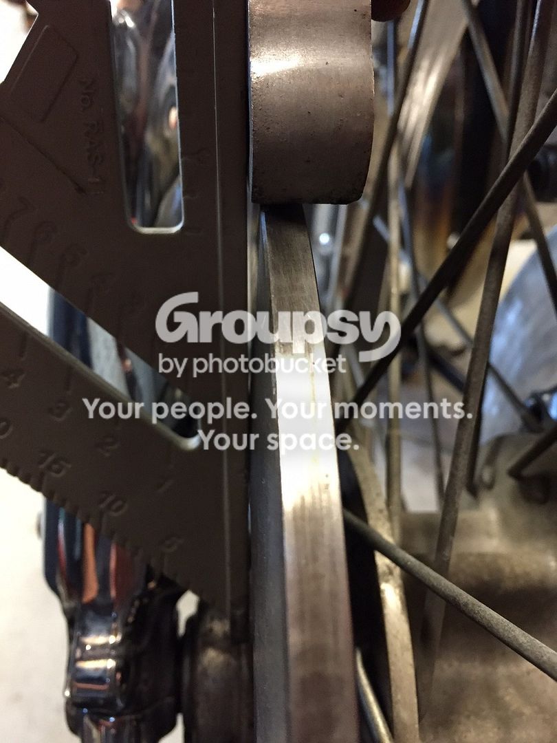

As stated in the article, trueing the caliper bracket to the disc is imperative. And will require filing and shims.
No Bueno...
Muy Bueno...
All trued up and mocked up.
Final fitment with braided lines installed.
I used a GSXR750 master cylinder (and matching clutch perch) because I like the look of the adjustable shorty levers.
And lastly, out and about, bedding in the new brake pads.
Thanks :)
I should also point out... while it's not a very difficult upgrade, it is somewhat involved. Especially when it comes to trueing up the caliper bracket. This is tedious and time consuming, with the fitting/removing/filing/repeat, and took the most time of the project. What wasn't shown was the rebuilding of the calipers, and the small things that pop up unexpected, like the bracket I had to fab up to mount the remote reservoir. If you have gathered all the parts needed ahead of time (I did not), this can be done in a day, maybe two. And it's well worth the effort. Braking performance is dramatically improved.
