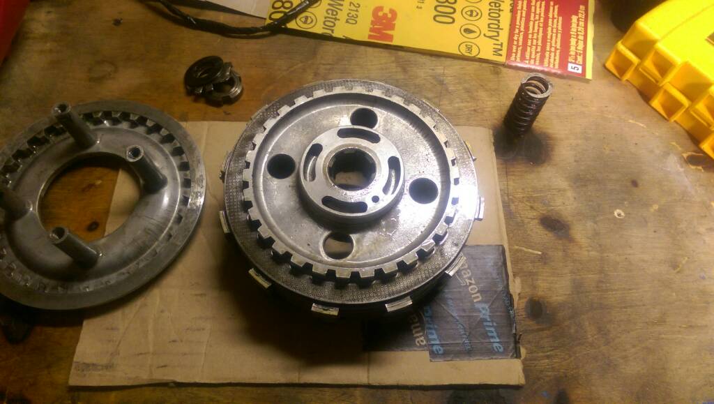

Ok i got two pics of the clutch cover and lifter plate. Does it look too deep? I am taking it off now

Holy shit. Just noticed something.... so is the lifter plate only able to go on one way? I jusy noticed that the holes dont line up
Sent from my HTC6525LVW using Tapatalk
Nevermind..... it was just loose from where i took it off

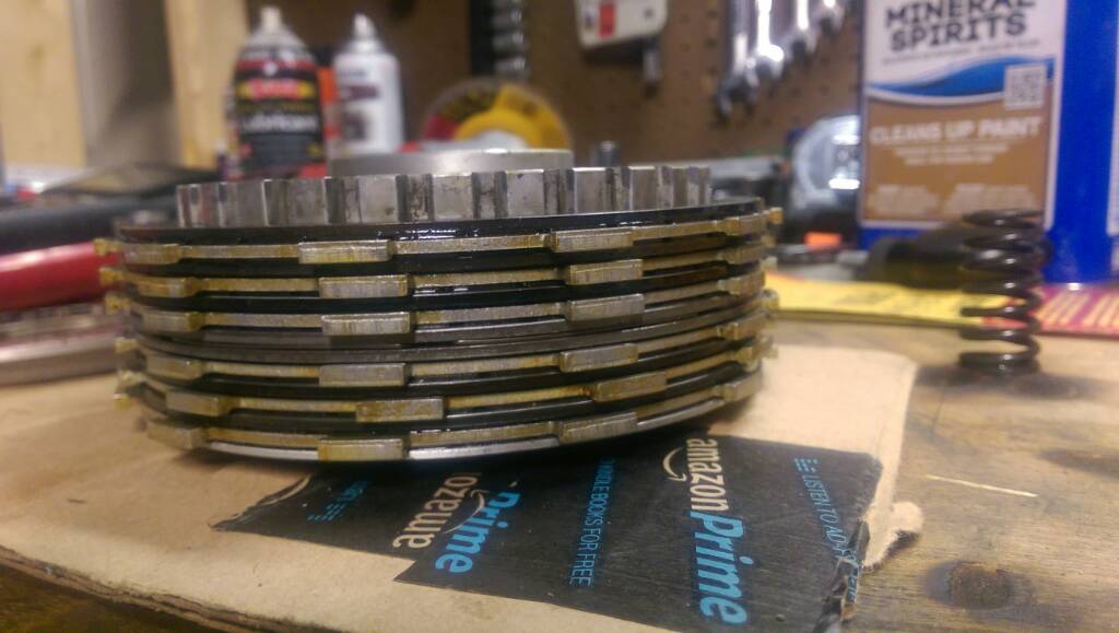

This is correct. I had removed it. I have some more pics here. Took the clutch pack out and measured. Plates are 3.5mm
As you can see in the pic, i only have 6 in. It came with seven. Also, i have . Set of springs i bought which are significantly smaller than stock. What gives there?

The springs are likely the problem, those heavy springs suck unless your drag racing the pull is hand numbing.
7 friction and 6 drive (steel) start and end with friction, put it together with tha cable off and adjust until the screw is out further than the nut a ways when all done the cable/lever should have 1/8th" of play

So which one are the drag springs? The small ones?
Yeah those short springs if you look are a thicker coil and take less rate to provide pressure cant remembe stock spring rate but the tall ones are comparable to stock... not the best thing but check to see they are all the same height with a caliper
Yes. They are all 39.8. Putting the clitch pack in now. Step daughters asleep so ill provide an update tomorrow. Thanks!
