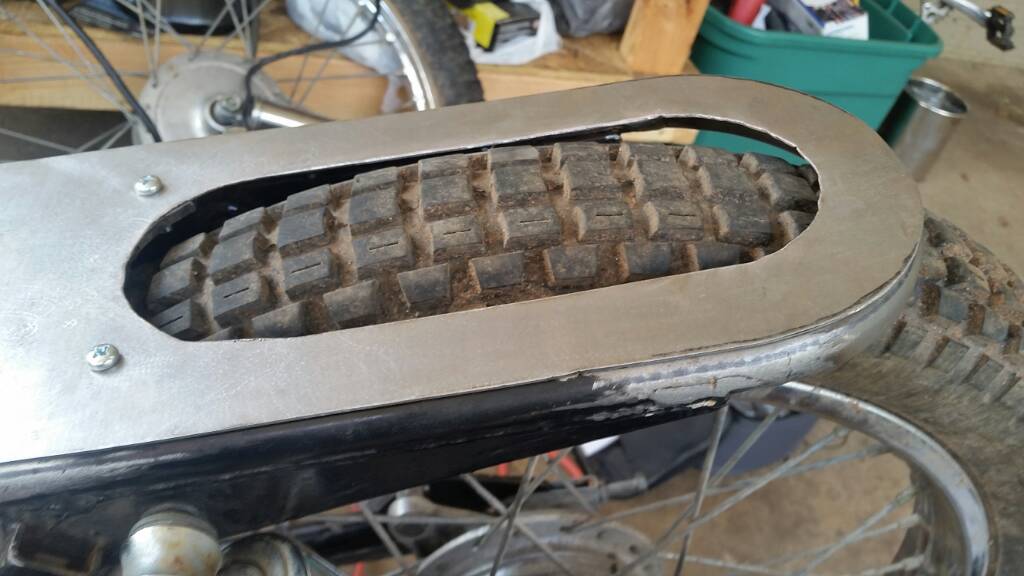

Tune-A-Fish said:
I think you only need 4" plus a little, find the sweet spot in the pan where the tire hits and cut an oval shape, find an old fender that fits the shape and cut it with some tabs to rivet it to the pan tight from the bottom, then build the foam to just over top with a good closed cell layer and yer done.
I've taken your advice and I'm cutting in to the pan. So from no load to scraping the frame I have 3.7 inches of travel for the shocks. I'll have to do some more research but if that isn't enough I'll have to extent the seat loop out another inch and cut off the crossbar and move it forward an inch.
Sent from my SM-G900V using Tapatalk
Put one shock on and ratchet strap it down to the shock stop, this will give you the bottom out and if you can get a little more up to an inch would be perfect. You can add to the stop, but not optimal an any way for your lower lumbar.
Cut the seat pan.

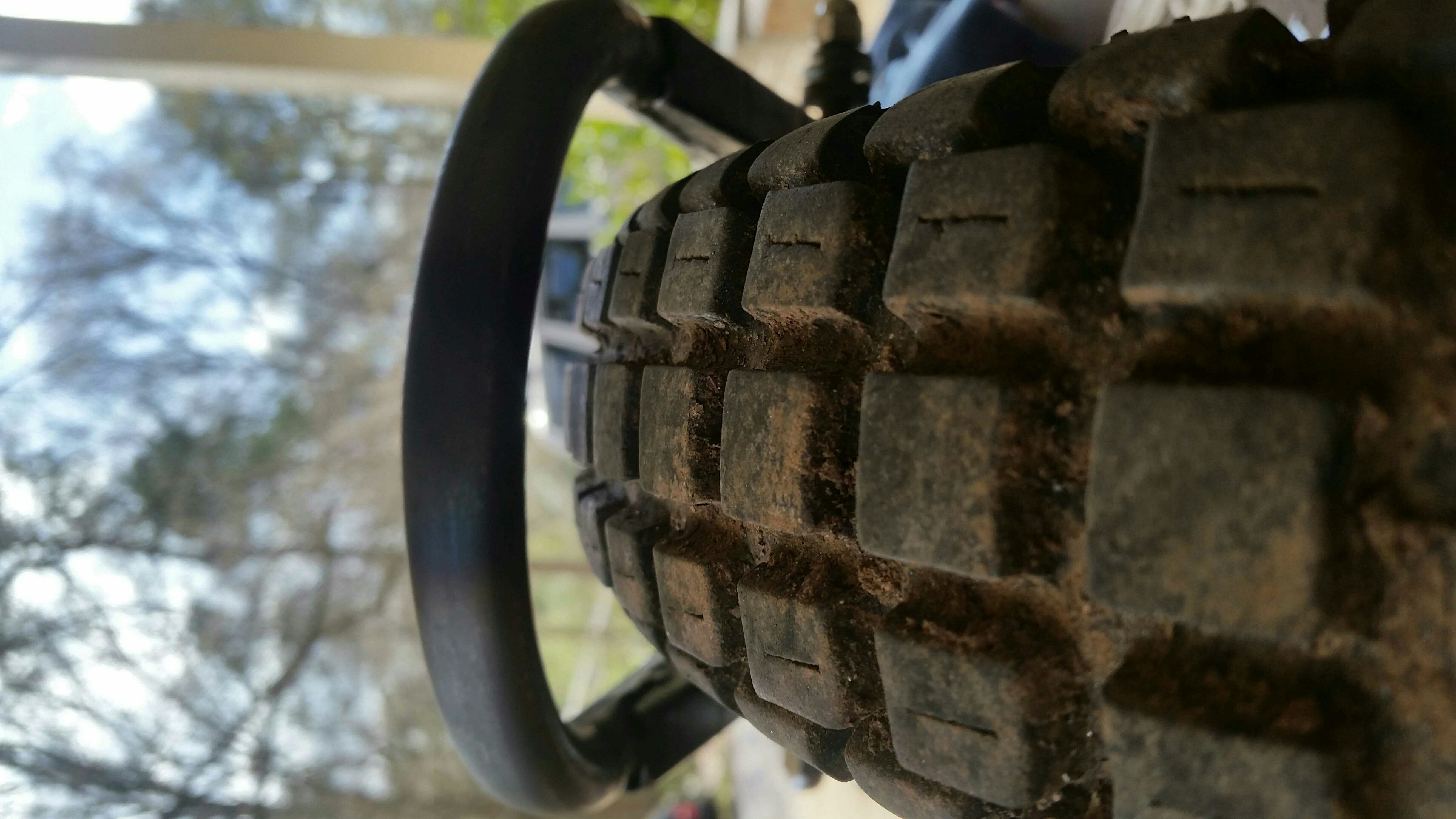

Here's as low as it will go.
The tire just barely peaks over the bar.
Nice! the buble can be an inch and a half maybe only 6-8 " long X the tire plus a half each side maybe.
