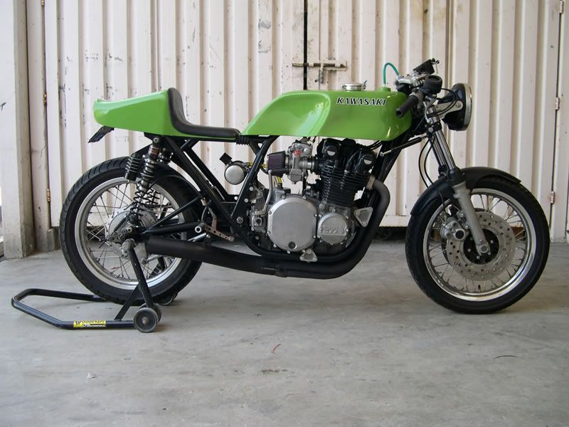

Is the attached pic your machine? I'm thinking of doing a very similar color scheme.
I keep going back and forth. the wife wants kawi green, but I don't know, I just can't get it to grow on me. It's very cool, but I can't get there yet. If I do, I think mine will be like the h2r, with wide white stripe and to small ones down the middle.
We'll see.
j
Thats a cool bike but its not mine I saw it on ebay a while back. just looks good. nice and light. I'm wanting to do mine in some sort of green with white racing stripes dowm the center and the number 1 on the tail
Beater - funny what you said about the wife - my wife also favors kawi green. I'm thinking of adding a goldish yellow and white. But that h2r is always an option. Good looking machine.
