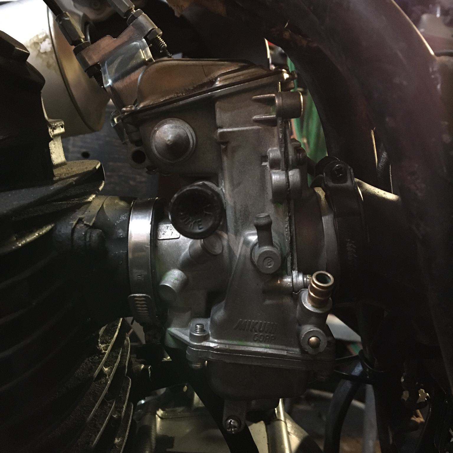

Just barely. I had to drill a couple holes forward of the stock air box mount on the frame, but it’s just enough to fit...

I love Mikuni TM carbs. Looks like it should fit the bill.
I got a good deal on a 37mm FCR. I'm having a helluva time getting this thing to work. I think it may just be too small. I can't get it out of high idle and backfire, and I'm nearly maxed out on richness for the pilot jet. Even with the slide completely closed, it acts lean. There's more to look at, but this TM is starting to be questionable. I've checked for vacuum leaks and whatnot, so it's pretty much narrowed to the carb. An old 1980 pressing of the Clymer for the SP/DR370 & 400 singles recommends a VM36 as a performance upgrade. Hopefully this FCR will do better.
It's possible. Even likely. I have another slide from another, proven functional TM.
Cutaway is usually tiny on those for a 400. Probably around 3~4mm How much wear is on slide and body?That could be where you have air leak? I've really only worked on RMZ 250/400's though and can't remember all the problems without having carb in my hands. I know there are a few simple things that can be wrong causing high idle. Wear plates fitted backwards or upside down is always an issue
For the sake of transparency, let's begin today's post with some failure. I stayed up 'til about 5am last night fabricating a spigot for this FCR-MX carb I want to run...
Everything was looking good. Got good transition to the head. Good fit between the carb and the intake. The Rotax boot was a good fit, too. I was proud.
Then, I go to install the carb in the frame and lo and behold, the throttle mechanism interferes with the frame. Damn. So, back to the computer and I order a boot from Jet's R Us that will be much shorter than what I have here. Hopefully, it fits inside of the frame being at least 10mm closer to the head.
