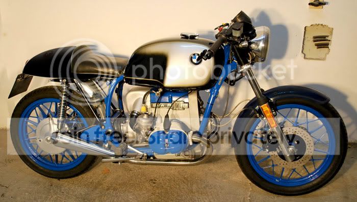

Soo, with the bike, I have been bad about posting updates, and much as progressed. It is not finished, as the tank, cowl, and fenders still need paint, and I need to make a new seat, but it is driveable. I have ridden it the last two nights, and gotten about 10 miles in so far.
So first a PHOTOSHOP request: Can someone make the cowl and the fender black, and extend the seat to the tank? I just need an idea, but my skills are very limited. I am also open to color suggestions.

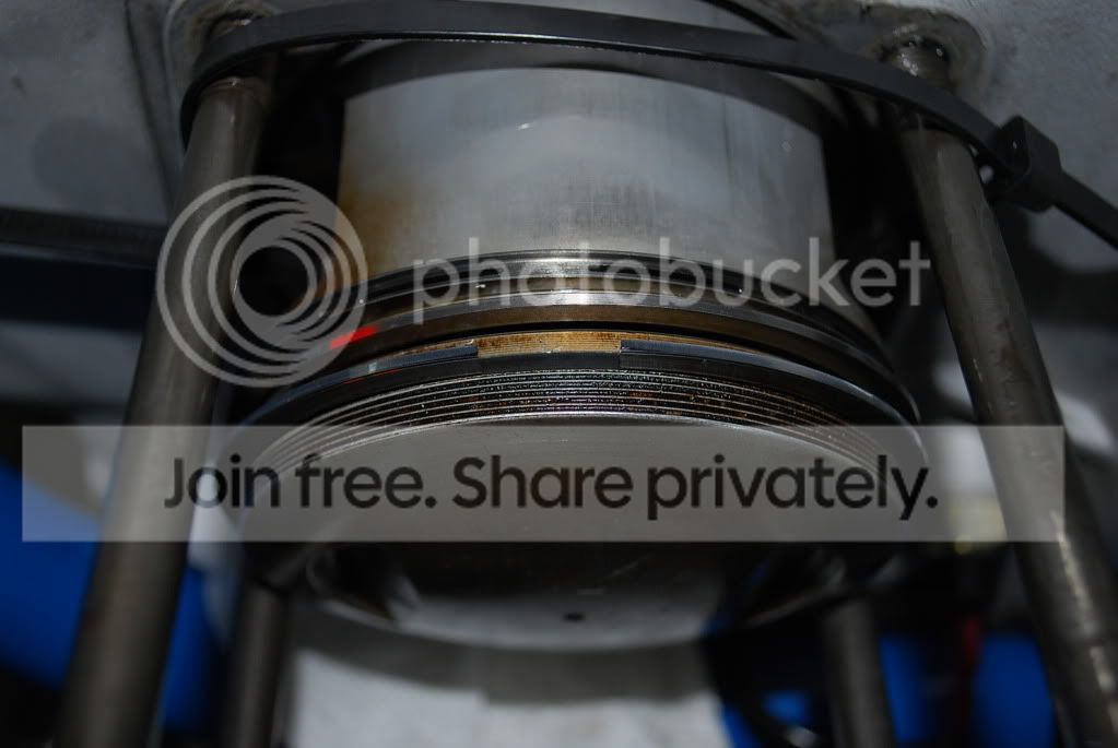

I got everything together last sunday, filled it all with fluids, then monday night started it up. I took a video of the first startup, but don't have it to post. Honestly, the video is embarrassing. It started fine, and ran okay, but it took me 20 seconds to realize that the left cylinder was smoking BADLY and filling the whole garage with smoke. :'( I was sitting on the bike dumb and happy, then looked behind me to see a white garage. I turned it off, and the next afternoon removed the cylinder. I found 2 of the 3 rings upside down, including the oil rings. I flipped them and reinstalled, then pulled the other cylinder to check the rings, and found the oil ring upside down also. With all rings in the correct orientation, I put it all back together. The new neutral switch was also leaking badly on the tranny, so I reinstalled the old one. Neither one works, but at least the old one doesn't leak.
Getting the pistons back in:
I had the engine guy install the rings and the pistons in to the cylinders, but I definitely learned two things: Check everything yourself, and installing piston rings is not that hard.
With everything back together, I started it up again Tuesday night. Smoke gone, tranny leak fixed.

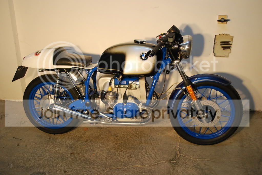

I am surprised, but I like the white tank and cowl. My current paint plans are silver sides(similiar to current, just add silver in to the knee cutouts), red pinstripe between the black and silver, and a single silver center stripe though the gas filler and cowl. Ofcourse I would put the same design theme on the cowl too. Sparky, can you take the first chop you made, fill in the knee cutouts with silver(inside the current gold pinstripe), and add a red line to frame the silver?
Here ya go. However, I'm digging the blue pinstripe :) Adding another color seems a little disconnected. Also, I think with this scheme you wouldn't need additional stripes on the top. The negative black space created from the side 'panels' will already give it that feel of a backbone stripe. Either way, hope this helps. Glad to hear you're already racking up the miles on it!
Sparky, you are on amazing photoshopper!!! Both of those look awesome. I like both the red and blue pinstripe. It will be a hard decision.
You are gifted with a designer's eye for sure. So, on the same theme, would the idea be a silver stripe surrounded by black on the front fender, with a pinstripe in between??
I dropped off the front engine cover at the powdercoater, they are making it blue also. None of the pictures I have posted have the front cover on, but it just didn't look right as natural aluminum. I was also worried about it being uncoated, as it seemed to pick up dirt and oil that was not coming off.
I like the black and silver combo with the blue pin-striping, but I would like to see the primary color (silver) in white as well.

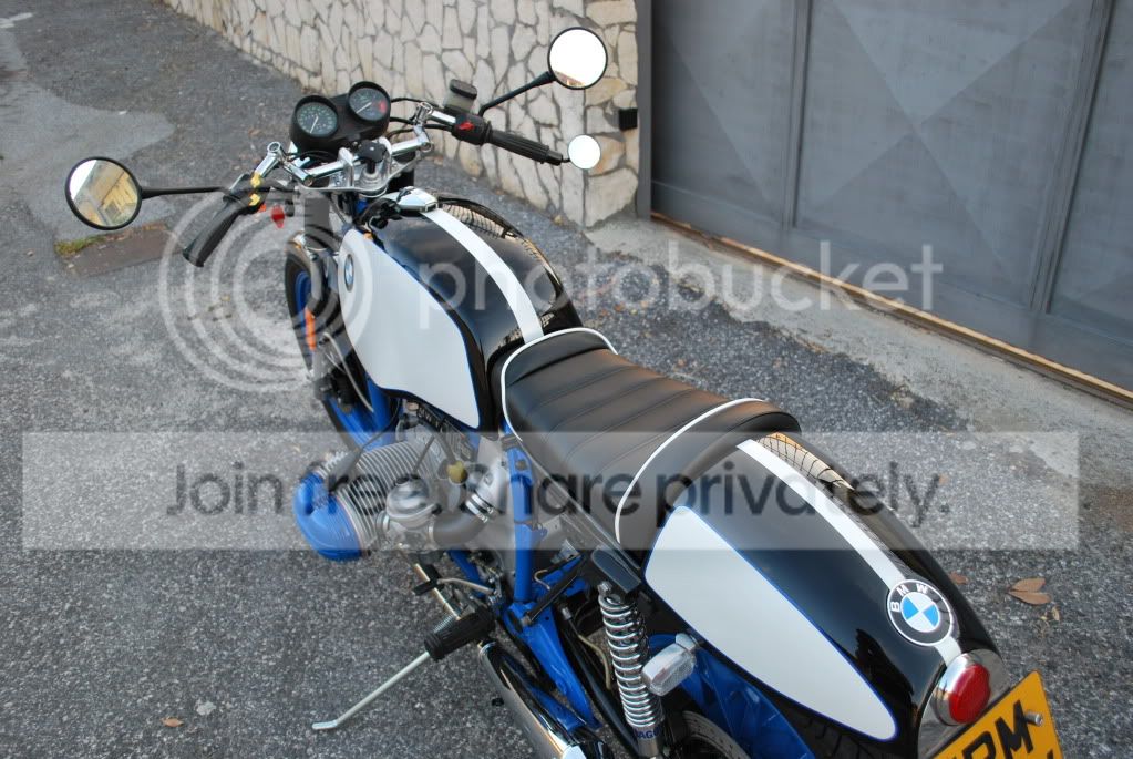

I have been very SLOW about getting work done. I drove the bike 30 miles up to my buddies place and left it there, so things are starting to get accomplished. I followed him around on monday afternoon to two upholstry places. The first was closed (despite calling right before we left), but the second was ready and willing. They made the seat out of foam while I stood there to ensure I like the design. We added a little bump in the front and talked about single/double stiching and white piping. It took them a couple days to cover it, then my friend brought it over so I could check it out. I haven't seen it on the bike yet, but it came out beautiful. I will let the pics do the talking. Paint is next, and getting a new front fender made. The seat cost 50 euros to have made + a new fiberglass seatpan from caferace.com.

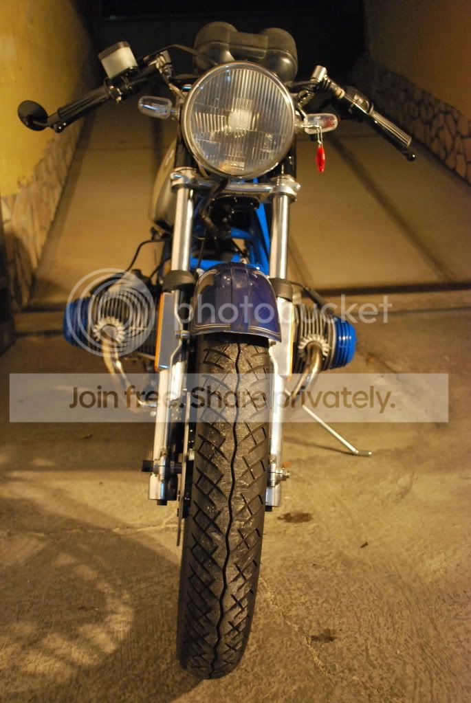

All parts are in my possession now. Just have to get her home and install the new seat for the bike to be finished. I started her up at my friend's place with the intention of driving it home, but decided another maiden 30 mile voyage at 9 pm wasn't a good idea.
Crappy iphone pic in the dark:

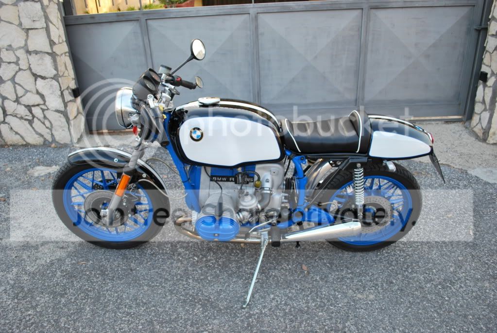

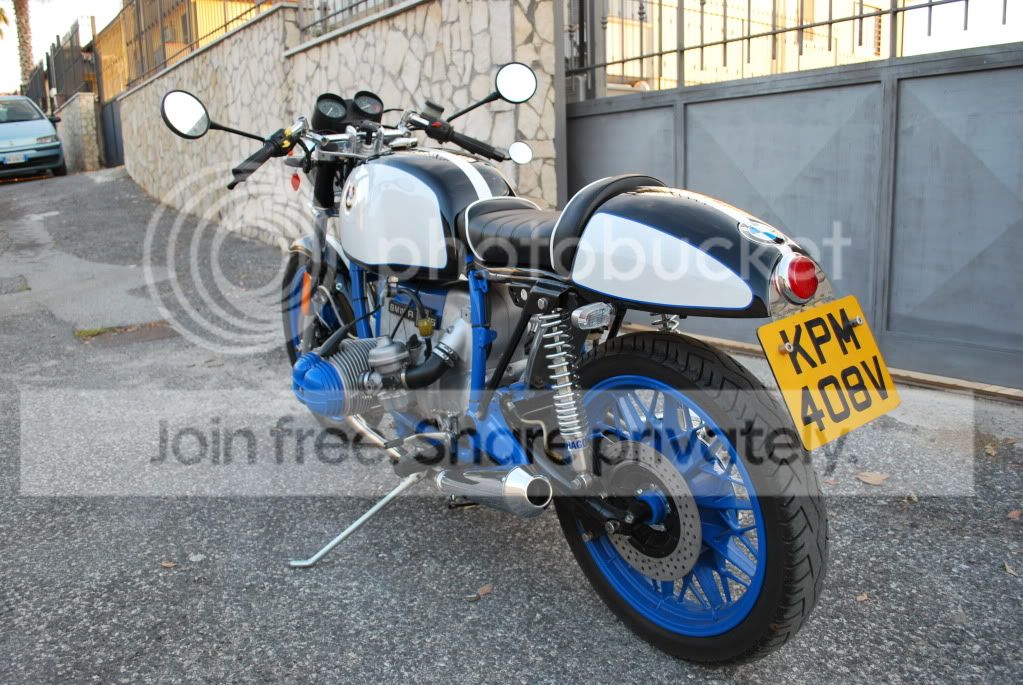

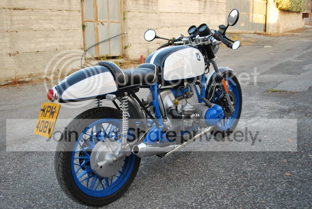

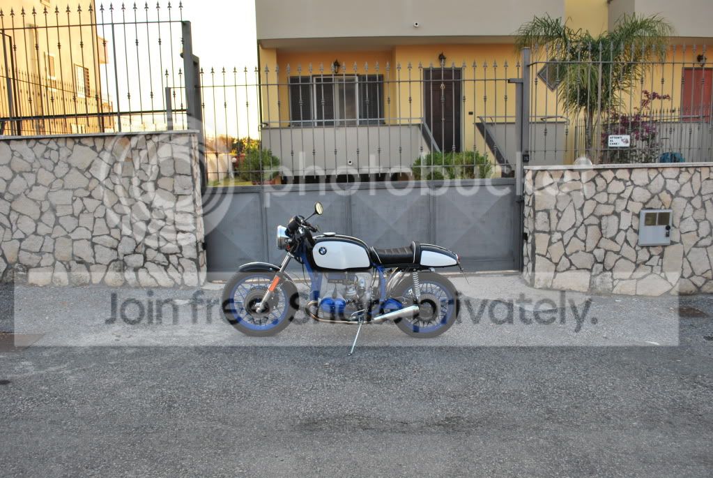

Finished!!
8 months and a couple hundred hours, the RS is finished. Ofcourse I have some parts to install, like new carb needles, but here she is with new paint, seat, and everything else:
That is just pure, leagues above the ebay auction, dig the color combo. Nice work!
How the fuck..Your exhaust! My god you did an amazing job on that..
The bike looks like one big BMW emblem..Sweet as
I wish I had the budget for a bmw build! Good work
Thank you for all the compliments!
It was never my intention to use all of the colors from the BMW badge, but it certainly looks like it. Adding the badges really finished off the bike though!
I did a 60 mile day on Tuesday with it, with no problems except running out of gas on main. It has been a while since I drove a bike with stop cocks and no fuel guage! Thank goodness for reserve!
