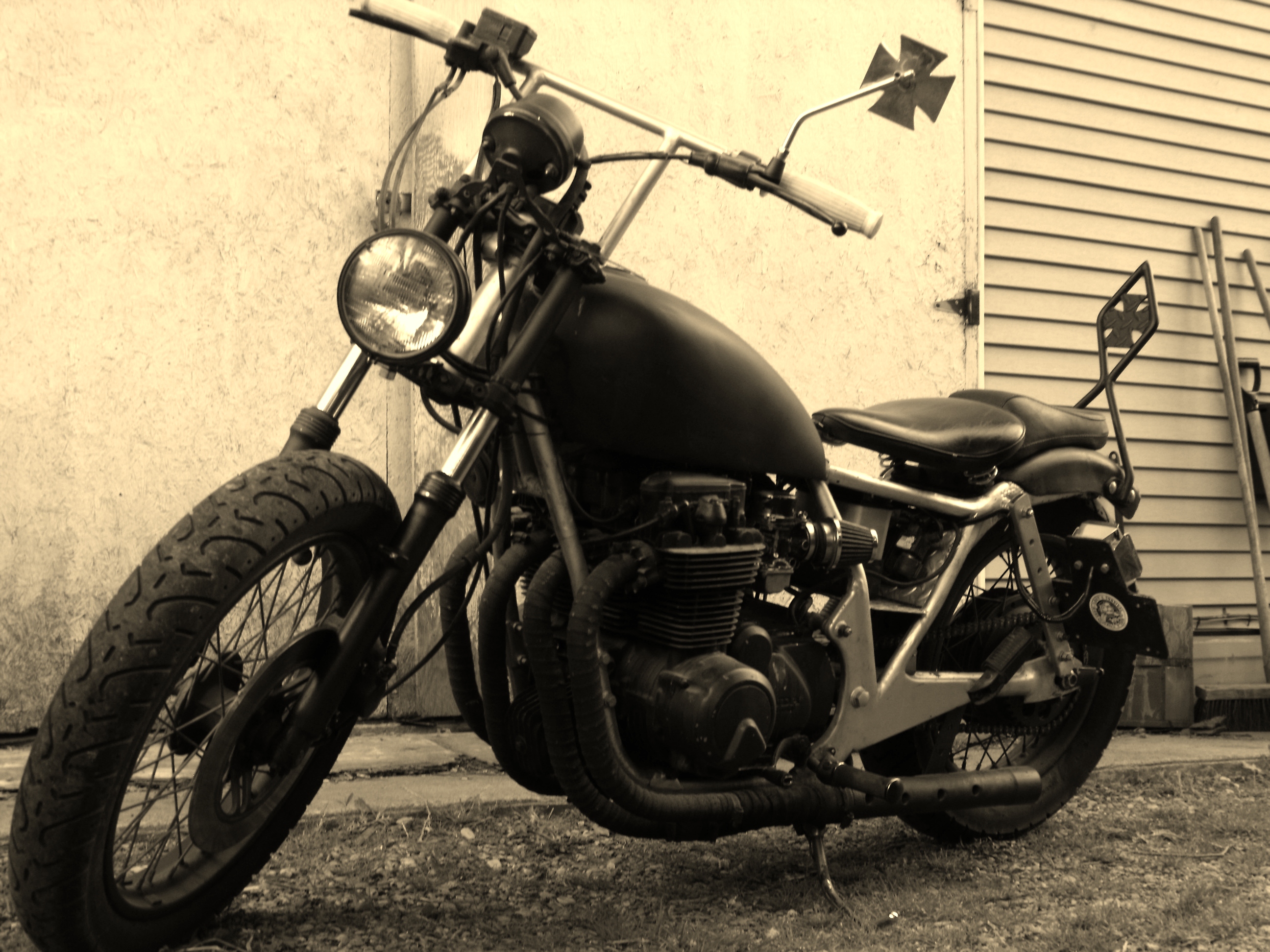

Looks like you"ve got a good start it! It's nice to see another CB650, They're very rare in my area. Everyone thinks it a 750. I just sold mine(with many tears :'() after 18 years of working on it. Here's a few pics of how it finally turned out.
That is a hot bike! If you miss yours, you can always buy mine when I'm done with it, muhahahah!
Thanks for the offer, but you know what they say, you can never go back! I'm now in the process of tearing apart a pristine '84 Goldwing Aspencade with all the bells and whistles. Not sure how far I can go, buts it's fun getting there! And it's just as much fun watching the looks of the Goldwing guys when they see it!! You know, Honda never offered the Goldwing in flat black?????
