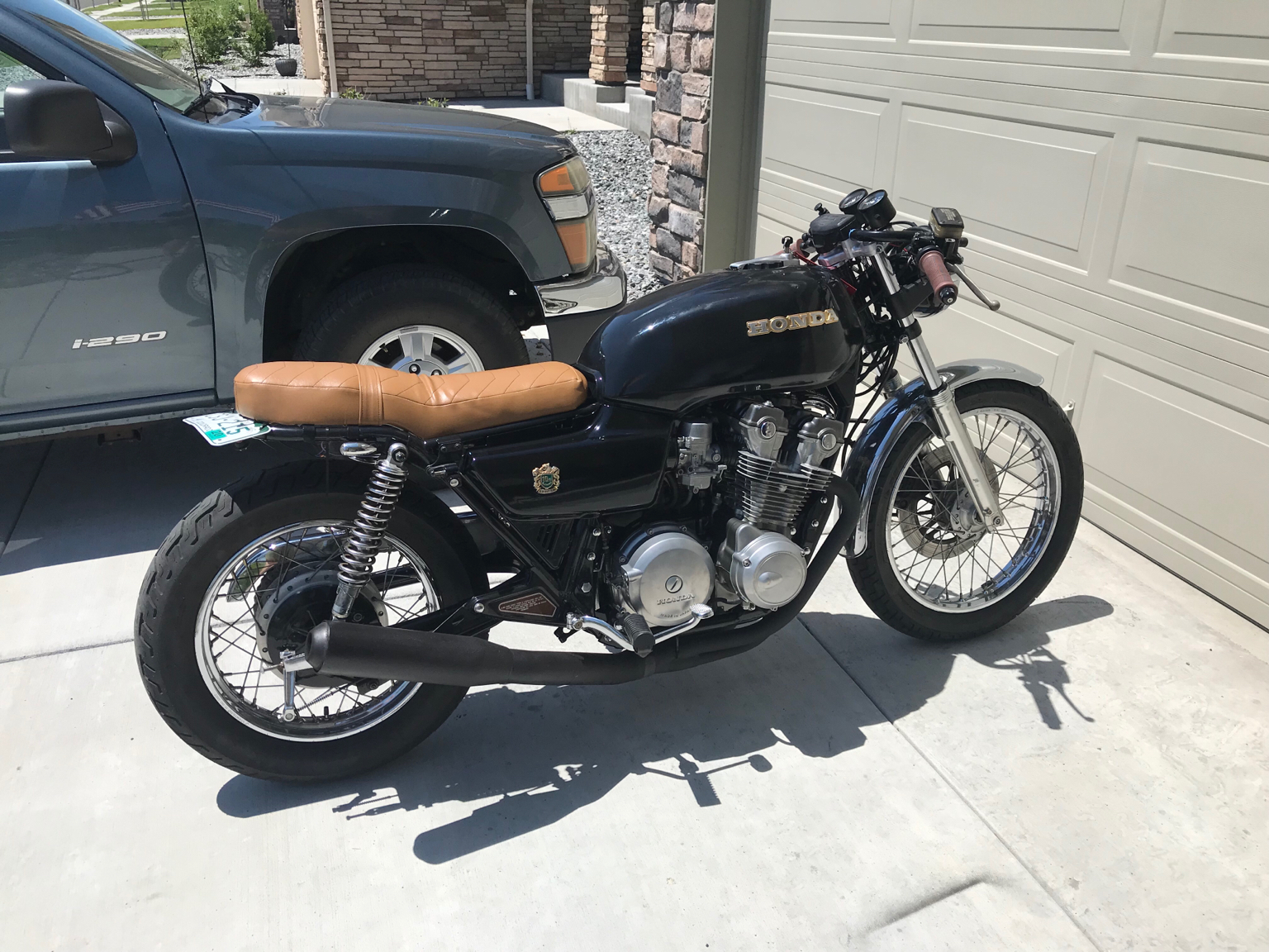

1979 CB750L. My first cafe/brat project. Denver Area
Thanks guys. I still have a few small items to tidy up but I’ve put about 200 miles on it so far. I will probably repaint the tank a very dark green this winter.

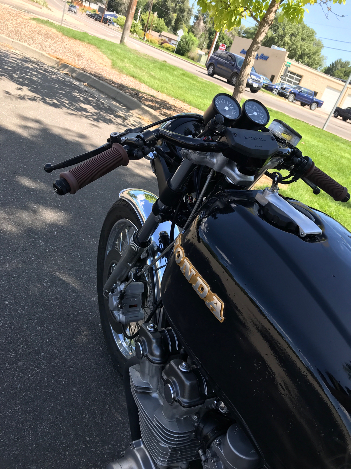

Kung-fu grips, in oxblood no less. My man 8)

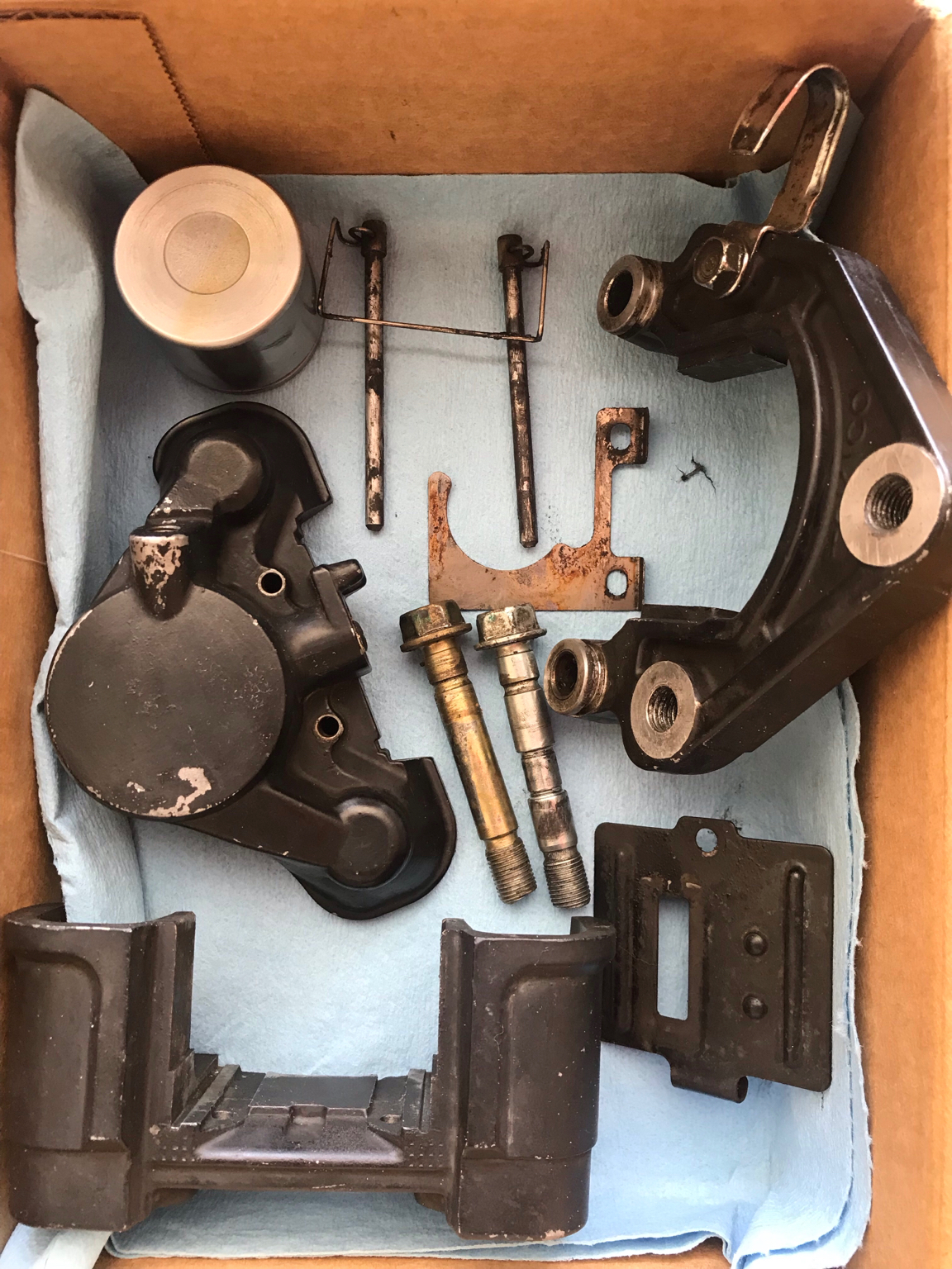

I know it’s pretty common but it still sucks. I had a hanging front brake and found this pitting during disassembly.

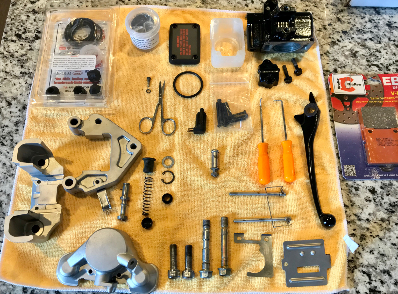

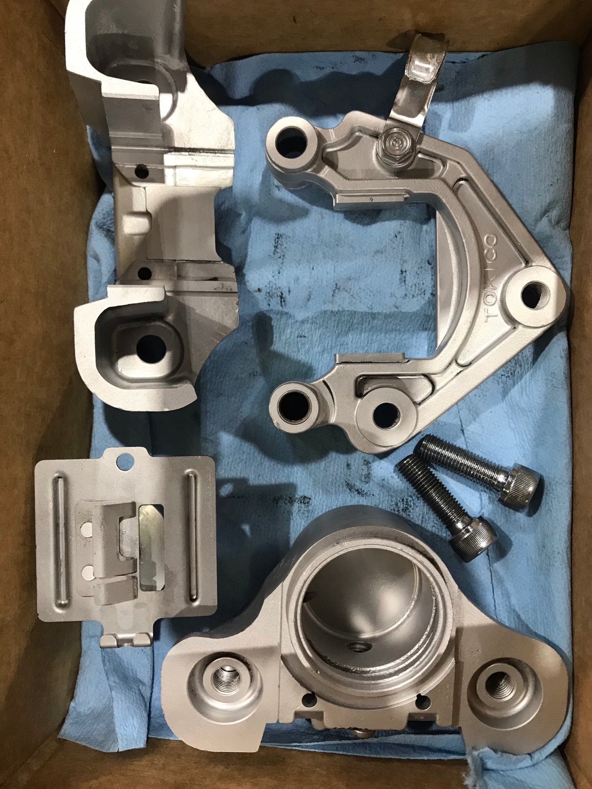

Front brake is done. The local Ferrari shop vapor blasted the parts to match the engine covers they did earlier. Repainted and rebuilt the master and installed a braided line. Rebuilt the brake and am leaving it bare.

The vapor blasted brakes look great. Are you putting any clear coat or similar on to protect the (lack of) finish?
No, I’m leaving them bare. The vapor blasting closes the pores of the metal and the finish is very durable. The engine covers were blasted a long time ago and look like the day I brought them home.
My ass isn’t loving long rides on this machine but my soul sure is! Even went to a car show and got a lot of attention.
