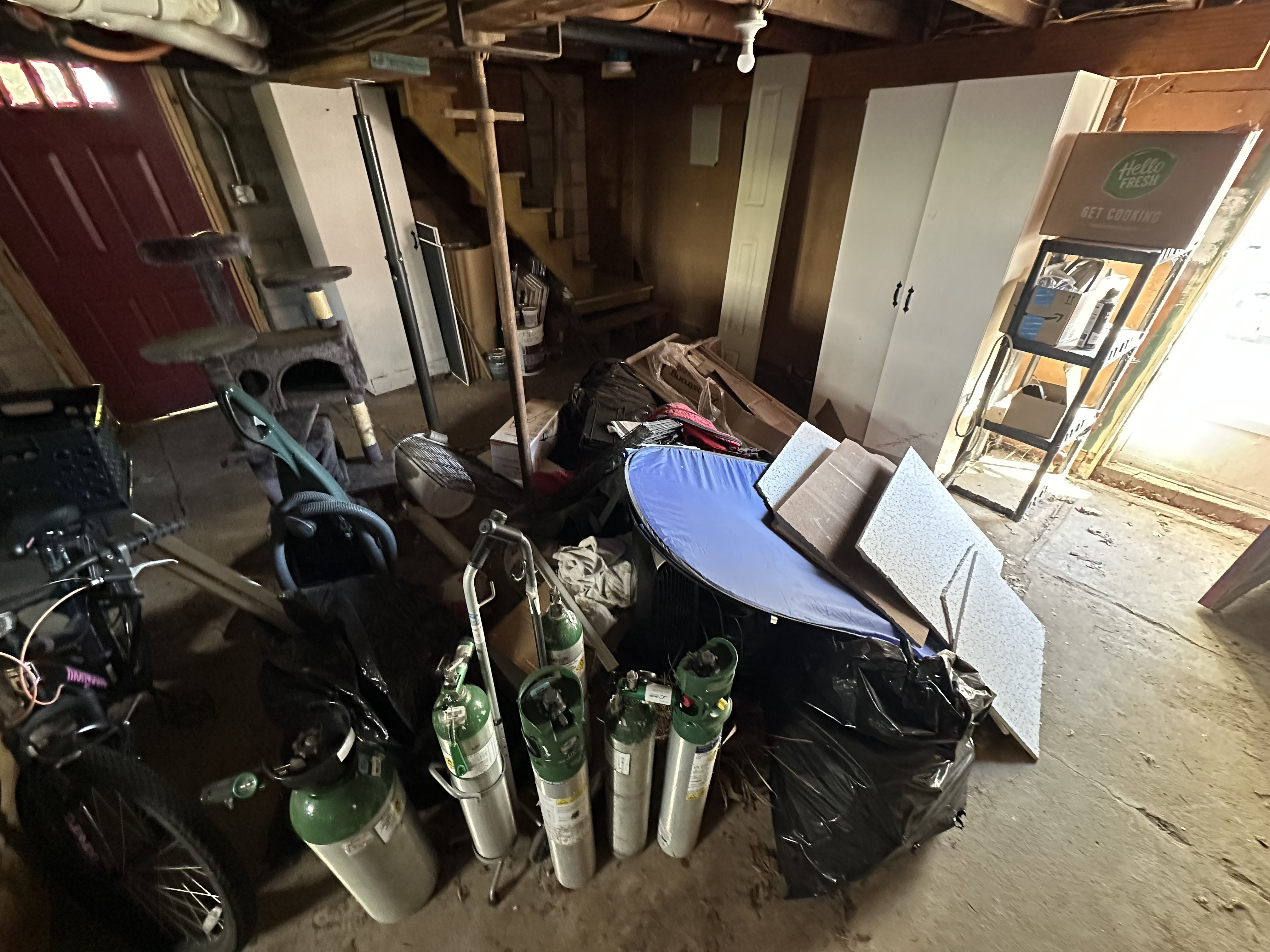

Some before and afters of the shop (aka basement)
After the initial cleanout...

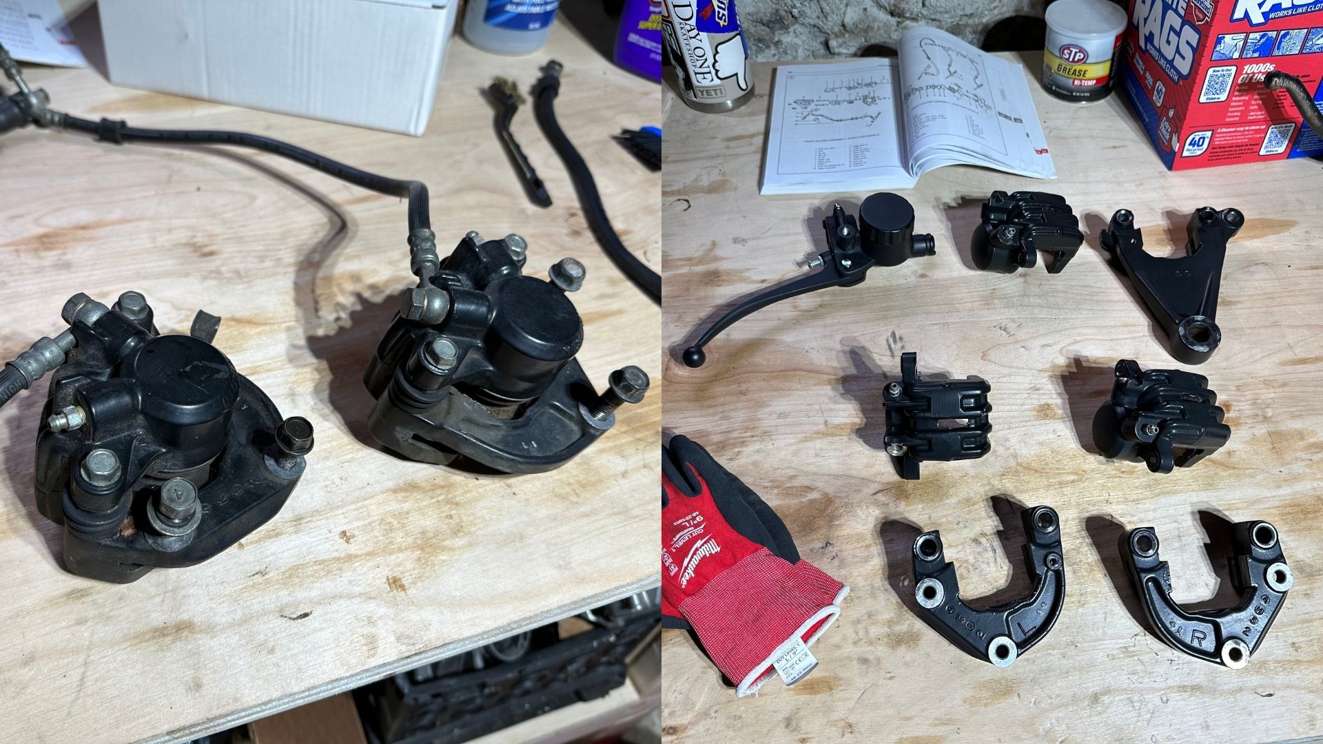

Brakes and front forks come first in the build. Both jobs seemed relatively easy and a good chance to get my feet wet and build up some confidence.
Brakes
Front and rear master cylinders both look like they have put some hard work in - time to relieve them of their duty. I upgraded the front master and rebuilt/repainted the rear. All caliper pistons were seized which was fun. I attached a brake line from the master to the caliper to build pressure and pop the pistons out so I can replace them along with all the rubber seals and clean the interior. I bought a brass wire wheel off Amazon to clean the area in the caliper where the piston sits, however, I received a brass colored steel wire wheel…almost ruined the inside of the caliper. Glad I noticed before I scuffed up the inner walls/changed the bore diameter.
I threw away the rear brake shim and then realized they’re pretty hard to find…lesson learned. Also the rear brake pistons are not made anymore (I think this is true?) and they are taller than the fronts - I found someone on ebay selling some replica’s and it looks to be pretty good quality and a snug fit.

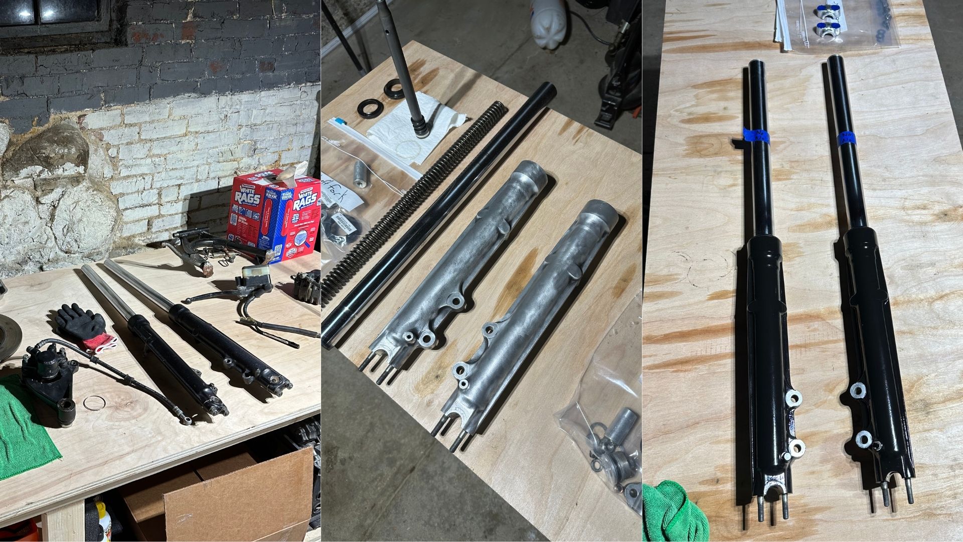

Forks
Didn’t get a good before picture of the forks but the fork tubes had some surface rust on them and the paint on the lower fork assembly was chipped/faded. I drained what fluid was left in the forks which certainly was not fresh. The forks came to me off the bike which made unscrewing the top bolt pretty difficult. I was ready to buy a vice with a soft jaw attachment but realized through the forums that I could just put it back on the bike and crack it loose before moving forward. Another lesson learned - loosen bolts on the bike before fully disassembling.
After disassembly, I was able to get the fork seals out (huge pain) and then began stripping/repainting. I sanded off the old coating and used some high durability frame paint - hoping it is strong enough and doesn’t chip. It’s not very clear which side is top/bottom on the new seals. I used the old seals to help me figure it out - hopefully they were installed properly.
Overall, the front forks and braking system look and feel brand new. I’ll get some new brake lines and fittings later on down the line in the build.

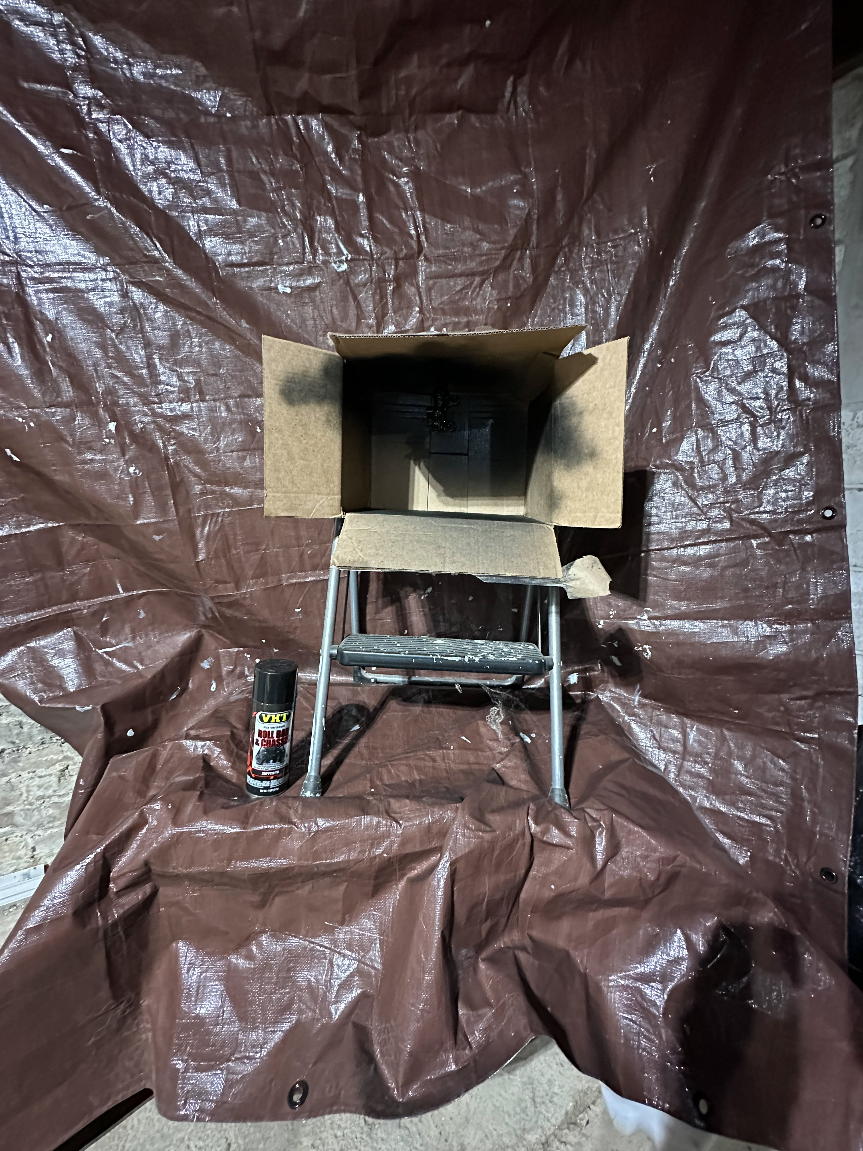

Gotta show off my sad looking paintbooth:

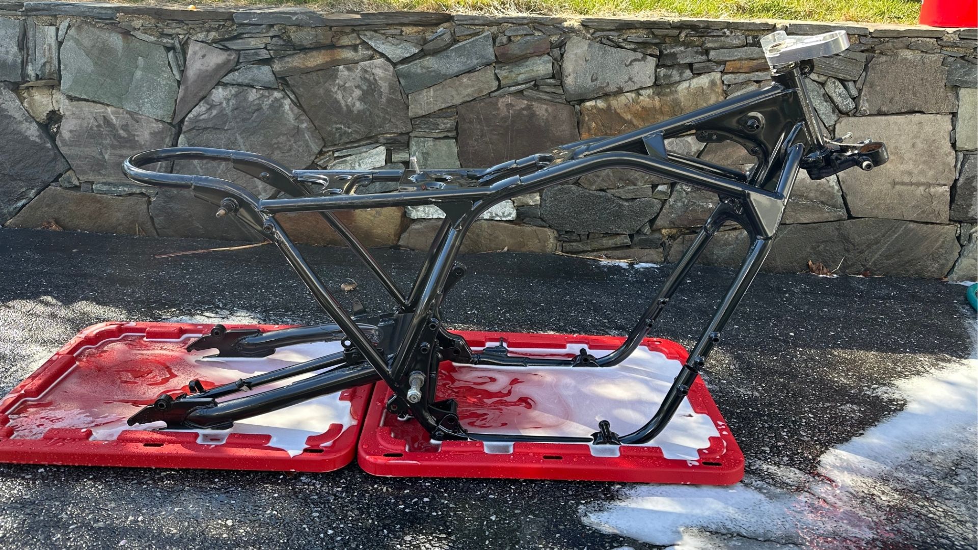

Frame Clean

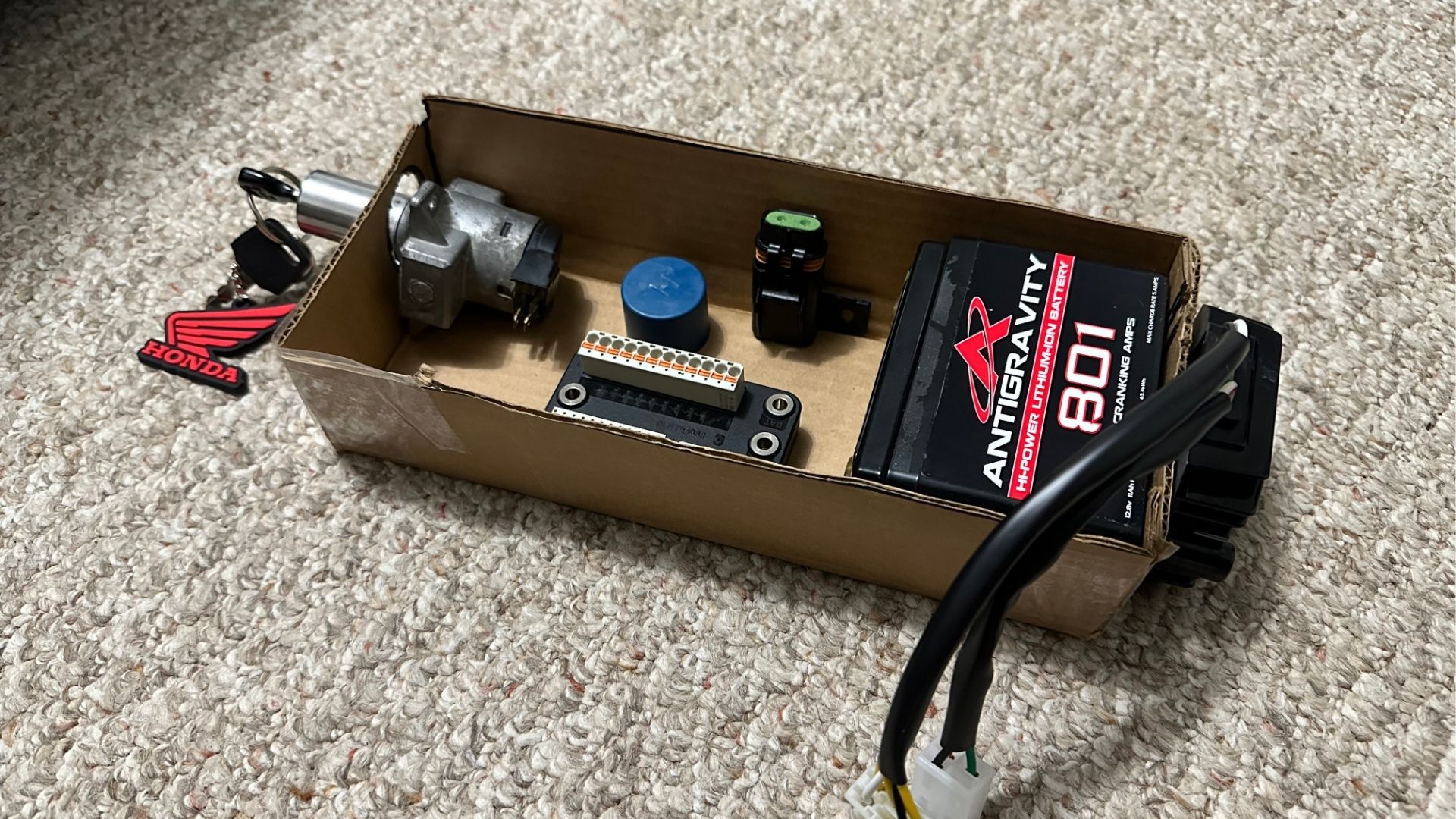

Potential Electrics Tray layout

These measurements will also help me plan out my electronics tray. I would like to keep all electronics under the seat even if it is a bit more bulky and less streamlined than mounting the battery under the bike. Below is a picture of my very advanced CAD (Cardboard Aided Design) layout of the tray and components.
Photo Notes:
-I’m missing the spark units in this layout (I have them just left them in the shop)
-The Harry’s shaving cream cap will eventually be my starter solenoid
-I’d like to squash the Ricks unit on the inside but I’m not sure about overheating with the reg/rec, battery and spark units..
-The stock key barrel is huge - I hoped to keep this original but I may upgrade for a smaller unit
-I was hoping there would be space for a spare tools roll but I think this box will quickly fill up with wires

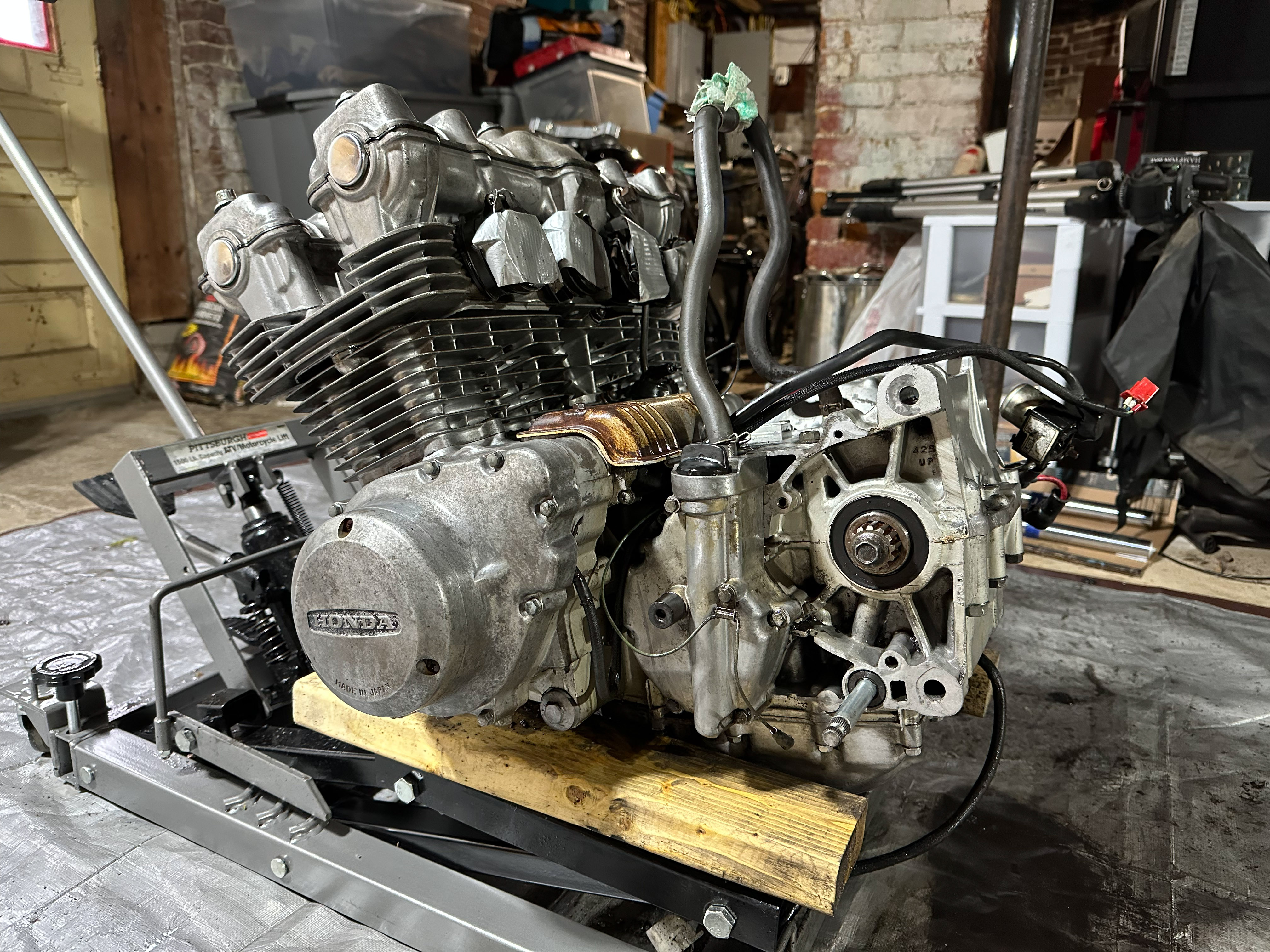

I made - what feels like - big progress on the bike this week. I was able to get a buddy to help me get the engine out of the donor bike. I have never taken a motor out of a vehicle before so I wanted to move slowly and be cautious of the frame/bolts/cooling fins to avoid injury and anything breaking. Overall, it was not that difficult and the Clymer was a good resource to give us the proper order of operations for removal. The removable frame section was also a huge help - I’ve seen some YouTube videos of SOHC guys struggling to yank the engine out of there.
So far the engine looks to be in good shape - the oil didn’t look milky or have a shimmer to it which is good - we’ll see what the oil pan has to say but I’m confident she’s solid. Cleaning and degreasing the engine is going to be a nightmare I can already tell. I’m not sure how I’ll get all the dirt out between the cooling fins aside from using a steel bristle brush.

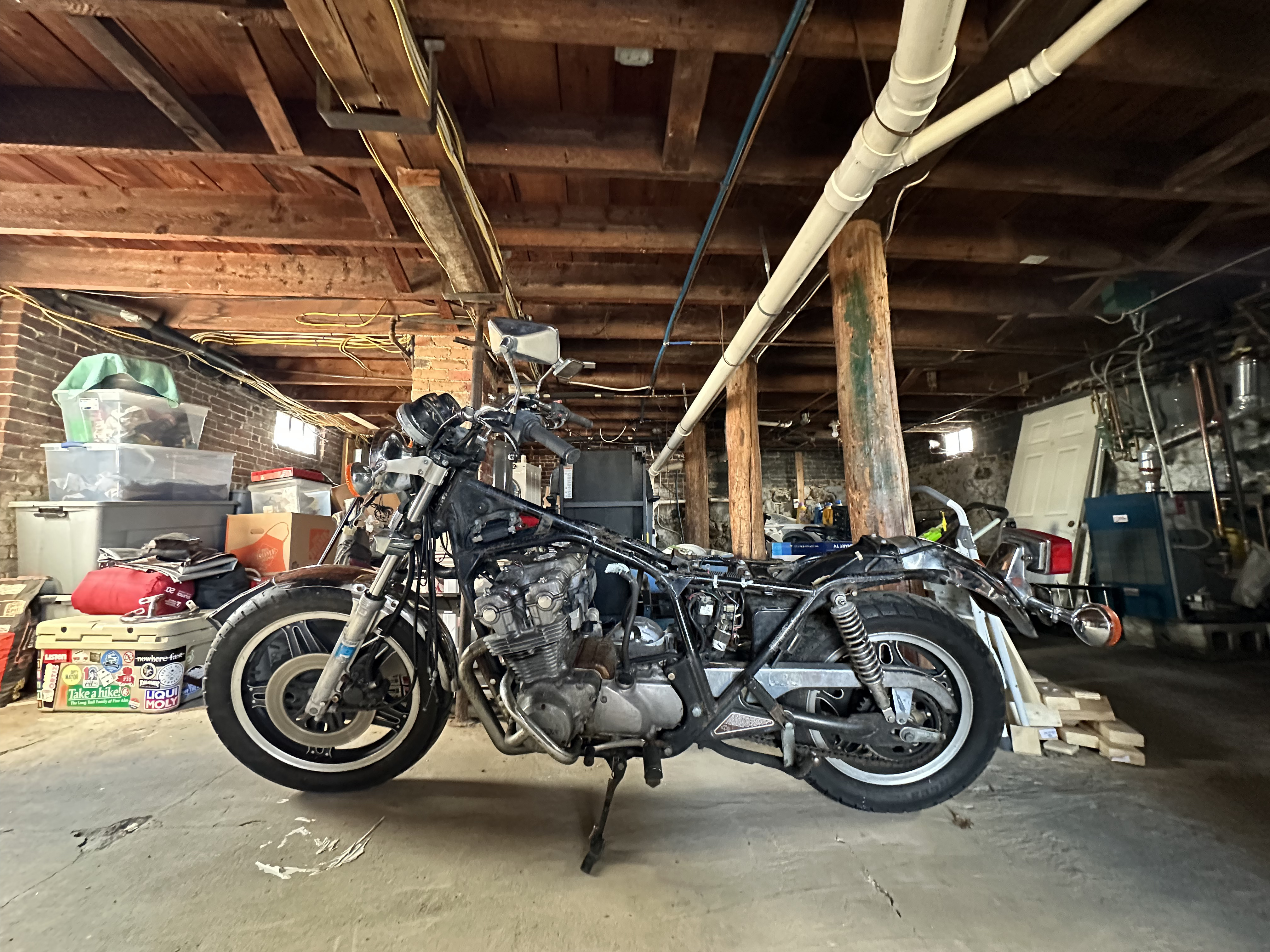

To keep motivation up I put the frame on the jack and mocked up the tank and suspension. If you squint your eyes and tilt your head you can see a first glimpse of what the end product will look like. I’m looking forward to the bodywork portion of the build and working on the tank. Hopefully when the engine and/or wiring work gets overwhelming I can switch to the more creative and less technical projects to keep making progress. Time to start thinking of color schemes and the final “look” I’m going for. I keep switching back and forth between a few styles..

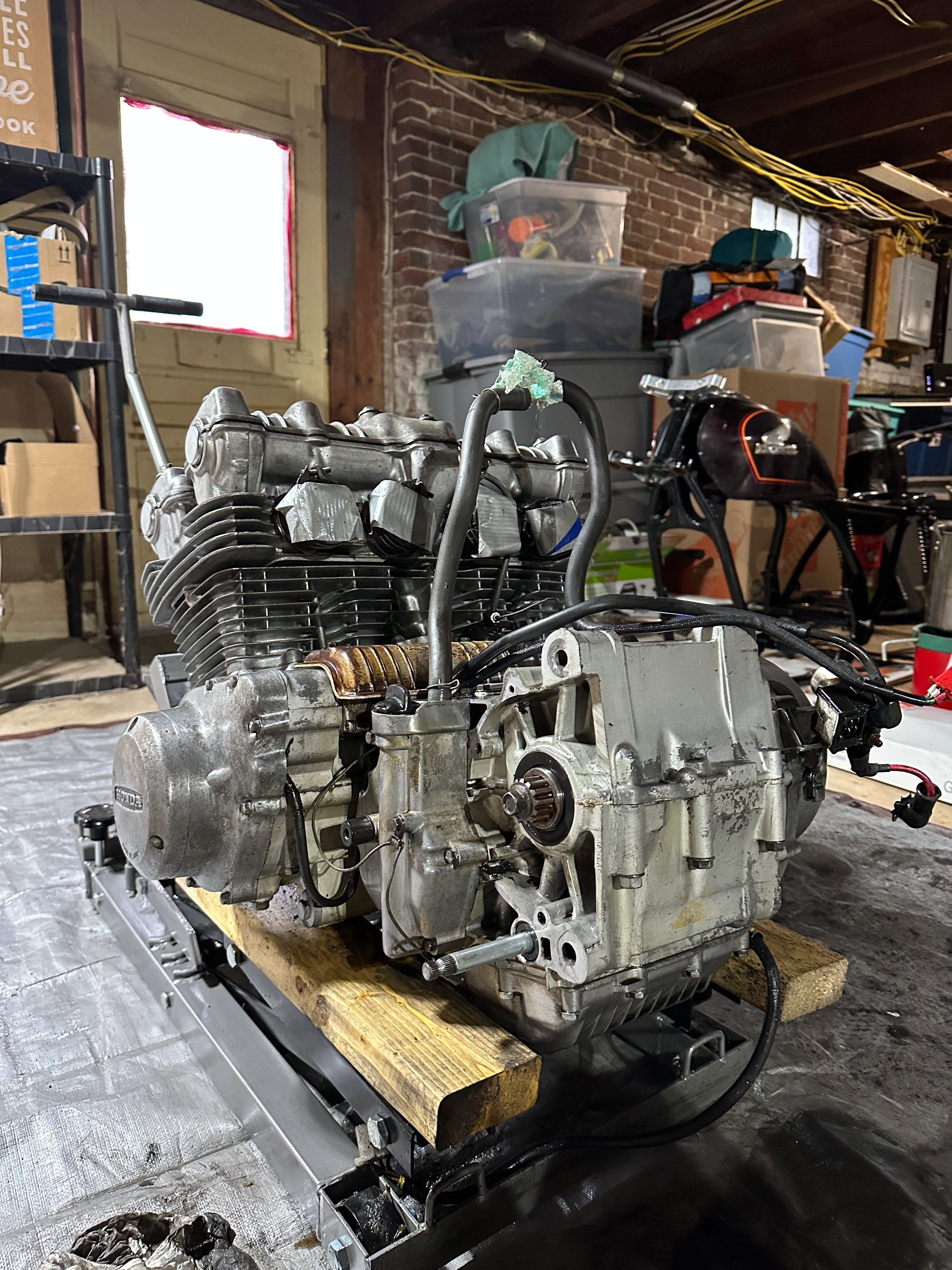

Hardest part of the engine work so far was trying to find someone to help me get it up on the workbench. All my friends that are in town were unavailable and the wife and I couldn’t get it done (though it was hilarious to try). I spotted my neighbor smoking a cigarette outside and he was my next victim to help out . After it was up on the table I wasn’t sure how to support it. I know in the automotive world the oil pan is pretty weak but on a motorcycle it looks to be pretty solid - just don’t want to break any fins. You’ll see in the photos below as I work on the motor I have a few variations as to how I stabilize it for work. I’m jealous of the SOHC guys who have engine holders available to them online. Another good reason for me to learn how to weld…eventually

First part of the engine I wanted to check was the oil pan. Thankfully there were no metal shavings in the oil - just a bunch of sludge (as expected on an older engine that sat for awhile). Since I plan to rebuild the engine I would like to run a magnetic drain plug just in case theres some self-tolerancing that occurs post-build. Hopefully not much of course.
After the pan was off I noticed that the bottom of the engine was pretty flat without the pan so I put some 2x4s (as pictured) below the engine to keep it straight up and down and easy to work on. I figured it would be a little disorienting to work on the engine with a slight tilt to it all the time…we’ll see.
