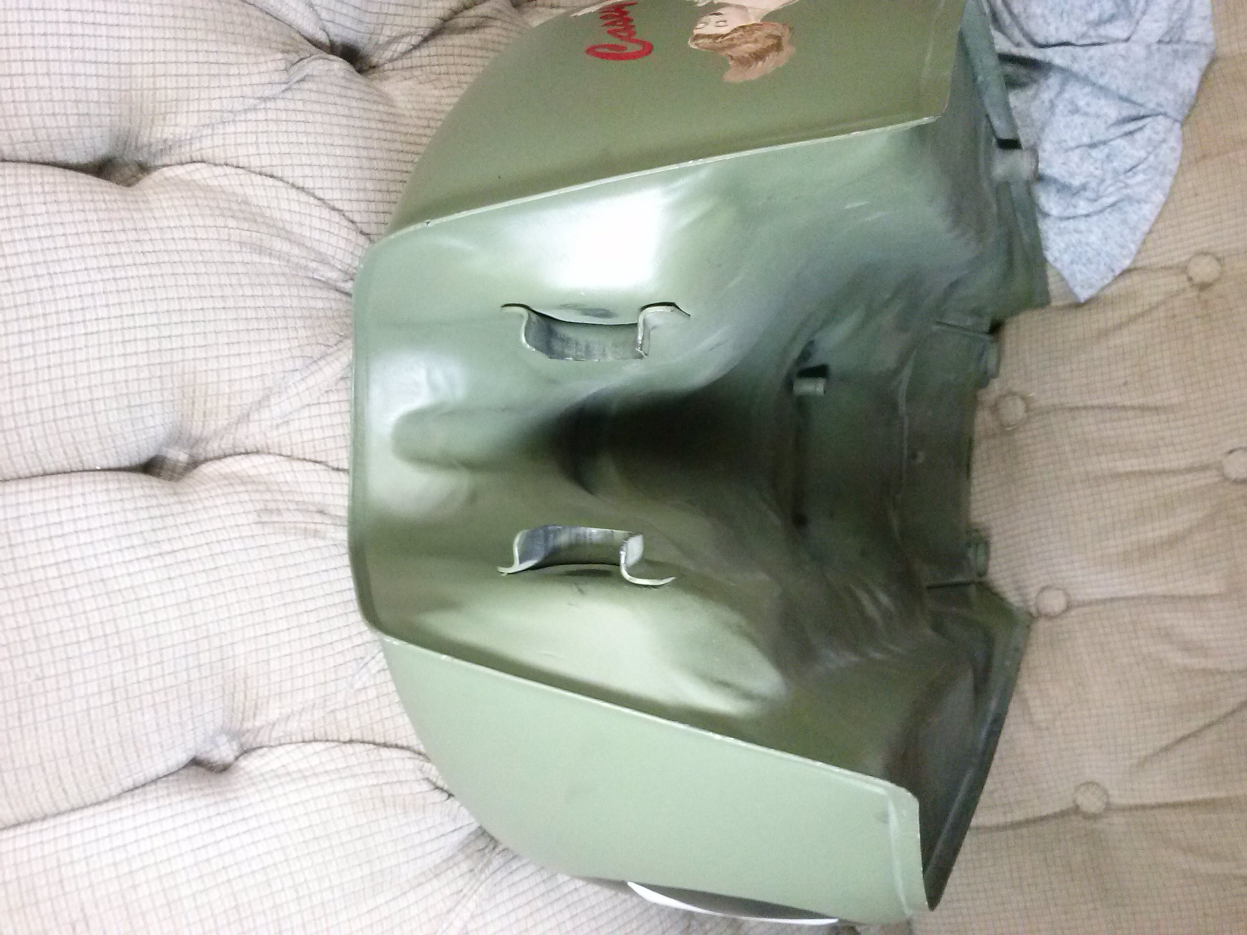

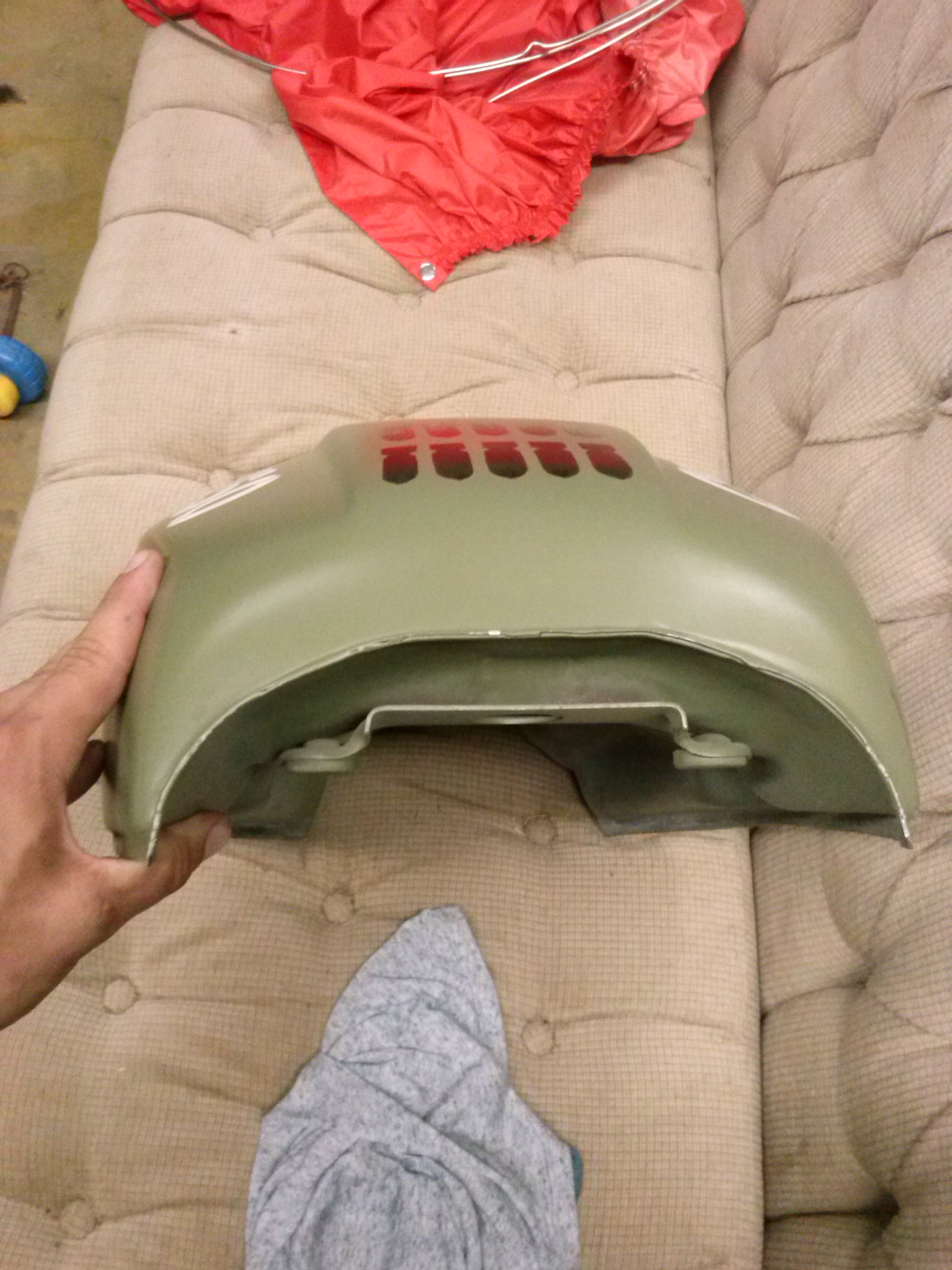

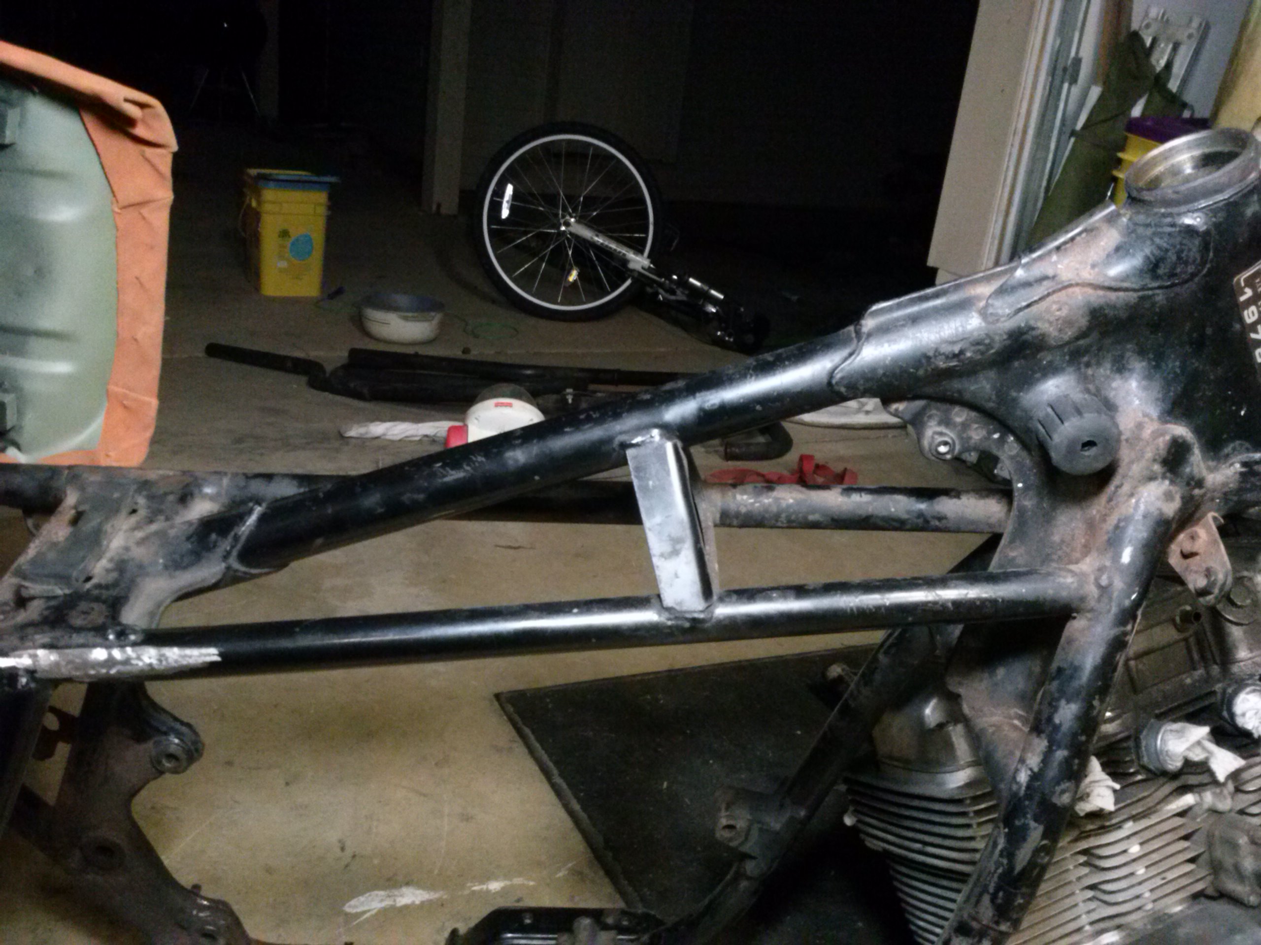

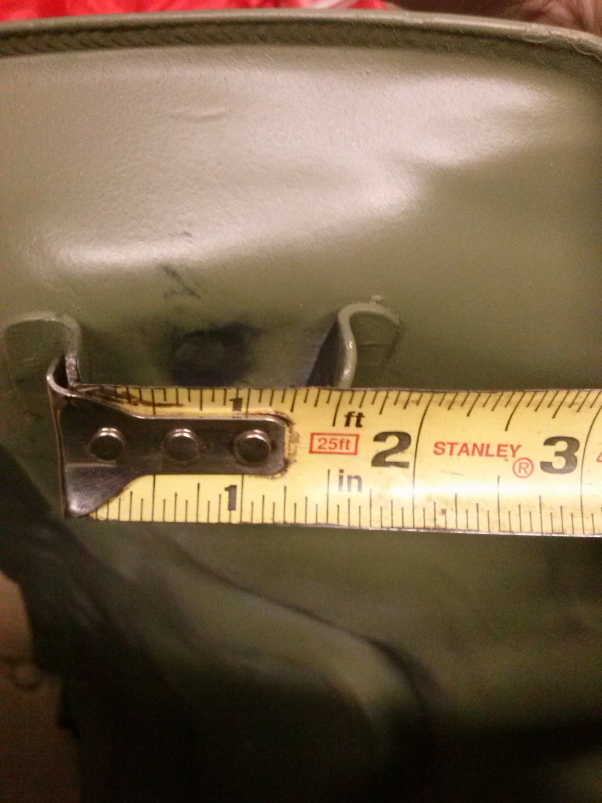

I have a 78 cb750k, here is a picture of my frame where the tank sits. you should be able to determine by looking at yours and mine if it will fit. i wil post close ups of the rubbers and the bottom of the tank.
i was looking at a 1980 frame and my guess is the bottom of the tank might hit and not sit correctly. where the "hump" is versus on the 78 where is its flat. maybe someone will come along who has tried it. hope these pics help

I actually got in touch with a builder who said the only way to do it is to cut and re-weld the bottom of the tank to make it wide enough.
Now I need to find someone I trust enough to do that and to see if its even worth it.
