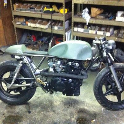

I'm on my 2nd CM400,I ran pods and pretty open exhausts on both of them,2nd completely open.It should start and idle fine if so bump your main jet to a 120.If it has 112"s you should be good if you have 118"s then you will need to put a shim under the needle. the cv carbs on the bikes work really good if they are clean and all the diaphragms are good. Heres a pic of my first one that was stolen 3 weeks on the road. Hope it may give you some ideas. Looking good.

All I can say is WOW! You really got to the heart of what makes these things ugly. An choped it off! We talked alot about getting rid of the rear hoops. I just thought leaving them for shock mounts would be best.... I guess not ;)
Thanks man,if you cut a couple of inches back from the backbone and at the bottom of the hoops you can slug in your new pieces. then all the ugly is gone. Hope the pics helped you out.
