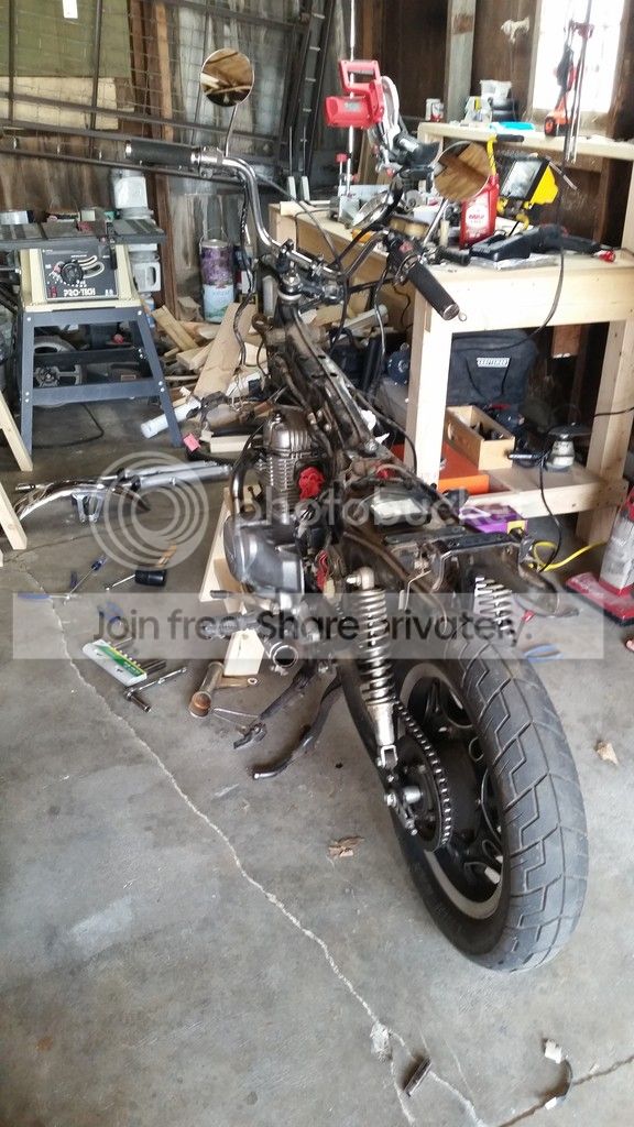

1980 CM400T picked it up for $500 and drove it the hour and a half home with a little front wheel wobble but that was the only noticeable thing wrong at the time.
After I got it home I started looking her over and seeing what I got myself into and found a lot that needs done. So I started the teardown process and lots of things were not as they had seemed. And don't make fun of how trashed my garage is, I have since moved and gotten a much bigger garage for my projects.

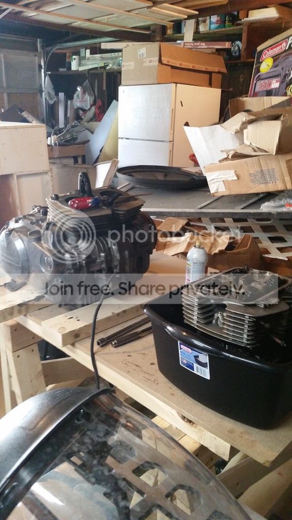

A lot needs replaced I know. Ive always been good with mechanics so I knew a 36 year old motor would need some parts replaced so Im doing a complete top and bottom end teardown, clean, inspection, and measuring for specs.

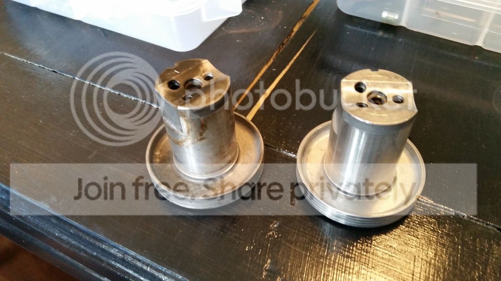

Then I found this, it looks like the chain grabbed something and pulled it around the sprocket and ripped up the engine case on its way.

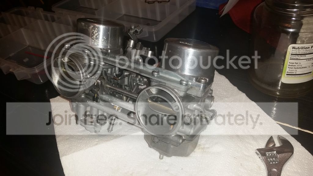

Also I pulled the carbs apart and cleaned them real good and rebuilt then with some new parts. Heres some before and after pics.

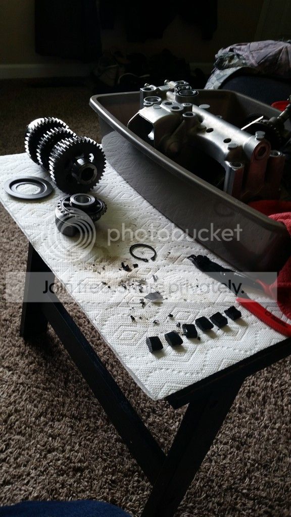

This is after everything went through the parts washer the first time.
All the little plastic pieces here are from the cam tensioner and the rubber cushions for the balancers.
