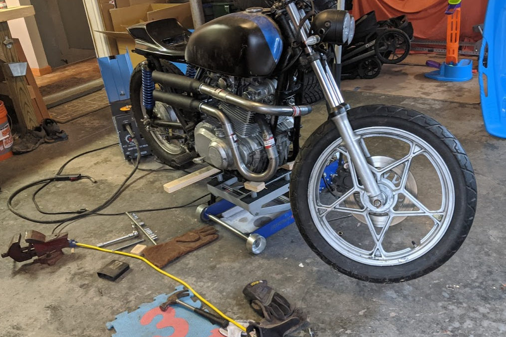

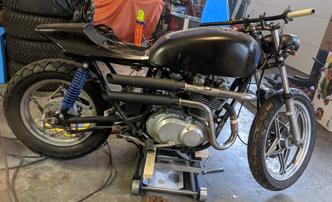

Wow, I can't believe it has been 5 years since I posted this question. I guess 2 moves, getting married, changing jobs and 2 kids will kind of delay things.
I'm making a hard push to finish this before spring so i can begin the nest build.
The cafe build has morphed into more of a brat style, but I have the high pipes mounted up. I plan to weld them to in the next couple days. Since my welding is mediocre at best, they will be covered in titanium colored exhaust wrap. Haven't decided if i'm going to line the tips up vertically of have them offset. Also i think i'm going to bring them closer together.
Nice work! My two cents is offset tips and definitely closer together... and make sure you have plenty of room to be able to check the oil level with the dipstick!
Regarding the cafe comments above, yeah, this is your bike, do what you want. Go back in the day where the cafe was born and there was no cafe "style", it was all about removing stuff to make them as light as possible to get from cafe to cafe in the quickest time.
For myself, I had a local exhaust mob make me a two into one high pipe as I was going with what I considered scambler inspired and it's been great. I did want it on the right side Honda CL style, but during the mock up phase I realised I wasn't going to be able to check the oil with the dipstick, so I moved it to the left hand side.
Recently I changed to clubmans and rearsets to what I've dubbed "cafe-ish" but I'm not changing the exhaust, I love it!
I’ve got a GS450 too and am looking into a 2-1 set up but to see some high pipes is cool. If you are worried about welds you could tack it and take it in to a shop to lay a nice bead on and paint em black if you want it coated. I’d bet you would be close to price of the wrap if you go this route plus you’ll know the welds are done up right. (I’m also not much of a welder myself!) I second what’s mentioned above. Make sure you can get to the dipstick and that cylinder #2 spark plug as well. Raising up pipe #2 might also leave you some room to get to the clutch cover Incase it needs some service and you don’t want to remove the exhaust too. But that pipe could also be removed or loosened to get to it. Overall I dig it. A low cost option for a custom exhaust. Congrats on the kiddos and all the other good life changes in the last 5 years. Sounds a lot like me in the last 5 years as well. Good job hanging onto the bike and not giving up the dream! I’ve done the same, 2 runners (GS450S for street and PE175 for dirt) and 4 other bikes to wrench on. My half of the garage is packed full!
