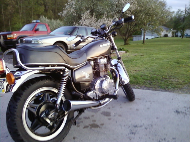

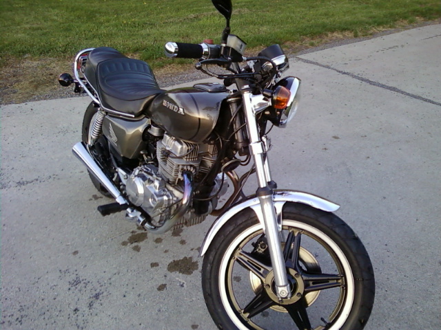

Before: (pic taken somewhere around august 2011??)
I was able to buy a parts bike for the start of this build. The parts bike had the same gas tank, seat, frame, and more matching parts that I could use on my bike. The only difference is that the parts bike is a kick start hondamatic. My first day was spent tearing the parts bike down, trying to get my vision for what the bike will look like. The pics are of the parts bike torn down ready to start some fab work.

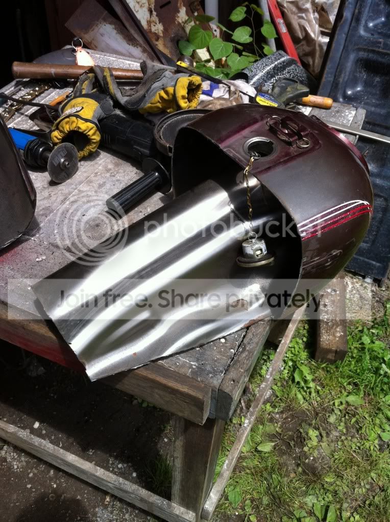

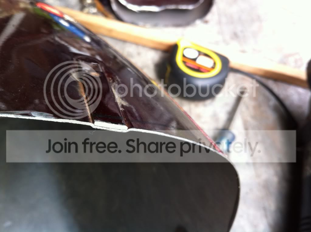

The second day of the build was a good day throwing sparks! I used the gas tank off of my parts bike to create a 10 inch rear cowl. The bottom cut was a little nasty due to me being nervous!! but after some work with a hand file, i was able to make it look nice and even ;D
I cut the top and the bottom off,
And BAM!! My first piece is cut out!

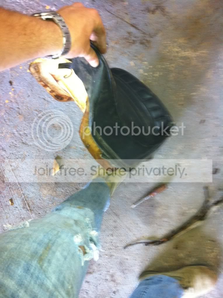

We cut the seat pan down to be 13 inches long. I would have rather made an all new pan but with only having about 2 weeks max to make this this, I needed a fast easy way to make a new seat.

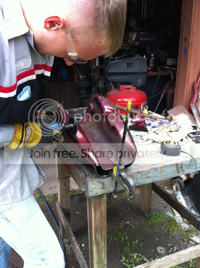

After I cut the seat pan out, I went back to looking at the rear cowl. The old tank had the riveted mounts on the side for the honda logos so I had to grind them down to make the side smooth and flush.
Before:
After:
I'm not sure If many others have gone this way for building their cafe racers. I got the idea for the rear cowl from a picture on google that had a description of how they used a gas tank for there rear cowl. I figured that if I used the same tank thats currently on the bike, then the lines would look real good between the tank and cowl. Do most people just go with fiberglass now?
