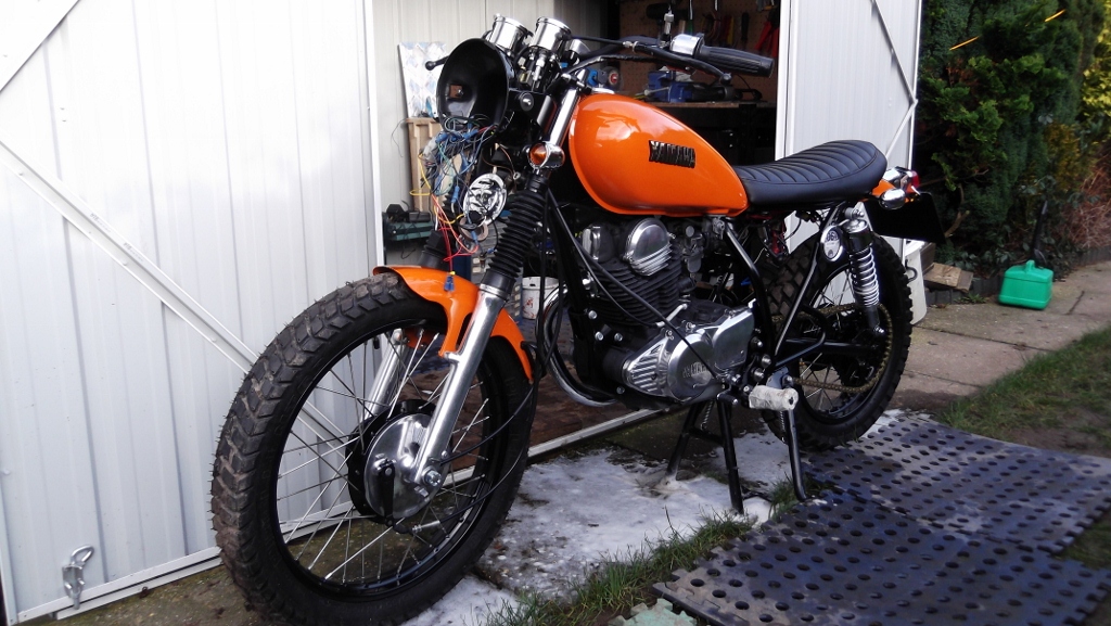

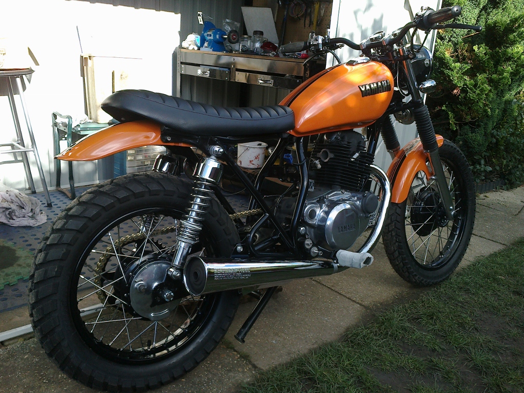

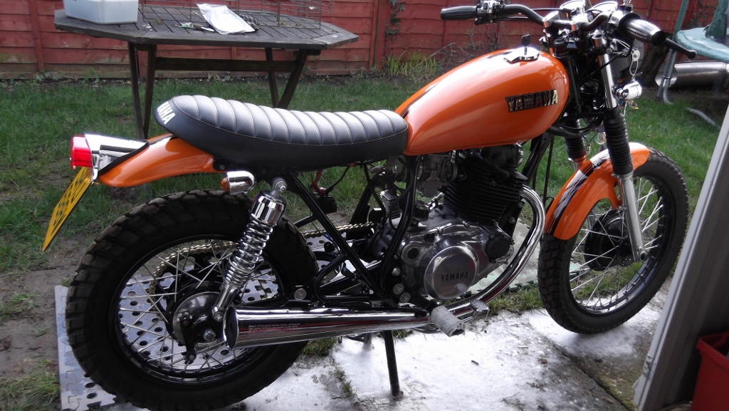

A few more pics, please ignore the headlight being sick, should be done soon. Will be knocking up a tray for the battery soon, fits nicely (hidden) under the seat.
