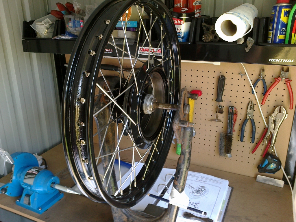

nice job man. I had to retry about 5 times when I laced my wheels until I got the start and pattern right. Still have to touch up the scratches I made in the process. >(
Are you having someone else true them or are you doing it yourself?
Cheers. I'm going to have a go at trueing them myself using and old swing arm and a pointer. If I can't manage it I know a guy who builds wheels. I'll post some before and after pics of the wheels when I get the new tyres fitted, hopefully by Monday.

Finished lacing my powder coated wheels with new stainless spokes today, and I'm very happy with them. You can see from the pic below that I used my old swingarm and a pencil to get them true. It takes a while, but it saved me £80 and I have the satisfaction of knowing I did it myself. I'll be getting the tubes and tyres fitted tomorrow.
