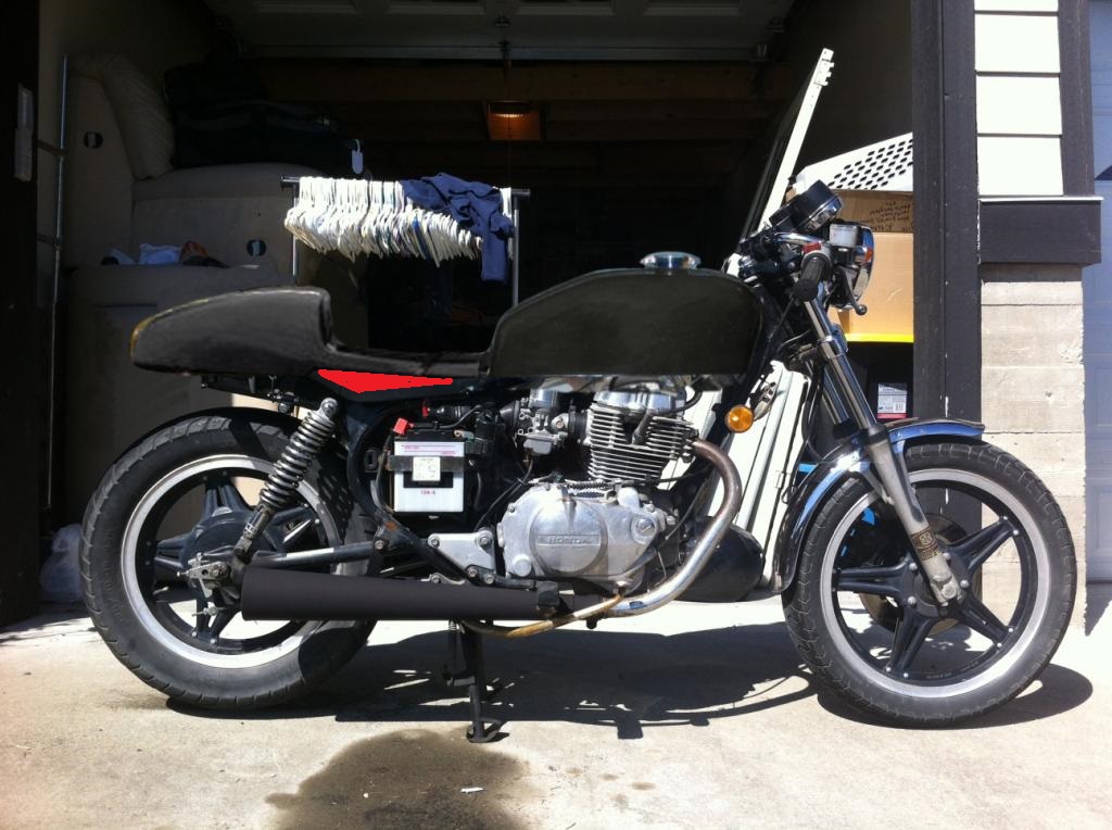

I'm taking a huge amount of inspiration from fresh_c's Ugly Duckling build (http://www.dotheton.com/forum/index.php?topic=36439.0) and I plan on making a very similar seat frame for my rocket 4 seat. Eventually, I plan on hiding all the electronics and battery under the seat as well. I purchase a '77 CB400f tank and I'm looking forward to making that work with my bike. I'm trying to gather as much info on this chrome paint from Spaz Stix as I can and hoping to paint both the tank and seat with it. All the images online and videos on youtube look very promising and they even claim it can be used with a 2K clear for protection. I've emailed them with a few questions, so we'll see what happens.
For now, here's a VERY crude photoshop example of what my bike will look like with the new tank and seat combo (minus the paint). A set of Viet's rearsets should be in the near future as well.

I have my CB400F tank now and have to start looking at paint options. I haven't had a chance to mock up the tank and seat on the bike yet to see what it will look like, but I get pictures when I do. Next step is to make a seat frame for the Rocket 4 to sit on. I'm thinking that I might have to trim the front of the seat to shorten it up. We'll see.

The hump on this tail section is almost big enough to hide a car battery in there! The hardest part of this whole thing right now is finding time and I'm itching to get new tank and seat done. I'm chasing leaky gaskets right now.

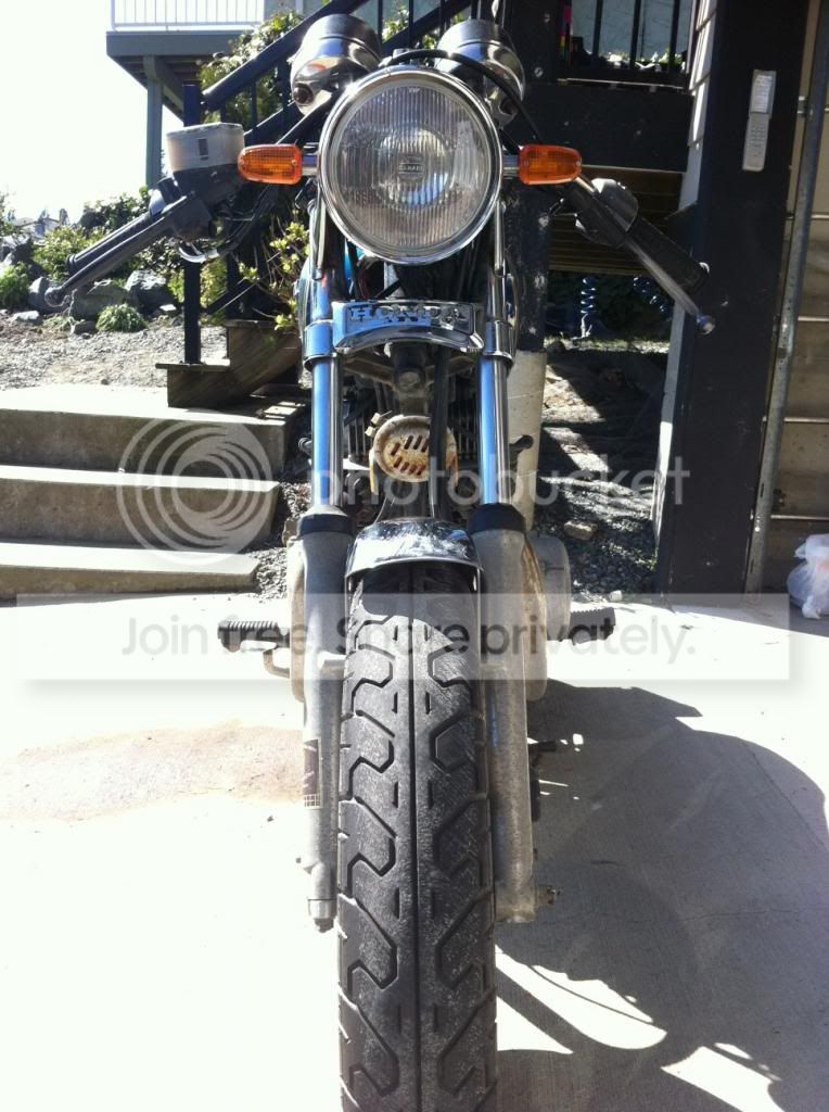

I've been riding around town without mirrors since I've installed my clubmans and knew it was only a matter of time before the local police noticed and pulled me over. I searched around for bar end mirrors and continuously spat coffee all over my computer screen in disbelief of their costs. I know, I know.... You get what you pay for.... But, I need to keep this relatively low budget. I found these eBay bar ends (as I'm sure many of you already have) and ordered them.
They seem pretty solid and I don't foresee having to continuously readjust them as they tighten down pretty good. As you can see in one of the pictures, the finish has already started to get stone chips. Not a concern for me, but maybe for some. The one major gripe I have with these is the tapered nut that goes into the bar and tightens the mirror down. This little "metal" tapered nut feels like it is made out of butter and I mangled the right side one trying to get it tighten down. Almost to the point where it was US. Other than that, I'm happy with them.
