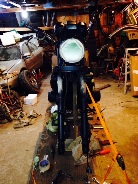

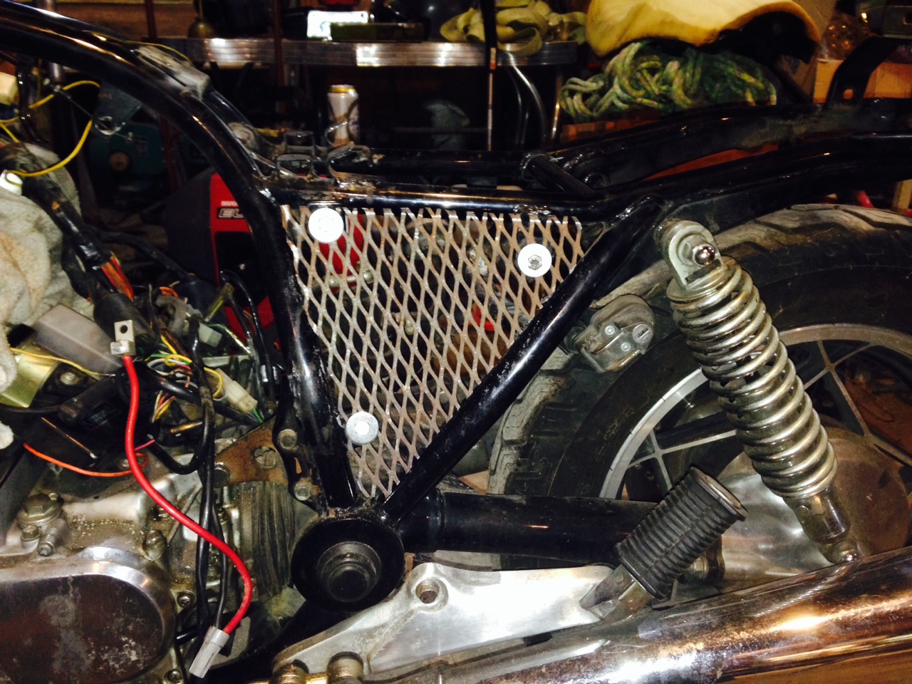

First off I'd like to extend a big thank you to this board for all the inspiration! This place really is a wealth of knowledge and advice. I've been riding since I was 7 starting out on a Yamaha 70 trail. Through the years I've owned a Kawi 650c (wish I still did!), a '70 sporty, and a '89 Katana but I've been on a dry spell for about the last 10 years. Just recently I picked up this '81 GS1000L that needed a little work to get it running, and it was ugly as hell as you can see from the first pic. I thought I wanted to cafe it but then I started reading here after I had disassembled and/or chopped a bunch of the ugly off her. Now it looks like I'm going more of a bobber/chopper route but I don't know what it's really going to end up as. The lines don't seem right for a cafe so...I shortened the original seat pan and rear frame about 5" as well as carved up the foam, reconstructed a new tail light mount for an all-in-one LED model, cut up the rear fender and created a new mount, rotated the battery 90 degrees and remounted it along with all the wiring as well as fabricating mesh side panels to avoid the use of those "bubbly" stock versions, de-pinstripped the tank and sanded it down to prep for dent removal and filling, and started painting the rear section because I just couldn't wait. My goal is to have a decent looking bike that has some character to it that I can ride the rest of the season. Any and all input is greatly appreciated. Oh and you'll also see my work table that I built just for this project after I got sick of sitting on the floor. I've got a set of clubmans on the way that I was thinking of using because they were cheap and I figured they could be mounted either direction?

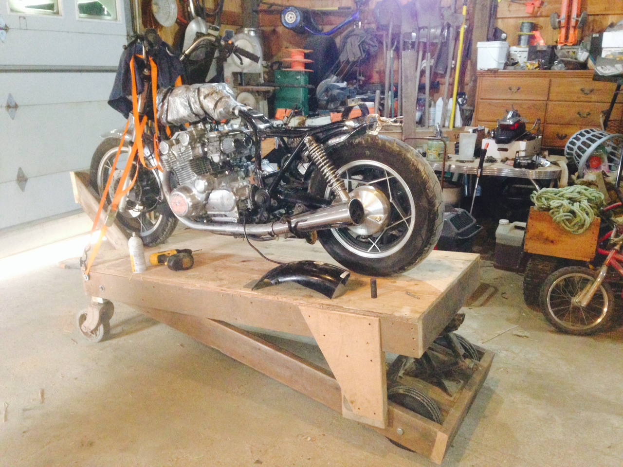

Here's the latest pics of this project. I just got it back up on the table to wrap the exhaust, redo the rear fender strut, and replace the clutch springs.
