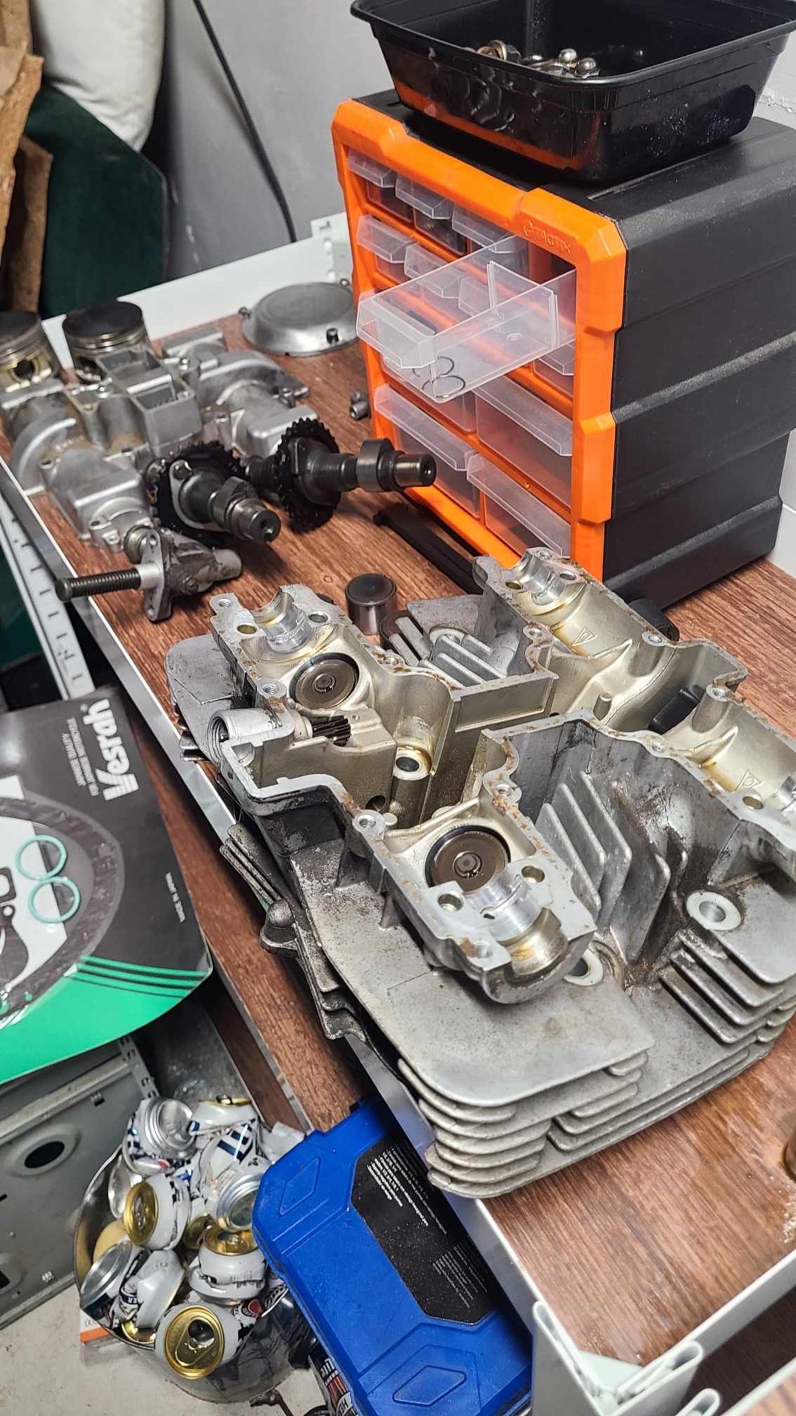

So after doing some testing i found that there is a small break in my head gasket on the Left side Cylinder. So it looks like a top-end "Rebuild" is in order. New Gaskets, shims, possibly valves, and honing of the cylinder/sleeves. So this is going to be a fun fall/winter for me...

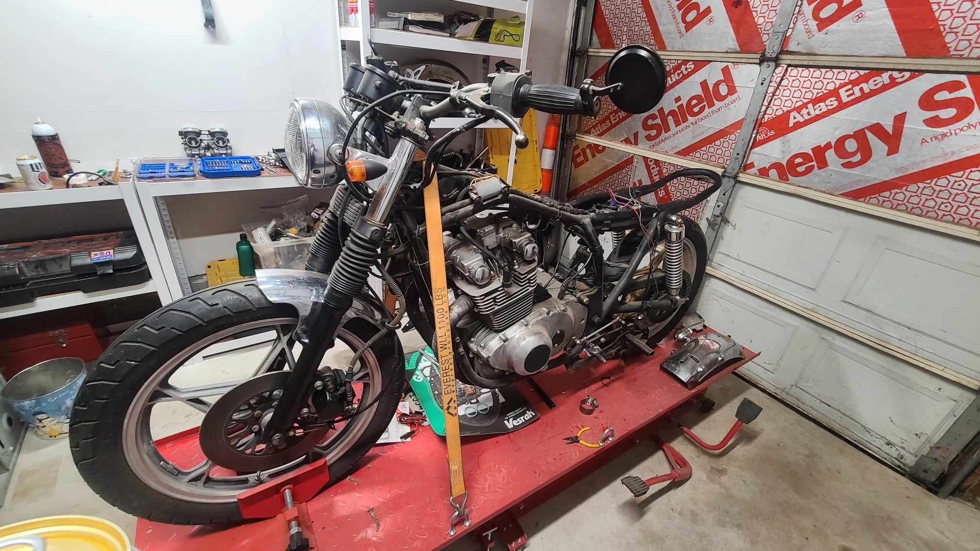

The picture of it all together was the what it looked like when I picked it up from my parents storage a couple months ago. Finally got it apart, and also decided I am going to big-bore it. Gonna upgrade to 73.5mm pistons. I am getting it bored out in a couple of weeks, and going to work to clean everything up while I wait for parts!
