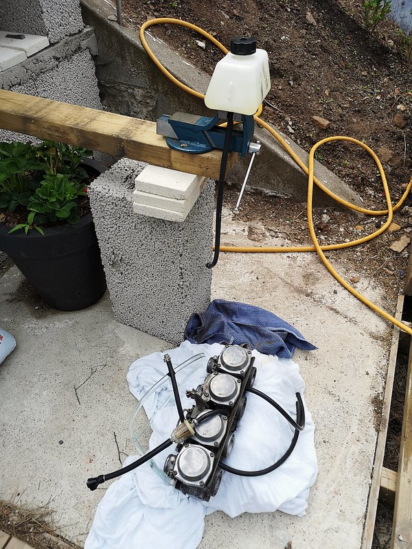

I connected a one liter gas tank to the carbs to see what was happening. The gas is pouring out of the two holes on the next picture:
IMG_20190609_125512 by Lars Krogh-Stea, on Flickr
Nothing comes out of the overflow tubes. Removed the floatbowl on the leftmost carb and the float is moving unrestricted, the needle seems fine too. The float hight might be off but I checked this when I cleaned them. I might have done the measurements wrong. I sodablasted the carbs so there is also the possibility that some passage is clogged. Does anyone know what might cause gas flowing out from the holes on the intake side? Any tips on how to go about fixing this? Is it better to measure float hight with a ruler or check with gas and clear tube and measure on the outside? These are BS34s instead of the original BS32, but they are rejetted and worked well last time I ran the bike three years ago.

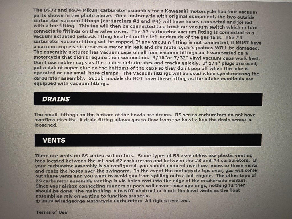

I'm learning a few things about carburettors today..
The hoses I thought were overflow-circuits are really just for venting. The reason for connecting hoses to them is so gas will flow away from the engine in case of a crash where the bike is left lying on the side. Makes more sense since they're located so high up.
The leftmost hole on the intake side is the real vent and is where gas will overflow. I guess that points to the float/needle.

I've also read page 4-5 and onwards in the workshop manual for an explanation on why gas flows from both holes, so I'm now confident I have it narrowed down to wrong float setting or some obstruction or similar problem connected to the needle not making a good enough seal to stop the gas from flowing.
The two holes in the intake on a BS carb are the air jets for the pilot circuit and the main circuit. if the floats don't close the fuel valve (float valve/needle and seat) fuel will rise until it pours out of those orifices.
In this case it is most likely that some of your valves are sticking and not closing.

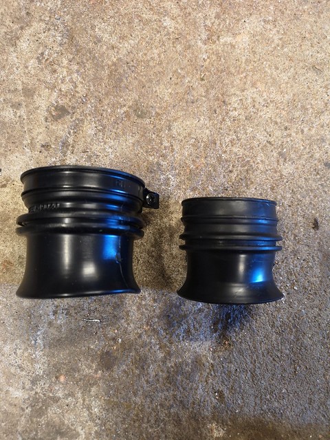

My bike is sucking in lots of unfiltered air and at the same time the intake plenum is not alowed to do its job as it's supposed to. Next picture shows one of the intake boots. It's inside diameter is about 45mm and on the carb the outside diameter is about 53mm. Not an optimal solution..
feil_muffe by Lars Krogh-Stea, on Flickr
They also don't make a particularly tight connection with the holes in the plenumbox. This is also why gas poured over my engine.. If everything was done correctly, excess fluid would flow out the boots and down the draintube in the bottom of the plenum. One less firehazard to worry about when this is corrected :) Guess the bike will run smoother as well.

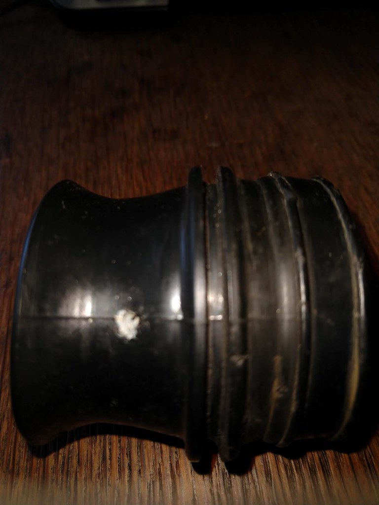

Is it possible that these are original (or repro) rubber intake boots that have hardened and shrinked over time? Watch the video with sound :o
