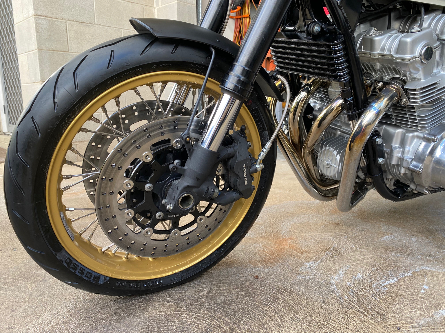

I have done the same thing on my bike, rim goes on first then the calipers, then when you remove the rim, calipers off first then rim comes out.
it should work
GL1800s require calipers (or at least one) off to get the rim off. But yes, make sure calipers mount with bleeder at top, or you are doomed forever to spongy brakes.

I have done the same thing on my bike, rim goes on first then the calipers, then when you remove the rim, calipers off first then rim comes out. View attachment 226098 it should work
That is an awesome setup, but I've set my mind on trying to make it work with the original hub/wheel. The Cognitomoto wheel is laced with all the spokes threaded from the outside of the hub. You can se it in this video;
This means that I would have to source other spokes, because the original spokes won't do. First off, the outer spokes would have the wrong angle. Secondly, a double set of inner spokes wouldn't work either, bacause, as you can see in the video, half the spokes need a longer neck at the bend to get behind the other spokes. I don't know if I explained that clearly enough, but it' in the video. The Cognito hub is by far the best solution of course, but I've set my mind on the challenge. But.. as I've said earlier; if I have to relace the wheel and figure out the dimensions for the new spokes, I will probably go the CognitoMoto route myself :)
