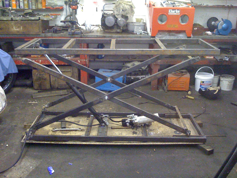

Busy day today working on the bike lift, had probs with the gemontery on the hydraulic side of things but got it sorted out in the end!
Pushed the boat out with the lifting.....I had a power pack kicking around so used that for the lift, call me lazy, but why pump it up by foot when you can push a button!!
The picture is it up in the air working, now the strip down to weld it all up and paint.

Is this your own design or a kit? Either way, nice work. Someday I'll have a lift. From the looks of your stable, you'll need more than one lift!
Welcome aboard.
Awesome Gav! I like the lift Idea...i've got a hydraulic house lift here at the shop....maybe I should get on building something like yours! Now get back to that bike!! What sort of look are you going for on this one?
Hi Swan thanks for your kind words, yes it's my own design.
I will try and get some drawings together and post them for one and all to make there own!
Hay Bruno, get on with the lift, just think how much easier it would be doing them pipes!
As for the look of the bike, cafe/bob/chop, pretty much the same as you, making up as I go along!
However I have got a couple things up my sleve.

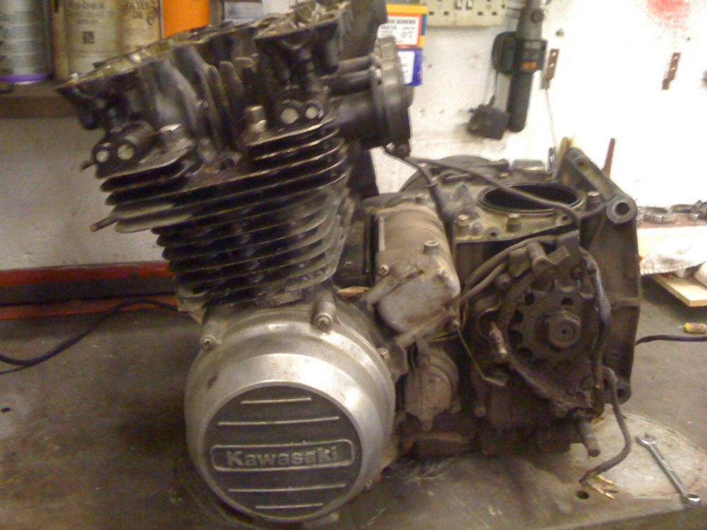

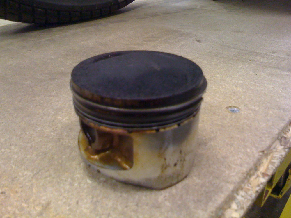

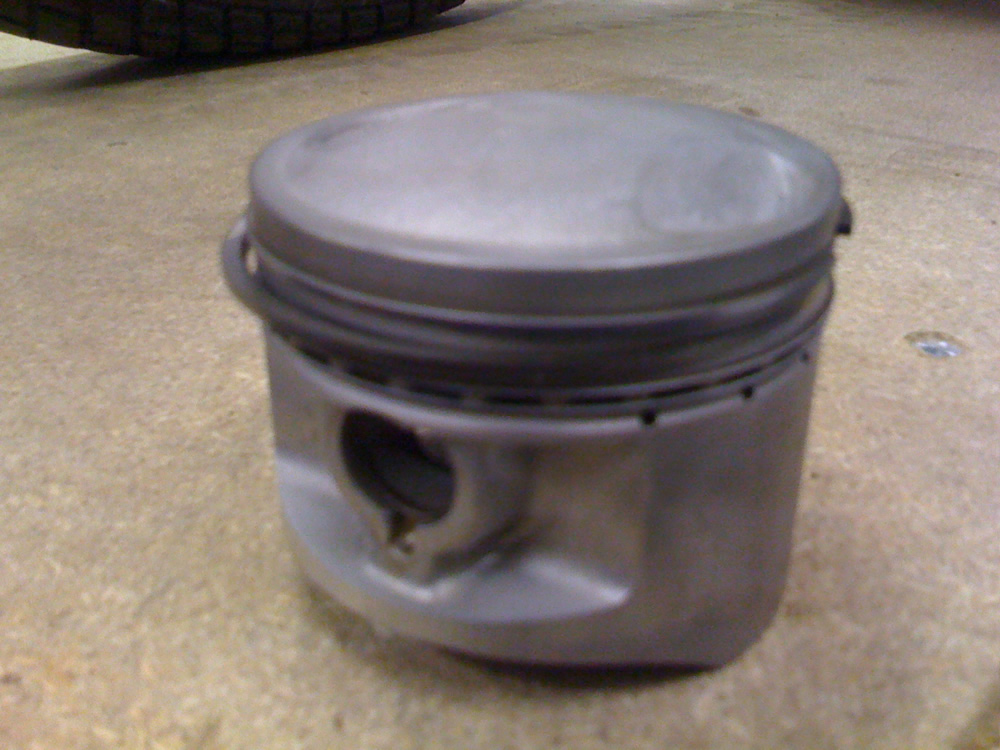

Any way managed to get the lump to bits and made a start cleaning...........so much cleaning.
Pic (1) the lump, pic (2) piston before and after (3), not very inspirational I know, but someone has to do it.
Got the head and barrels over at the local shot blasting guys as they won't fit i mine.
Should have it sprayed and back together up to and over the weekend.......I hope!!!
Keep you all posted.

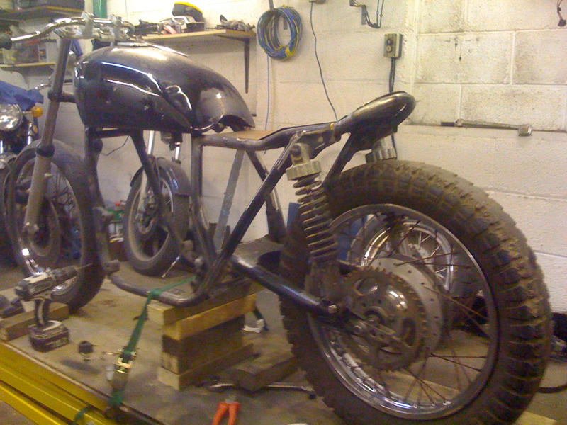

Here's my frame for what it's worth.........Ready for delugging

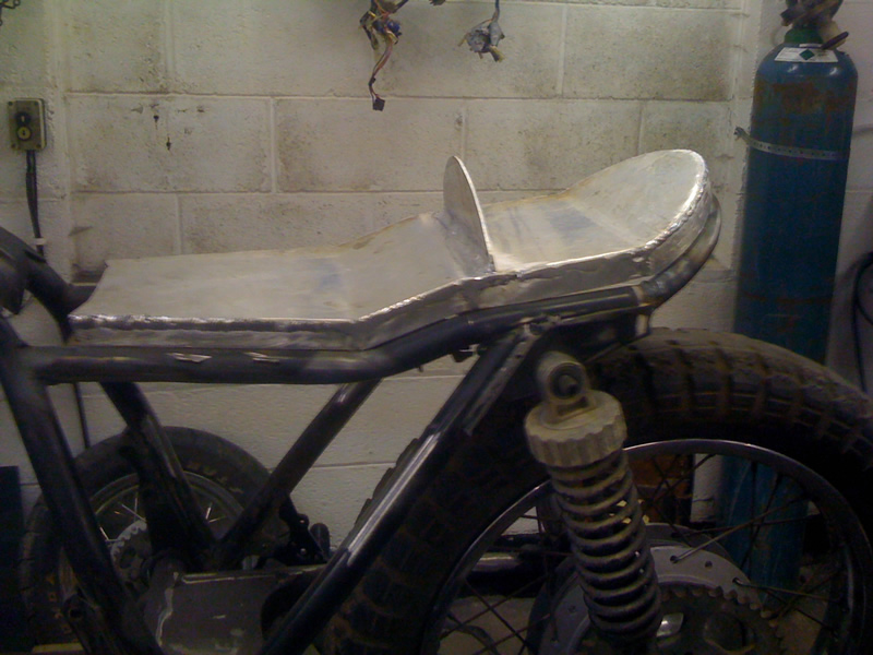

Started on the seat unit today, this is the base plate.
I've been trying to post more pics per post but the sites on letting me!
Next post more of the same.
