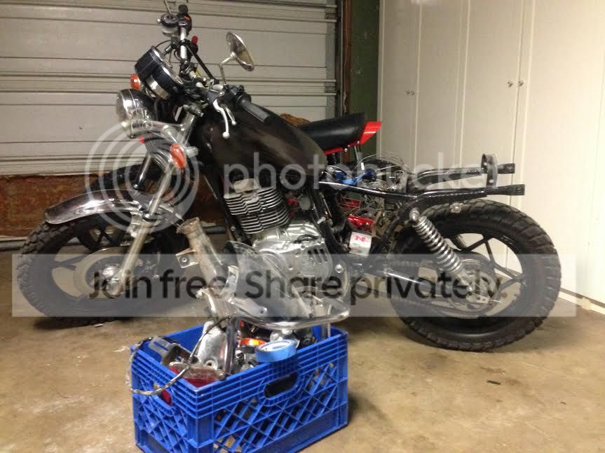

I picked up a 1981 Suzuki GN400 and am tearing into it. I picked it up and rode it 40 miles home and then put another 60ish miles or so on it in the next few days so I could figure out where I wanted to head with it. With a racing background I want something fun that handles great and I can rip around town on. Here it is when I picked it up.
After a few fun days cruising and whistling at girls, who thought I was a total goober, I tore it down.

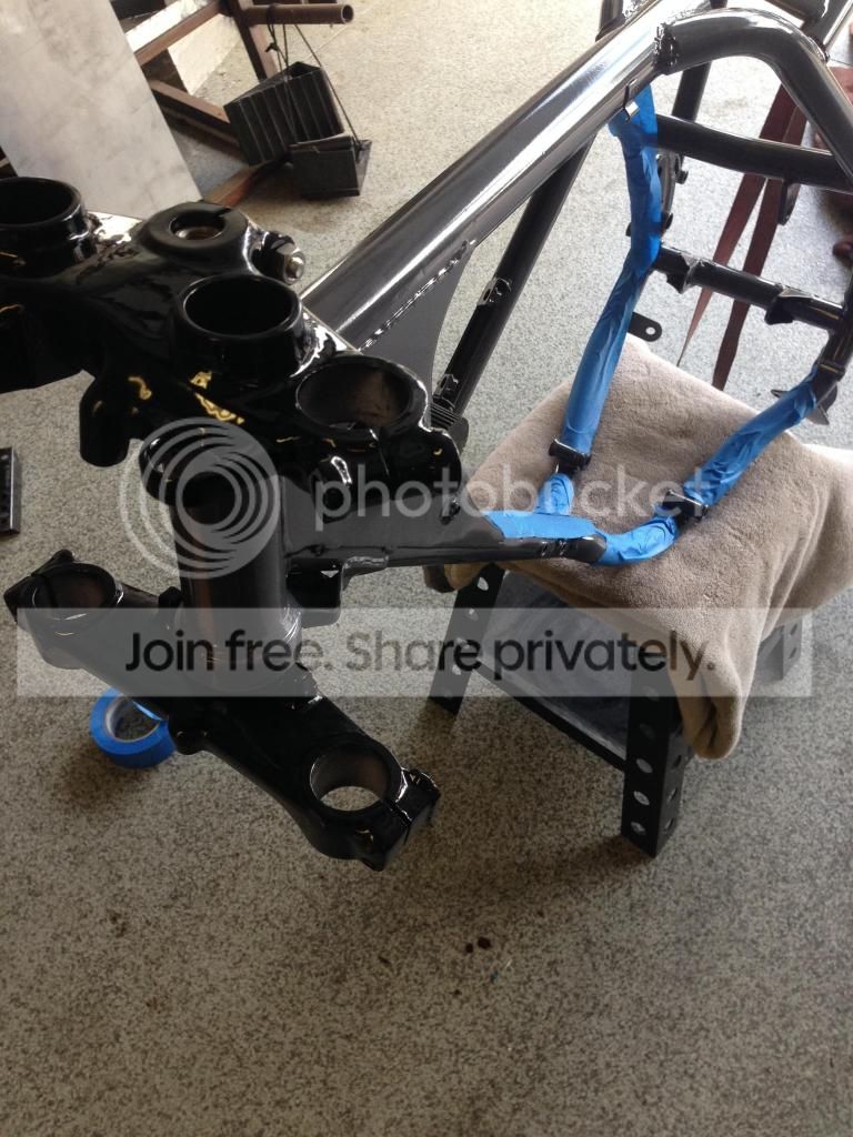

So while everything was off at powdercoat, polish and paint I tore into the motor to make sure all was well and replace all gaskets as well as do a little port and polish in the head, new piston and rings, and make sure the valves were all good.
This has all been happening over the past two weeks hence the post going up so quickly. In SoCal we haven't had much of a winter so I am trying to get this thing wrapped up quickly so I can have something to ride as the weather has been insanely nice and then start on my next build. But frame and all parts for the most part came back from plating and the reassembly begins.

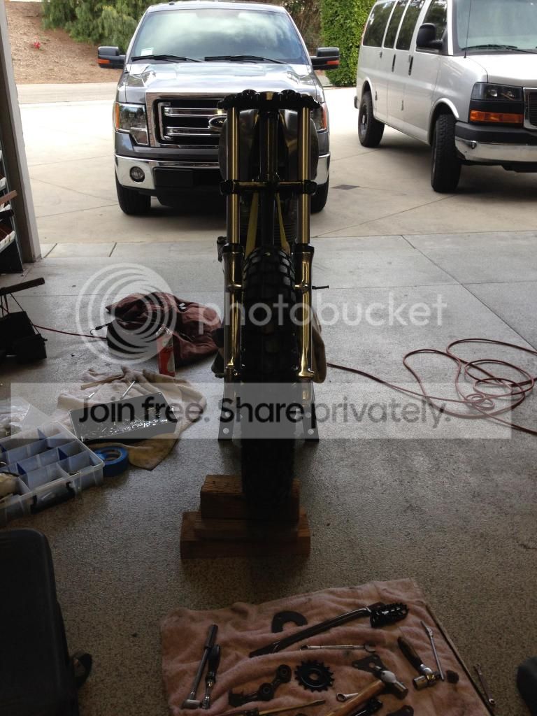

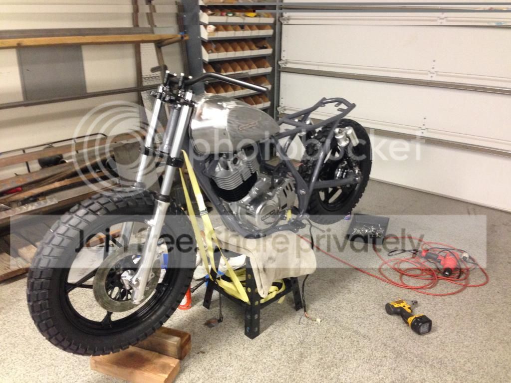

Sweet! What's the spec on the tires? Vee Rubber or Heidenau in front? What's in the back? Sizes?
Bridgestone Trail Wing TW40 Motorcycle Tire - 120/90r16 for the rear
Bridgestone Trail Wing TW40 Motorcycle Tire - 130/80r17 for the front
They both just barely squeezed in and as you can see the front has about an 1/8" on both sides. I am really excited about how it is coming together, The only major thing I have to finish is the exhaust but that should be fairly simple as it is a single!
