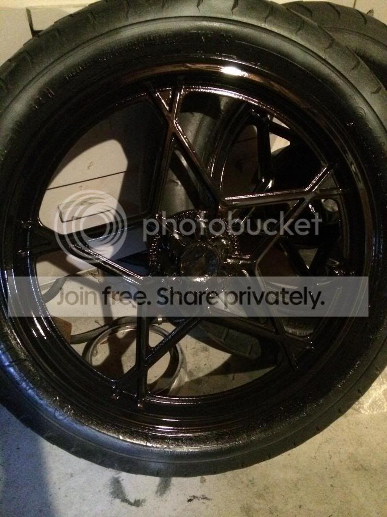

Sorry I forgot to clarify the wheel paint. I didn't mask them because they're bald and will be replaced. Thanks for the encouragement guys!
Probably should have removed the tires first then painted them. You will likely chip / marr the paint in the process so be ready with the touch-up. Not trying to be a Buzz-kill, just know what a PITA it is to change tires. It is a lot easier to put on new rubber than remove the rock hard, stuck on old ones.
PS, you do know that even though those are cast aluminum wheels and not spokers they still have a tube, right?
Double PITA!!
Yeah that would have probably been a better idea. We'l see how it goes. Those tubes are really gonna be a PITA. Thanks hoosier
