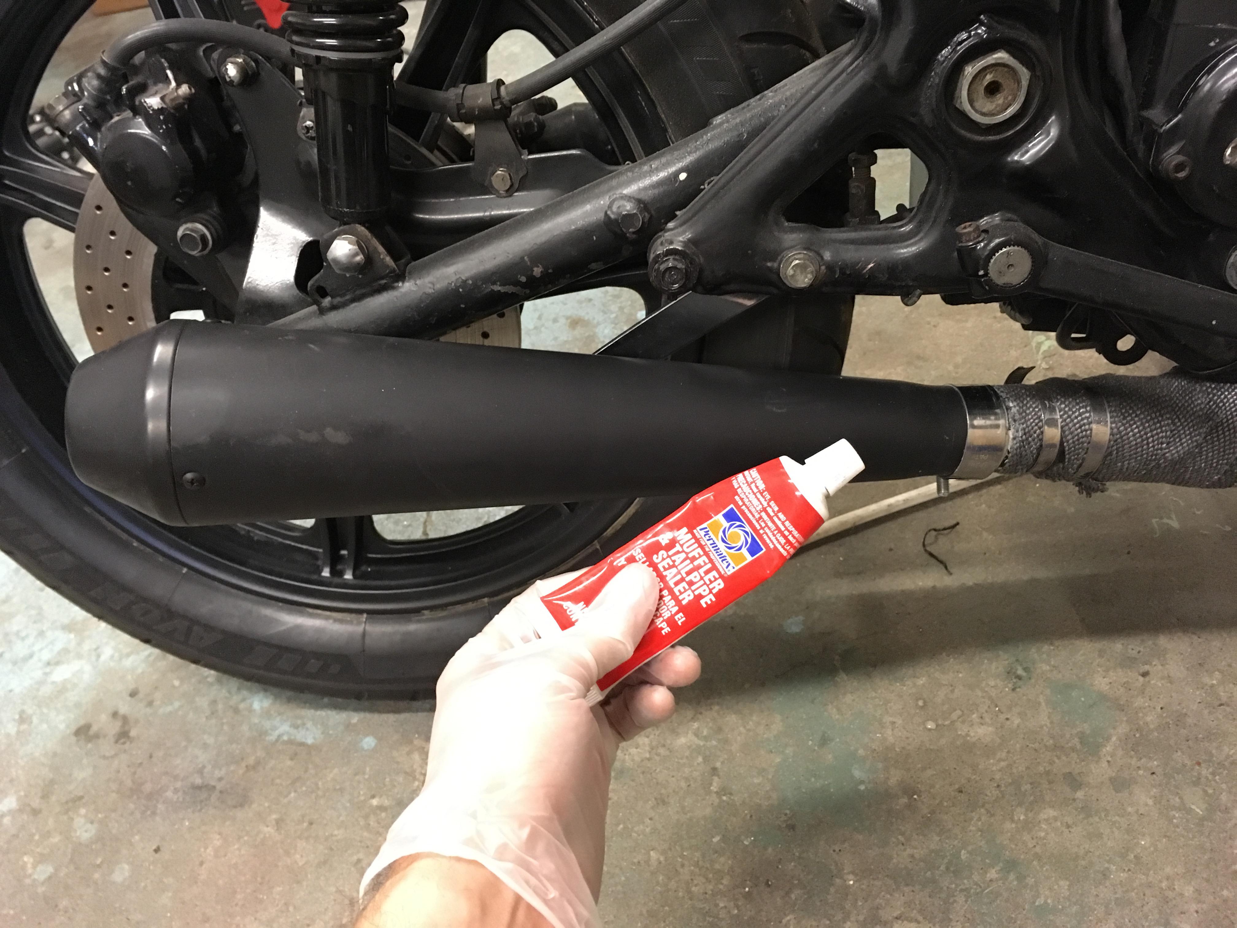

Also, with that exhaust silencer, they come from the factory with a pathetic amount of packing and it will be LOUD. I always open mine up and repack them with some good 2-stoke silencer packing (can buy from any online MX store) and pack it real tight and wrap with some wire then stuff it all back in. Ignore the science with back pressure, its super complex, just know that whenever you change something in the exhaust or intake system, you should re-jet and adjust your air screw to suit. You'll likely run lean if you dont.
You are spot on with the clamp, they are rubbish. If you dont mind the look, I highly recommend the stainless automotive style clamps - when you tighten them, they tighten around the entire circumference - see attached.
Lastly, no matter how well your fit up and clamp is, you will still end up with some tiny air leaks at the joint and this will affect your jetting. Its best if you can use a proper exhaust cement when you attach the silencer to seal things up real good :)

Yep I bought a new clamp, got the muffler actually tight now lol. Honestly I like how loud the muffler is ATM. I'll get tired of it eventually and repack it. ;D
