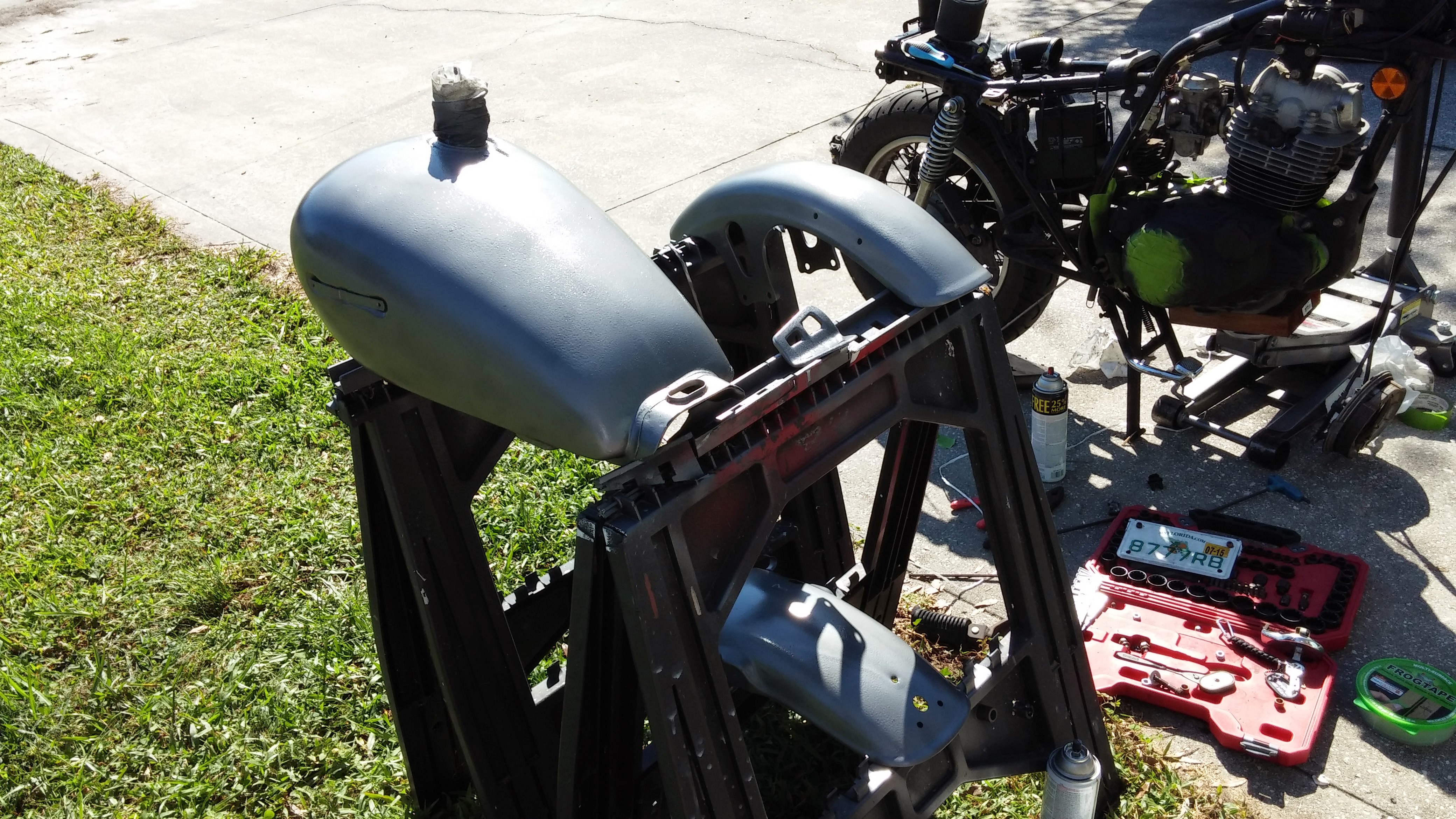

Had some time this weekend and got a little bit done... My 3-year-old son and I worked together to do a little teardown, chop and lower the fender and do a little painting. Everything came out nicely, still need to shape the fender a bit more though... My new handlebars should be in soon and I am working on bringing some old mirrors back to life. Still weighing options on a battery box, seat, and signals.

Yeah it would be pretty cool to put one in there.. I may have to look into it. I'm also in debate on my paint... Don't know if it's doing it for me
Engine looks good, could do with the cam and valve covers being black.
I have never been a fan of silver on bikes, always looks like primer at first glance.
Chopped fender looks good as well.

Thanks for all.
Great suggestion for the added black to the engine, it will pull it together much better.
I was going to go with black paint for the tank and fenders but then I figured it's so unoriginal, everyone has a black bike. Back to the planning for a nice paint scheme.
I think you should cut a little more from the F/R sides of your front fender to taper it into the side supports (so it looks more like it tapers into points). I also think it would look better with a solo seat that had the same bottom line as the tank. Maybe one that looks more like an old motocross seat? Are you thinking about constructing side panels that cover the battery and allow the air filter to stick through? It might help the overall color scheme.
I was thinking about shaping the fender a bit more to better match the shapes of the tank and engine. The stock seat will be replaced, it's funny because I was actually thinking about a motocross seat. I was also thinking of constructing my own as well. I wasn't going to go with side panels, I am planning on making a battery box but my creativity has been obscured by mild frustration right now
