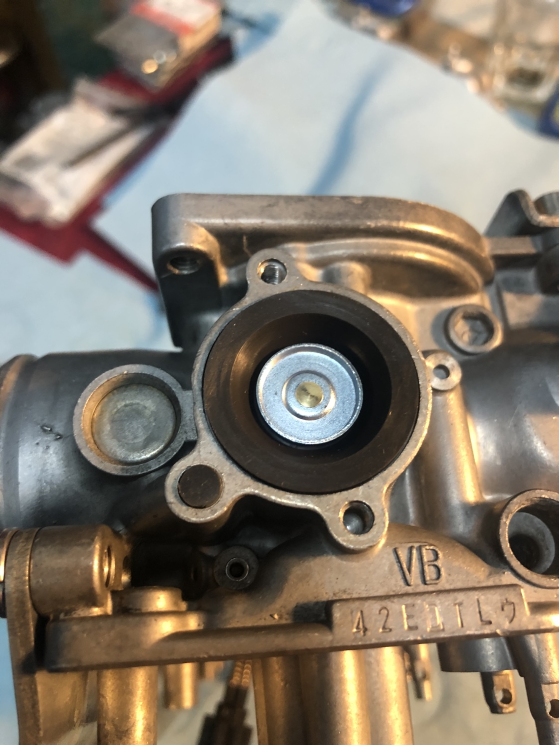

Carbs were broken down again and thoroughly cleaned and rebuilt, this time using Randakk’s gaskets and o-rings. I also deleted the air cut off diaphragm - punched out small disks out of some thin rubber and switched those out for the small o-rings. New fuel lines and inline filters, and also took the opportunity to switch out the shitty oil pressure switch (which leaked) for a new one (which, thankfully, does not).

That photo shows the air cut off delete. I punched the perfect size disc with my born-to-do-it disc puncher/sharpened petcock from some old kawa -
Getting to the diaphragm assembly on these carbs without splitting the bank is a bit of a bitch truth be told. Doable though. Having replaced the steel hardware on a previous rebuild with ss Allen bolts (with knurled heads) however definitely made accessing the covers a bit easier, and made this little tool to get at them -
Loading down the springs with small zip ties also made the rebuild slightly less of a headache -

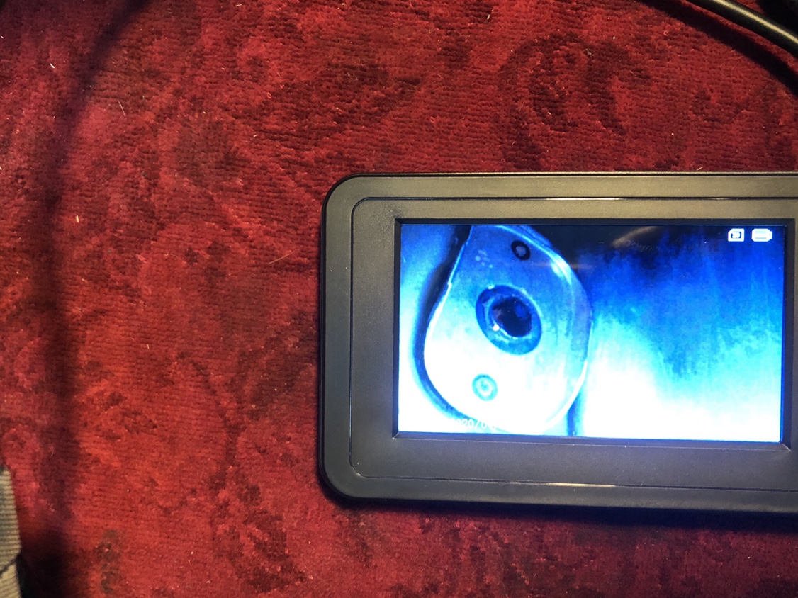

If anyone is wondering why it’s impossible to drain your CB750K gas tank via the petcock hole, here’s a pic of the inside taken with my new endoscope -
There’s a raised lip - no amount of backwards and forwards swishing is going get whatever you want out, out.
The vacuum brake bleeder tool I bought a while back however is great for the job. Just turn it on and shove the hose into the tank, sucks it all up.
It really is. I messed about with an el-cheapo wifi scope that worked for literally 2 mins before bricking itself. This one is much better, and for around $50us it’s already come in pretty useful. Literally gives you eyeballs on places you never thought possible - still can’t find that damn 10mm socket though.
