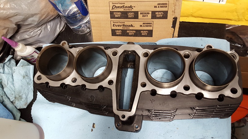

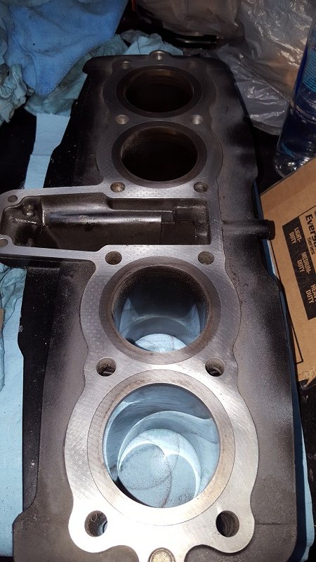

Already got some of the mating surfaces cleaned up and some parts on order.

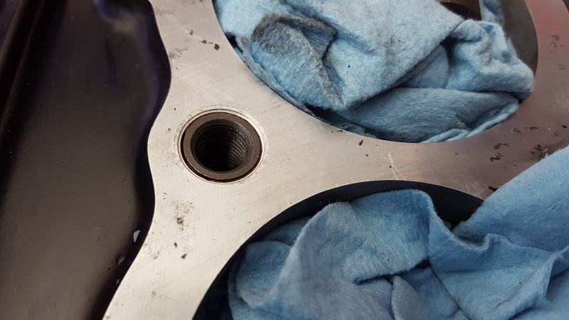

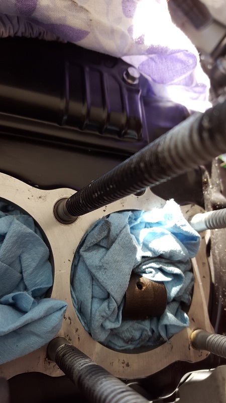

Successfully installed the Time-Sert today with the help of my wife as an extra set of hands.
I was pretty concerned about getting the hole drilled nice and square/true. Because of this, I searched around for different types of drill guides and ended up getting one of the Gator units off Amazon. It is a quality piece and I believe it really aided me in getting this install done right the first time.
https://www.biggatortools.com/products.html
My wife held the guide straight and in place for me while I carefully drilled the hole. After that, I used the guide to also start the tap to make sure it went in straight as well.
I installed a 20mm insert as advised by Genesound I believe it was. Everything ended up looking real good in the end. The stud installed is as true as any of the other existing ones.
Important Queston: When installing the stud into the case, should I use any kind of thread lock and what should it be torqued to?

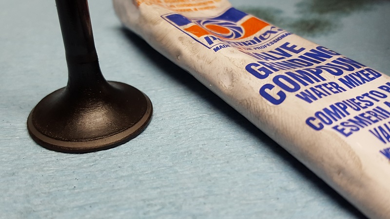

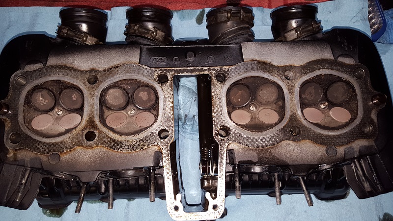

Got the valves cleaned up as best as I could. 30 years of baked on carbon and grime sure is tedious to clean. Also lapped the valves.
I also got a good straight edge and checked the head. It is perfectly square, so I'm not going to have it machined.
ben

you need a precision ground bar/straight edge to check a suface you cant do it with a ruler
feeler gauges are the only other tool needed for a quick initial assement
it almost looks like you used a scotchbrite grind/sand buffer on the head surface, please say it isn't so
as far as slapping valves it really is a hugely abused/overused process you cannot "renew" or repair valves and seats with slapping
and really it should only be done very lightly an time it is done
the concern is getting the seats overly wide we get some idea by looking at those slapped valves of yours which look awfully wide but the actual contact width should be verified with prussion blue or some kind of color witness chalk, saharpie etc can do it
did you check the valve stem to guide clearance ? it is tedious and you need a dial indicator but it is impossible to verify these critical servive specs/limits with the engine back together
now is the time ;)
You only really want to look at that stuff if you have the funds to fixit :o Otherwise, do what is nesessary to get it back on the frame and ride the pizz out of it... I will break again and you'll have another whopertunity.
If all of the valves look like that, all of the valves are ruined. No ifsands or butts they're junk. Seats probably need recut now as well.
Everyone calm down. Everything will be alright.
-- The lapping was done lightly, just to remove minor pitting. I researched this quite a bit before doing it. It is fine to do this on these valves.
-- I did use a straight edge and feeler gauges to check the head.
-- Yes, I used a scotchbrite pad to clean up the head. Nothing aggressive, just to get the remnants of the gasket off.
-- No, I didn't check the value guides. Don't have the equipment or experience with this.
I'm not doing this to build up the motor. I'm just taking care of some things while it is apart. Not trying to go overboard. Biggest expense is going to be new, upgraded cam chain tensioner and guide. Another timely find the resulted from opening the motor was the discovery of the A chain tensioner beginning to fail.
I would have rather not opened the motor, but it was necessary. I'm confident it will go back together just fine.
Ben
What was you method for lapping the valves? How wide is the face of each? How wide is the margin? How about the seats? I'm just trying to learn. Maybe I don't know as much about this stuff as I thought.
Where'd you get your precision straightedge? I been looking for a New one thought maybe you could help me out.
