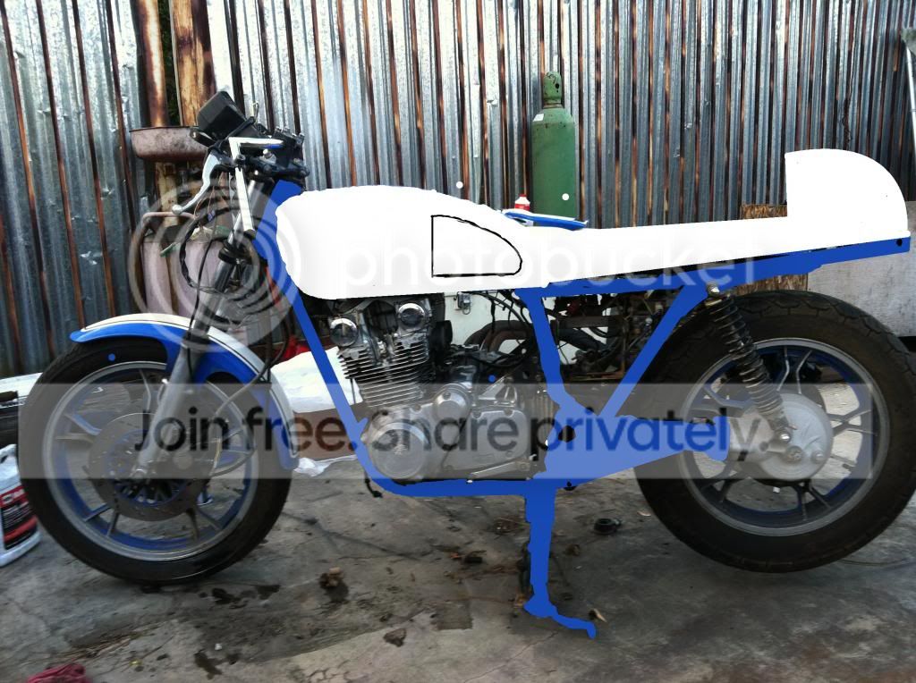

I know, not too much of a good start for a cafe bike but its what I have. So, take a seat and enjoy the show. Recently, I've just been doing regular maintenance like oil, brakes, carb cleaning, etc. I am waiting on parts for G&S Suzuki (intake boots, kinda important) and after a few more tweaks I will be ready to fire it up and get going with the project.

Seat, tank, fender mockup
Some mock ups when I was bored and it was raining.
(So what do you guys think? If I go all out, I may paint the frame the same color as is on the tank now or close enough.. Or, may just leave it black. I know the seatpan is wayyyy too long, I just did it to cover up the frame/locking mechanism)
