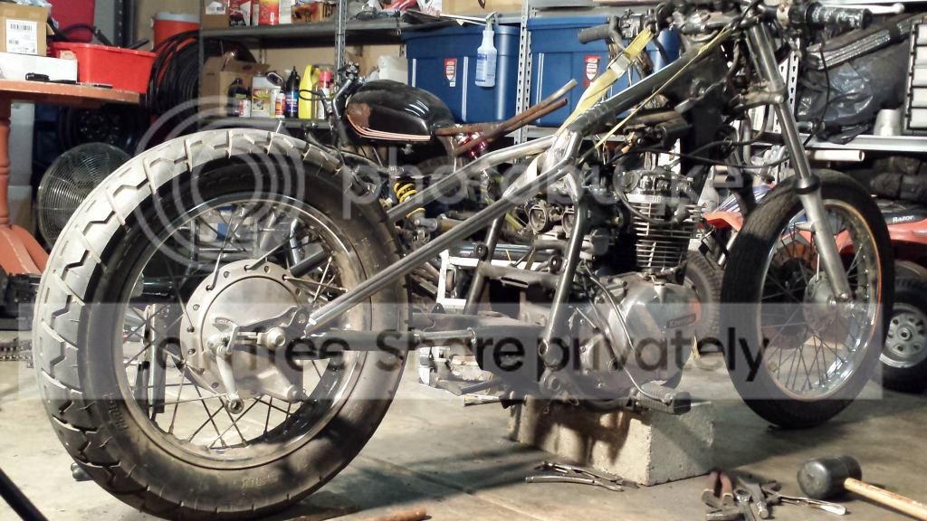

Hey DTT fellas!!! Ever since I finished the cb360 cafe can be seen here ▬▬▬▬▬►http://www.dotheton.com/forum/index.php?topic=59889.msg706996#msg706996

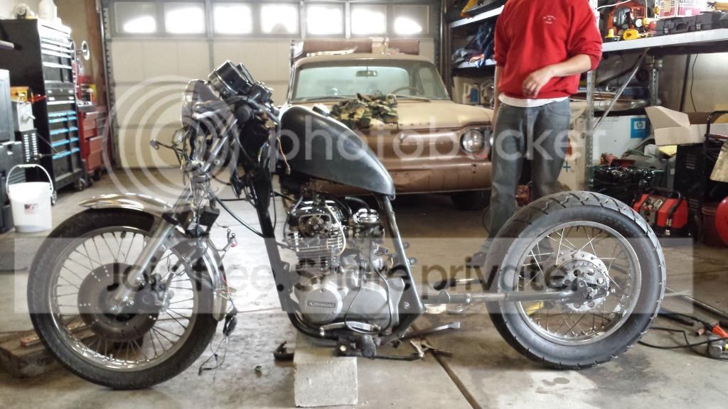

◄▬▬▬▬▬ I been wanting to do a chopper/bobber. Opportunity struck when my buddy came across came across a KZ that has been already recieved the "bobber" treatment by previous owner, voila perfect candidate for a hardtail!!!
Here are some pictures!

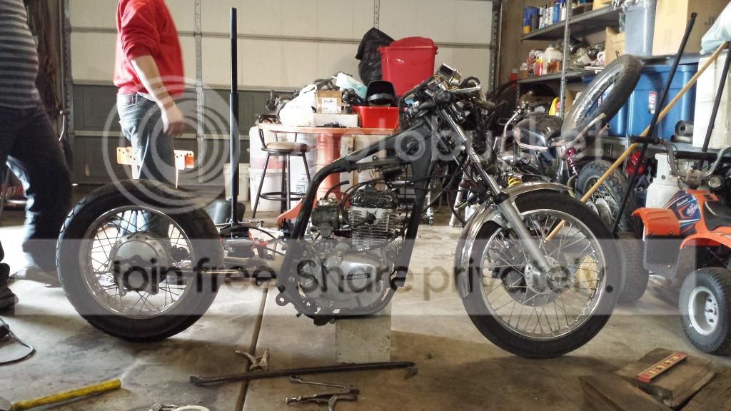

Original bobber state as i first laid eyes on it in all its glory!
The strip down

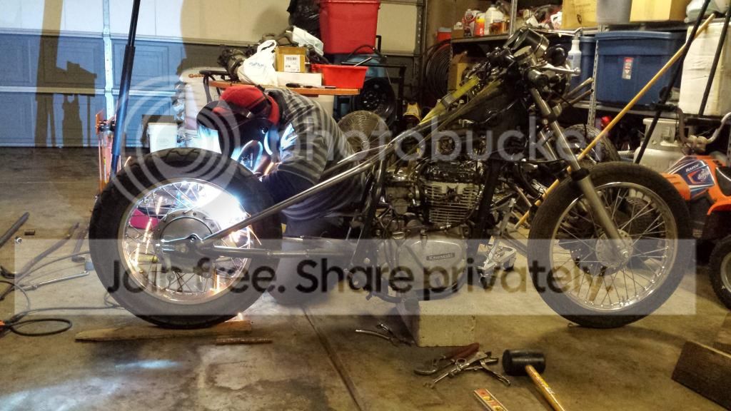

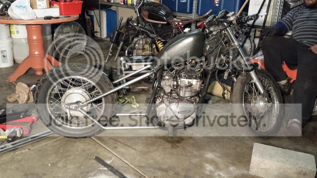

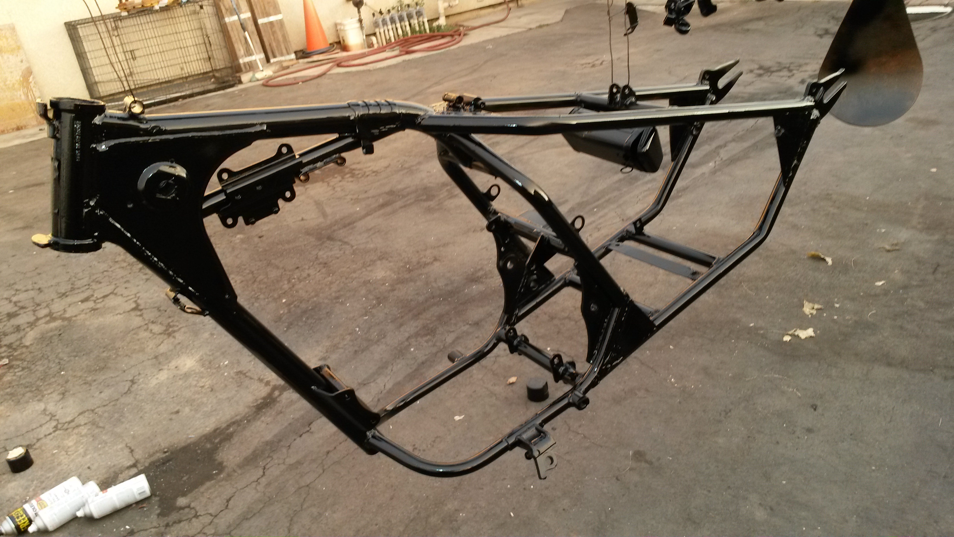

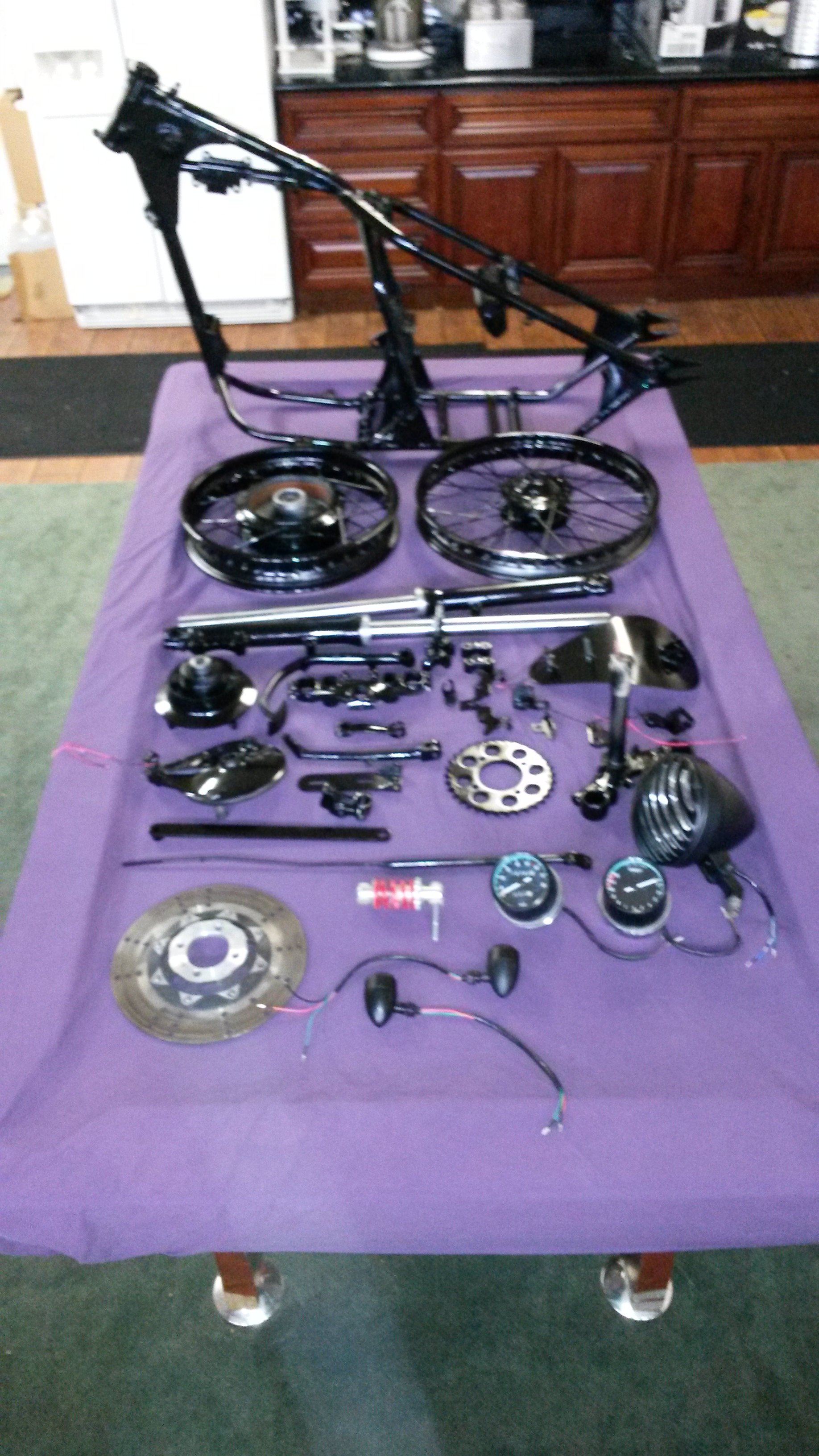

Got lots done today
Finished all the fabricating stripped down for paint now just waiting for paint to dry

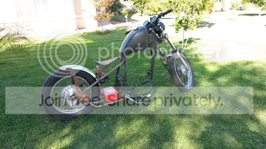

I like it.
You had me worried with the swingarm still on it there for a minute.
How much clearance do you have on the brake lever? Looks like right hand turns while braking could be a little tricky....
Loving this build man, don't see too many of them chopper bobber doodad types 'round here. Refreshing!
SONIC. said:
I like it.
Yea you're right the brake lever is pretty low at the moment, i went with a 110/90-16 rear tire and when i built the frame it had a 120/90-16 on it so that lowered the bike a bit and the forks are dropped right now. Im thinking of going to a taller rear tire

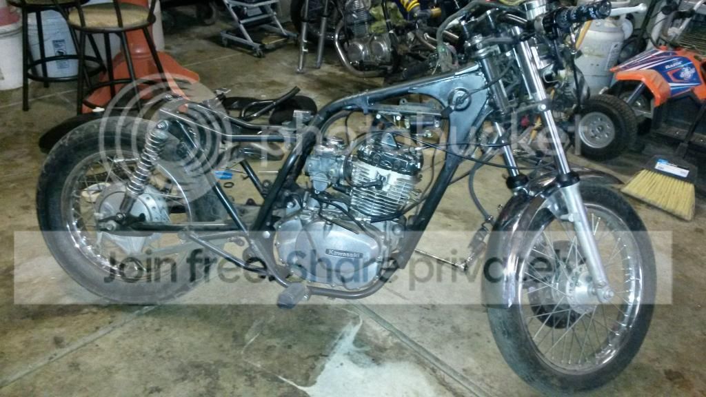

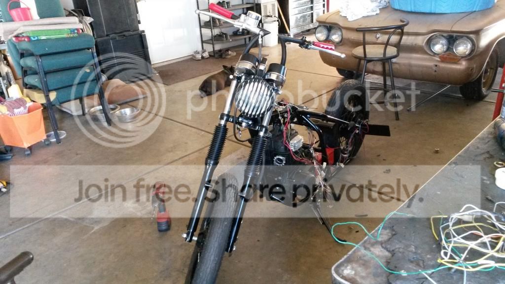

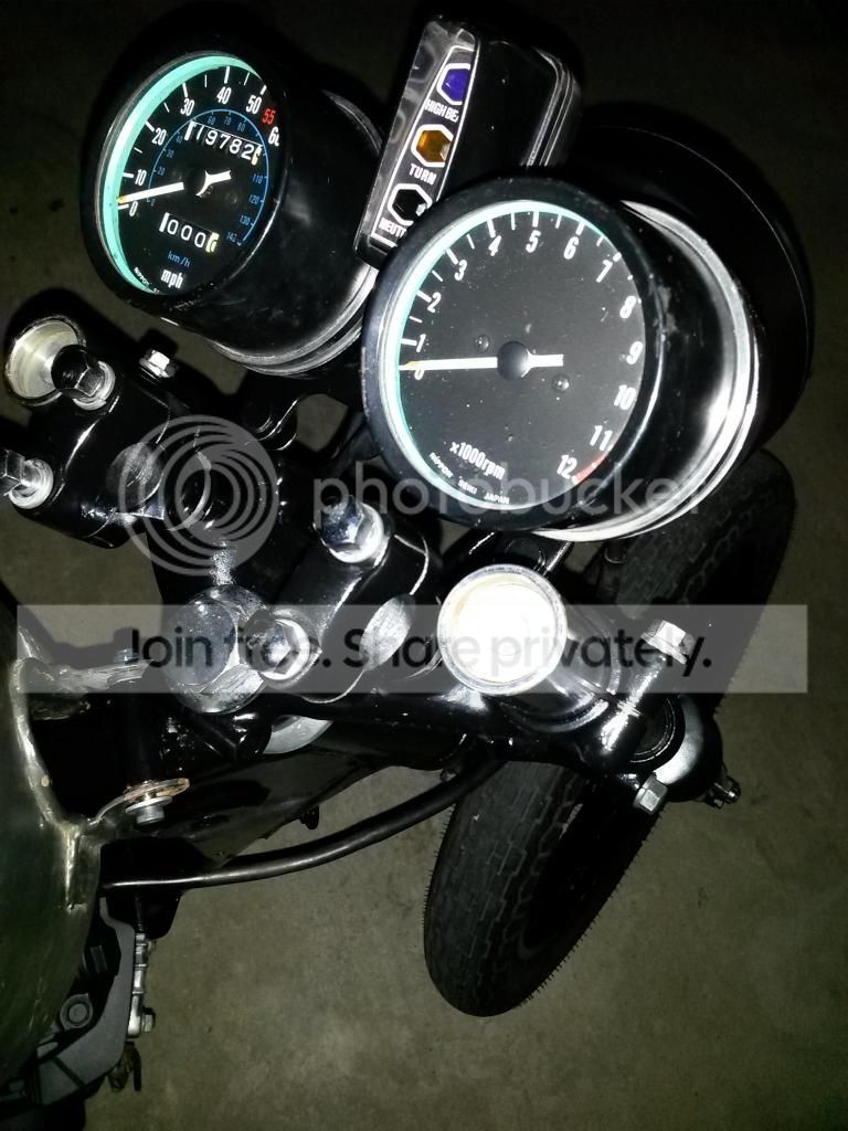

Started the wiring last night, hopefully have it all done this Saturday...
Im going to be running the stock speedometer and tachometer although i got rid if the bulky stock pilot lights and added the cb360 hi beam/turn/neutral lights fits pretty well and matches the rest of the cluster
Also thinking about going to rigid seat, this seat pan is a little too close to the tank riding might be awkward
