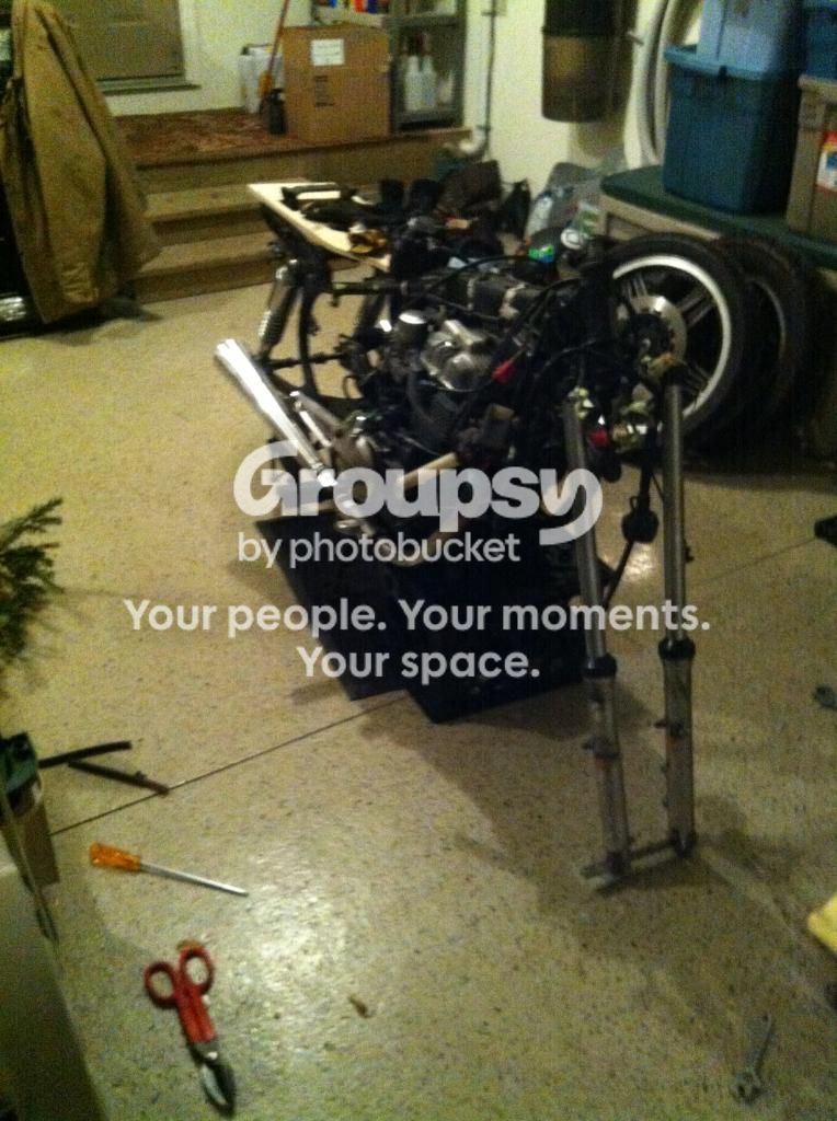

started tearing the back end off it
and the front headlight and gauges

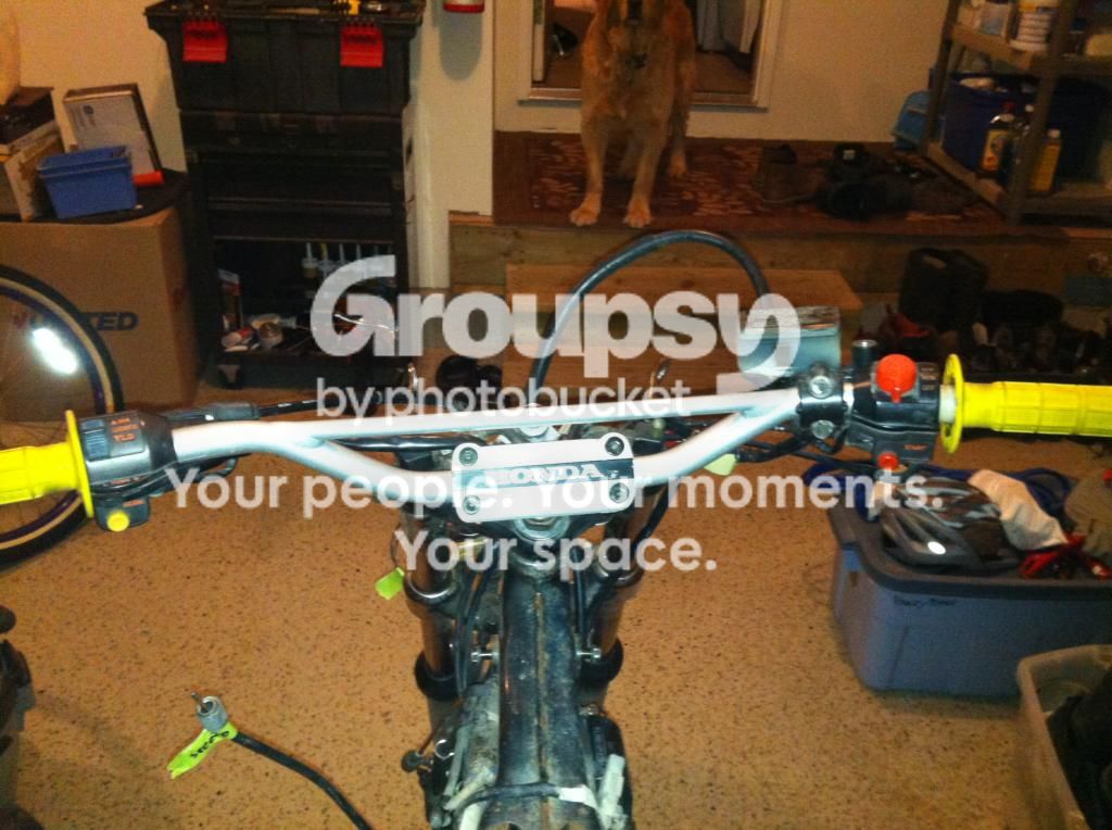

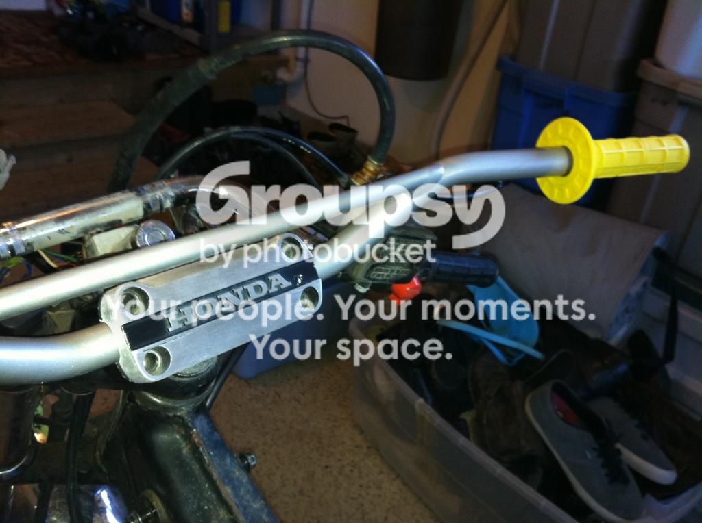

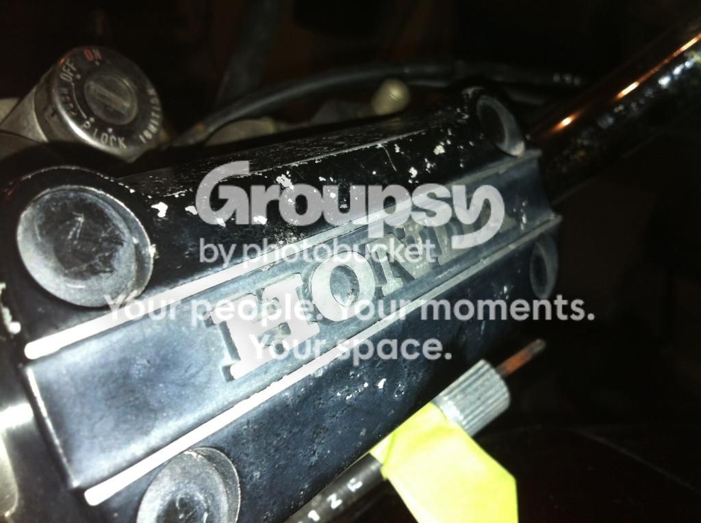

bought some cheap bars today from a local shop kind of the tracker look im going for, ill probably replace them and the grips too eventually, thought i would start sanding the handlebar clamp tooand see how it turns out as im also planning on sanding down the tank and leaving it steel with a clearcoat.
before with the old bar clamps
and the sanded clamp with the new bars and grips
look a little crooked to me but theyll be replaced eventually

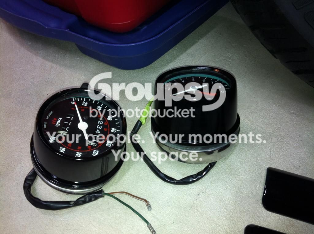

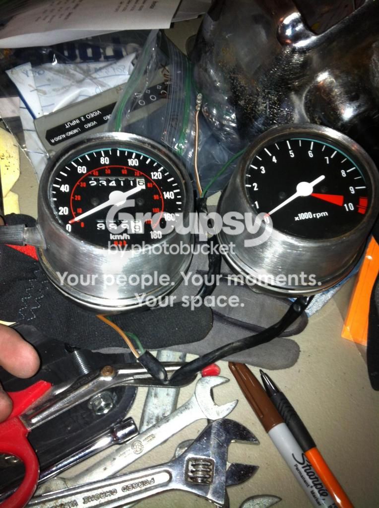

i sanded up my speedo and tach too, i like the looks of the brushed steel, i think i might just leave them too to match the tank when its stripped and just shoot a clearcoat on it

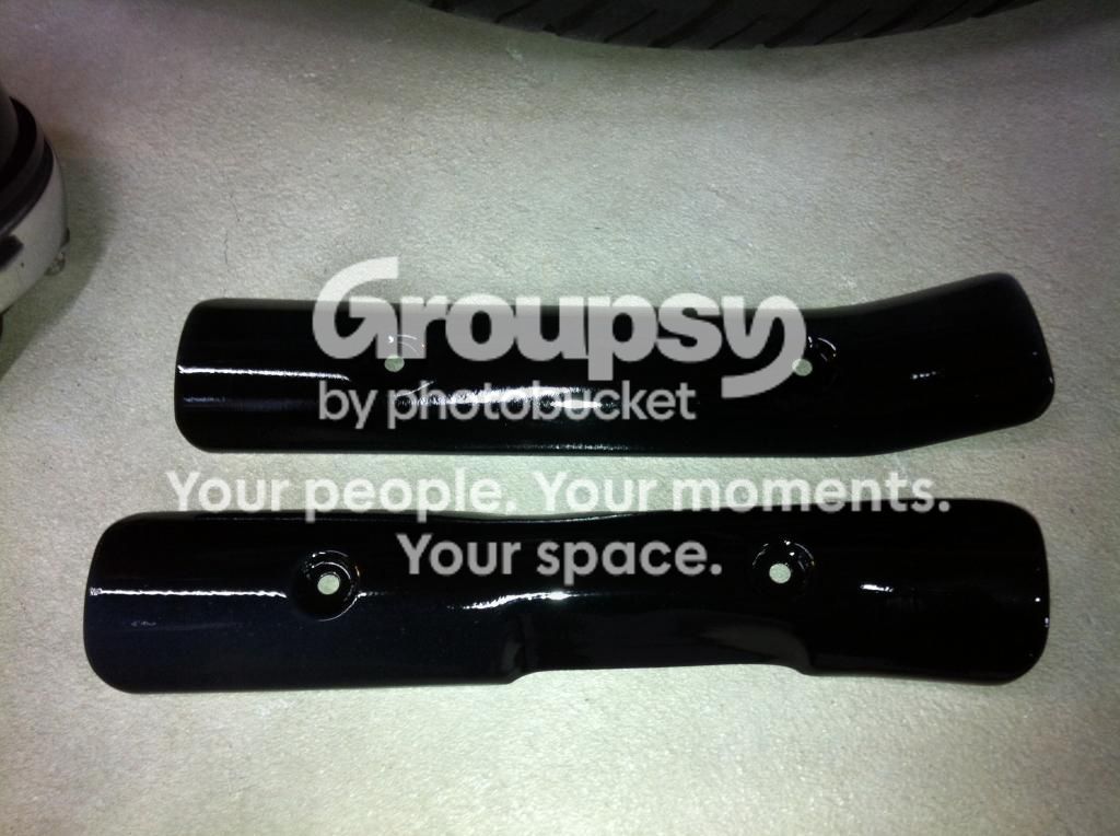

and exhaust covers too, coated it with high heat engine enamel i guess ill find out how it holds up angainst the exhaust heat it looks better than the spotty chrome that was on there though

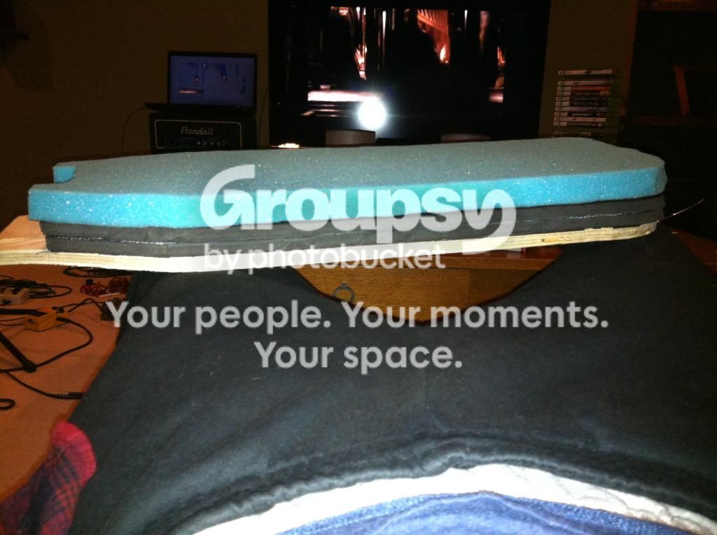

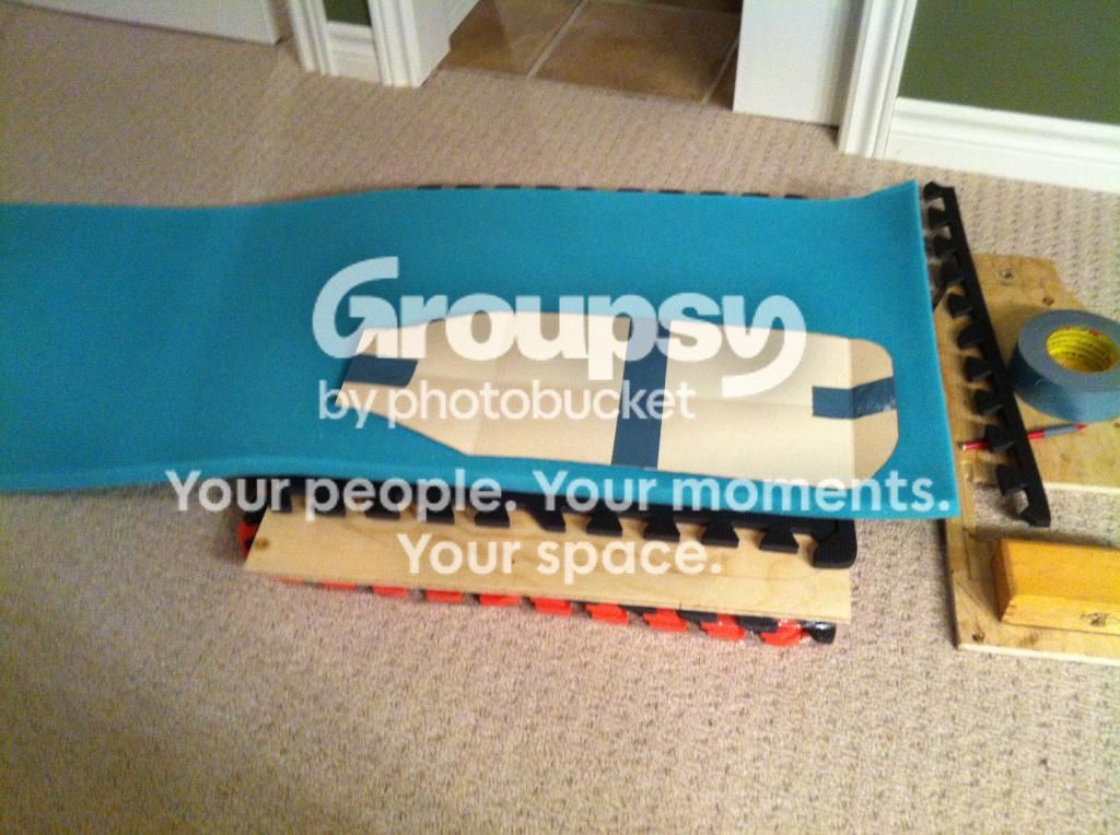

and then on making the seat, i got some foam from walmart and some of those foam floor tiles as well and glued them on to the wooden seat pan
trying to weigh it down to make the glue stick
i cut out the floor tile layers but left the top foam layer to keep a little but of protection over the metal frame, the plan is for it to slip on top of the frame and line up so its barely noticeable
it lined up really nice and feels good, although im still looking for ways to fasten it to the frame itself and maybe how to reinforce it at all if anyone has any suggestions?

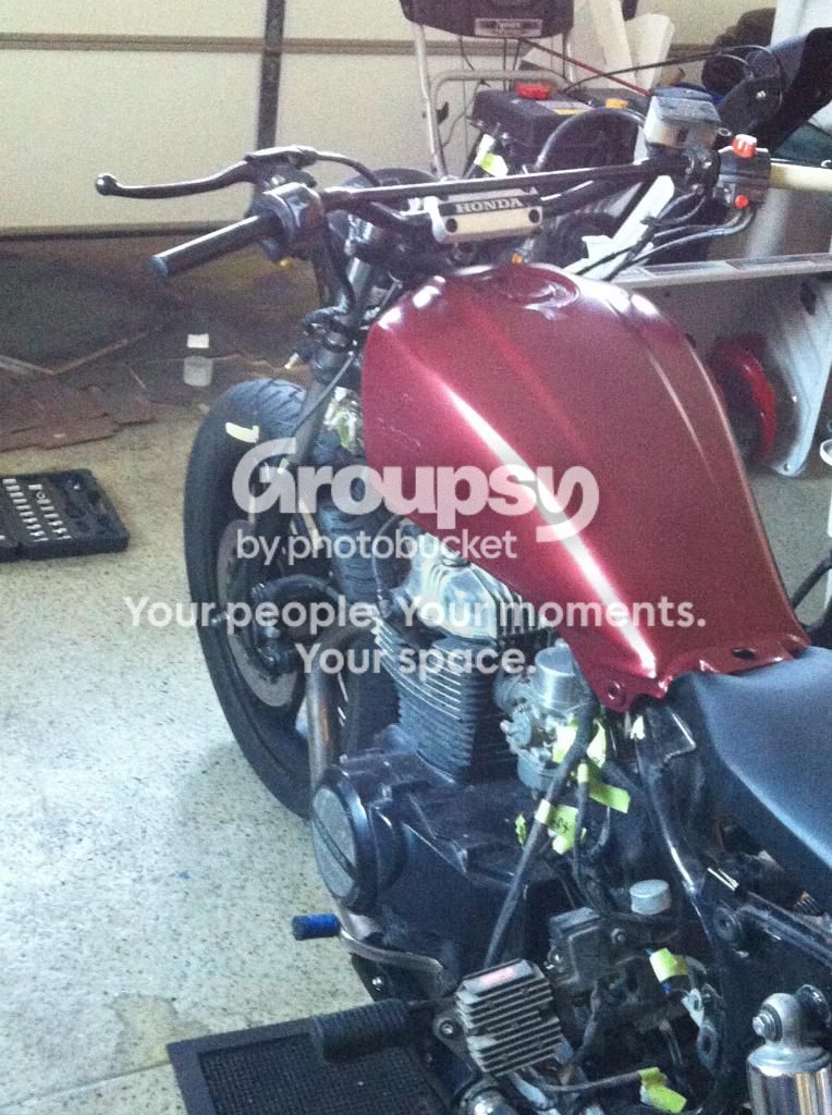

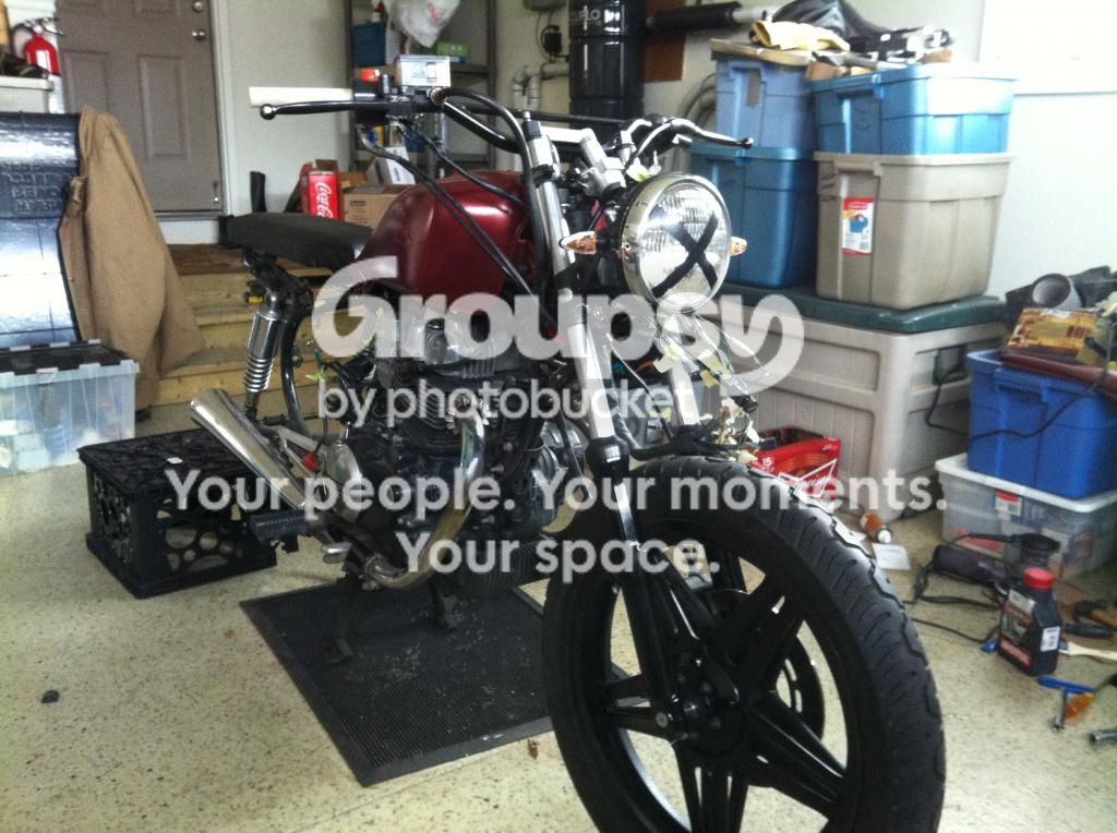

And now that the Forks, Front wheel, and headlight casing is painted i decided to reassemble the front end, I picked up some after market blinkers to look a little more sleek, its starting to come together now with everything and having the forks lowered, tank is repainted again back to a dark cherry red colour although I AM NEVER SATISFIED!!!! :o i had planned to do some black designs over top but we'll see how far i get before deciding to strip it down again
Of course gotta have the black tape for no apparent reason :P its purpose is limited now but maybe when its back on the road it'll do more than hold the headlight in place, new headlight brackets from ebay, stille want to puit some fork bnoots on it to really make it look mean, but as it stands now here it is
Cool! I love the way you made your seat. I've been thinking about different foam types. I am going to have to try that. Have you tried sitting on the seat for any length of time? How well does that foam handle your weight? Any pressure points on the edges at all?
Hey thanks man, I haven't actually got to road test it yet, its more of a mock-up at this point, being plywood its fairly flexible but I only weigh a whopping 140lbs so it seems to be able to hold my weight alright although I could see it cracking on a big bump if you were to just let your weight sink into it. I'm going to put a steel plate across it to reinforce it and put some screws from the frame to give it some added support, ill definitely put some pictures of now it turns out

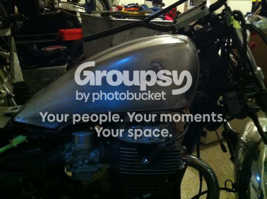

also I picked up a new tank today, i found it on Kijiji for $15 !!!!! if anybody can identify it thatd be awesome as im not sure what it is but its definitely gunna need a new coat of paint, but as ugly as it is on the outside it is literally flawless on the inside which is really nice, its also going to need some modificationt to fit on the frame if anyone has any suggestions, heres a pic i snapped today

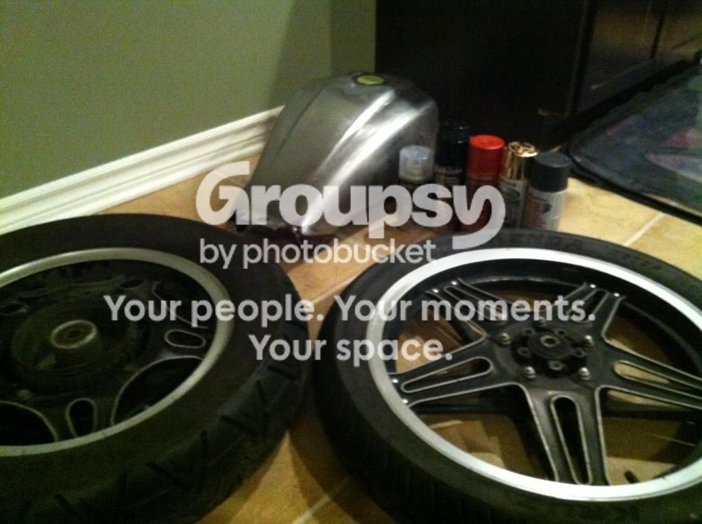

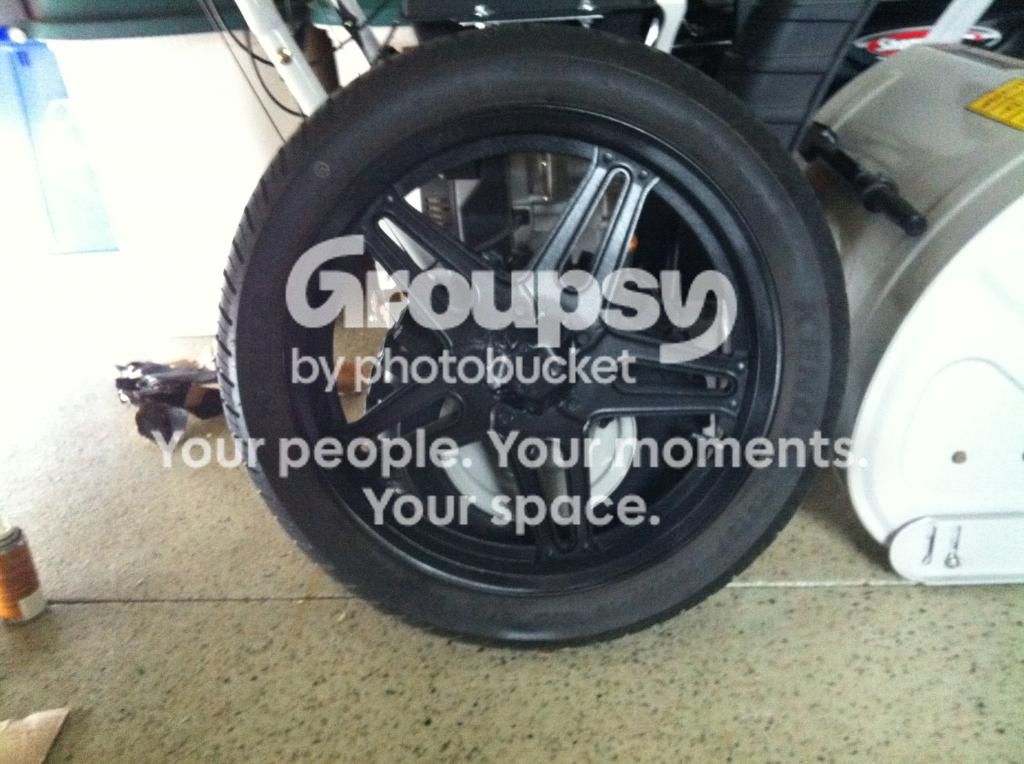

Finished painting the back wheel and mounting it back up, its all coming back together now its nice to be able to start putting it back together again, still waiting on number plates to cover the airbox, but for now i have a few mock ups of how it could potentially end up
i love the tank! on my bike when swapping on a CB360 tank i cut the pegs and rubbers in half, then had to pound the left side of the tank in to clear the frame where it curves out, comes out more on the left then it does on the right

yeah I agree, i started sanding it down today and made sure to tape of the stripes to save them ;) although the tanks previous owner did a pretty terrible job when he taped them off to be painted so theres already some black paint on them
leucadiasycledesigns said:
Looks like fun! I like that tank a lot did you figure out what it is from?
Im not 100% sure , the only pictures ive seen come up on google images when I search 1978 Honda cb400t theres a boxier version with a stripe across the top, then only one or two pictures of bikes with this tank, i dunno if maybe its a canadian manufacturer difference or something? not sure
