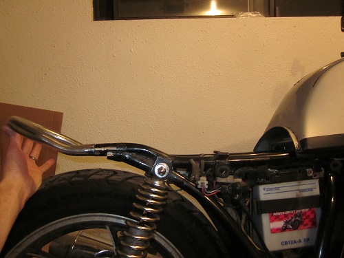

I can't decide if i want to do euro/super bars or clubmans/clip ons, I guess I will have to finish the seat and see what will look the best. This is where I am currently at with it and how I'm welding the frame loop to the frame. I lathed some plugs to fit the inside diameter of the two pipes.
