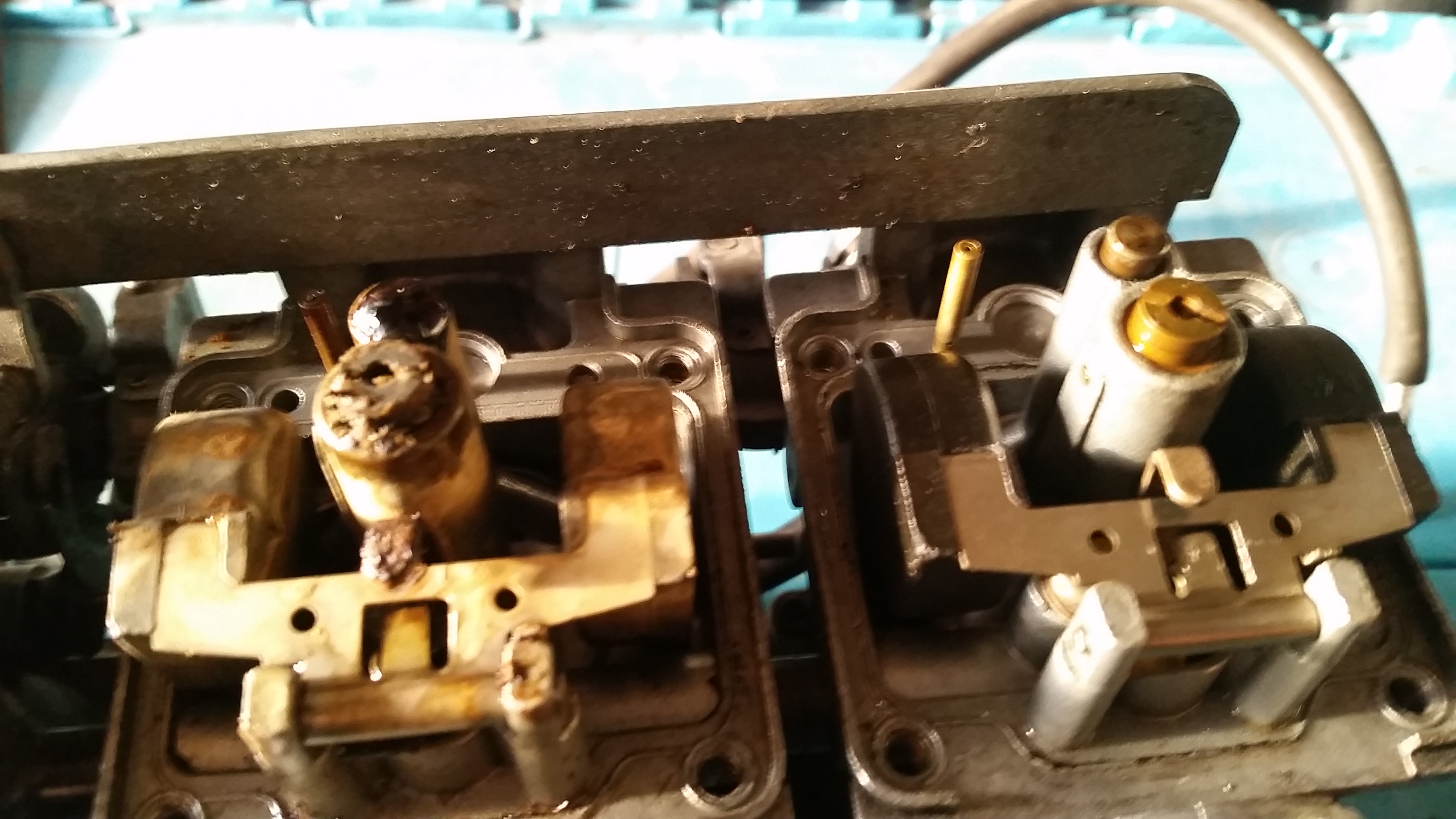

Cleaned out the carbs and figured out the wiring and temporarily rigged stuff to start the engine ... it fired up!

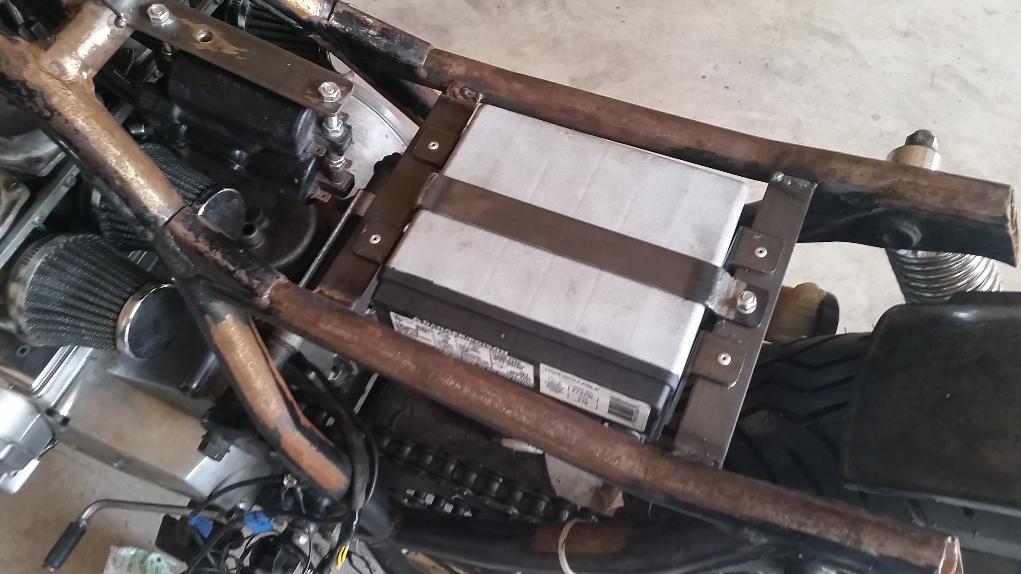

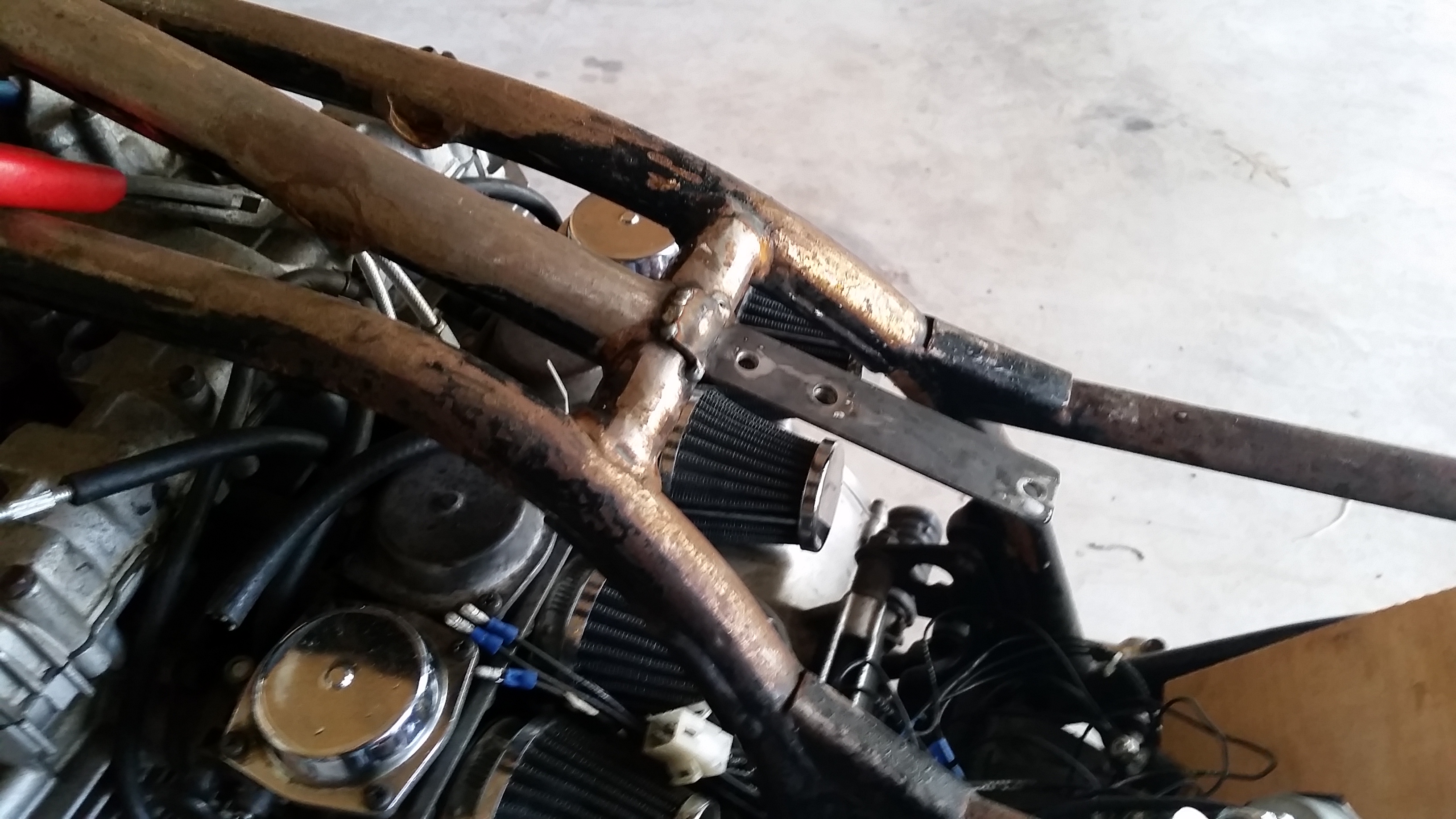

All the mounting tabs and brackets had been cut off as well as the frame behind the rear shock mounts. everything has to be fabricated. Mounted the tank and coil packs using one bracket off of the center and ran the wires forward to the plugs. Made a battery bracket under seat.

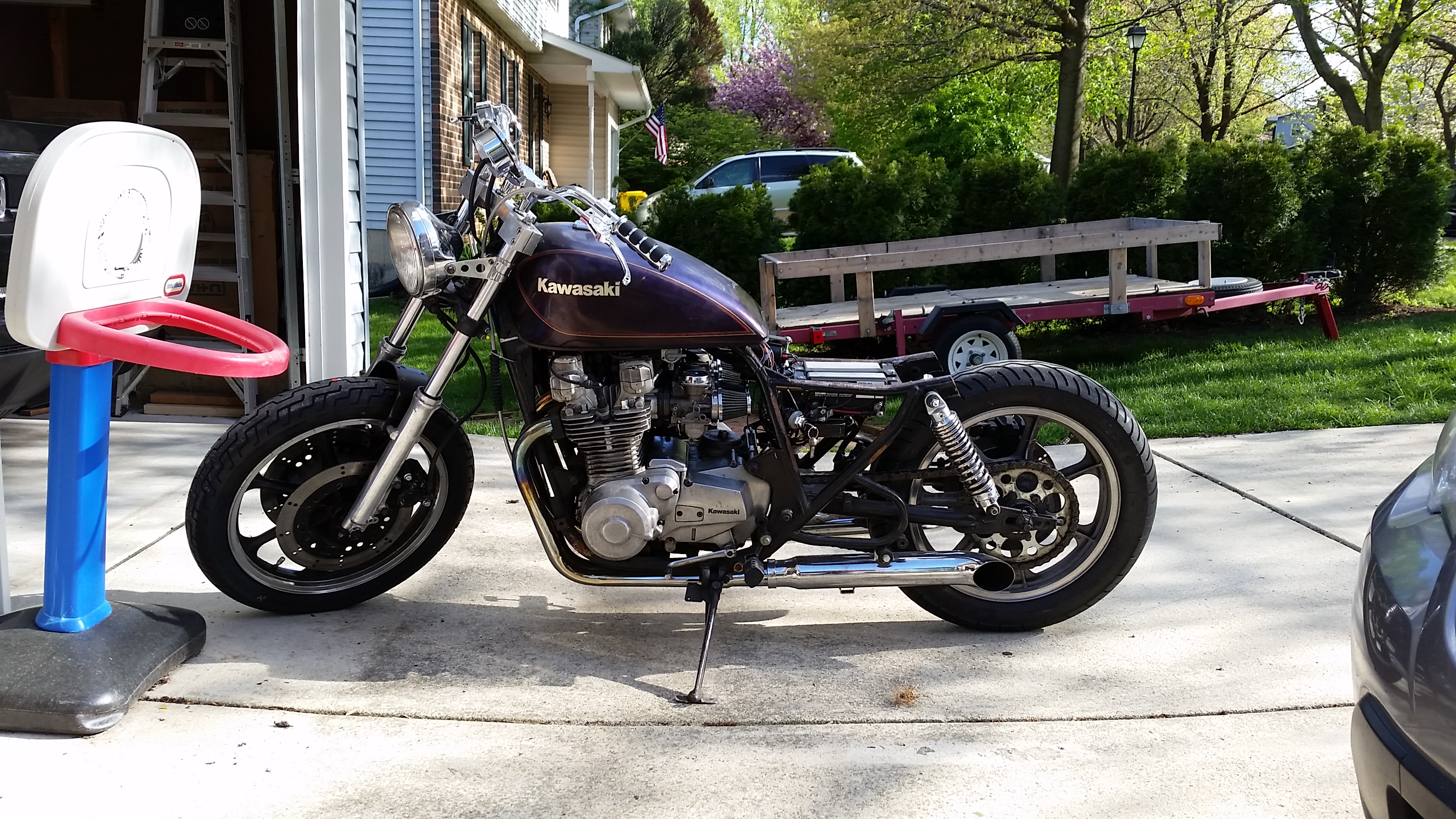

Had to rebuild/clean all the brake calipers as they were seized. Cleaned out the rust and was finally able to roll her out. Engine runs on choke, dies when not.

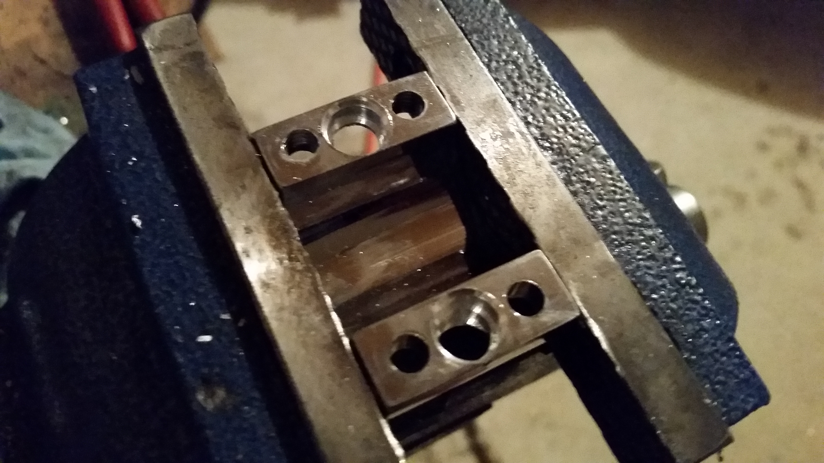

Also, modified the hand control clamps with momentary switches for the signals, horn and maybe a kill switch or headlight dip circuit (haven't decided yet). I could've gotten the clamps from the manufacturer, but they were $250 for the pair. Upon looking at pics and what I had with me, I got sub-mini switches from Radioshack and was able to get a similar result. Ofcourse not as neat, but with no machine shop handy and only basic tools, I'm pretty happy with the way they turned out.
The bike came with 1" Harley spec handlebar/controls and a Dakota Digital Gauge, got that working too ... it's been a pain in the a** finding 1" handlebar control stuff that isn't for a Harley.
