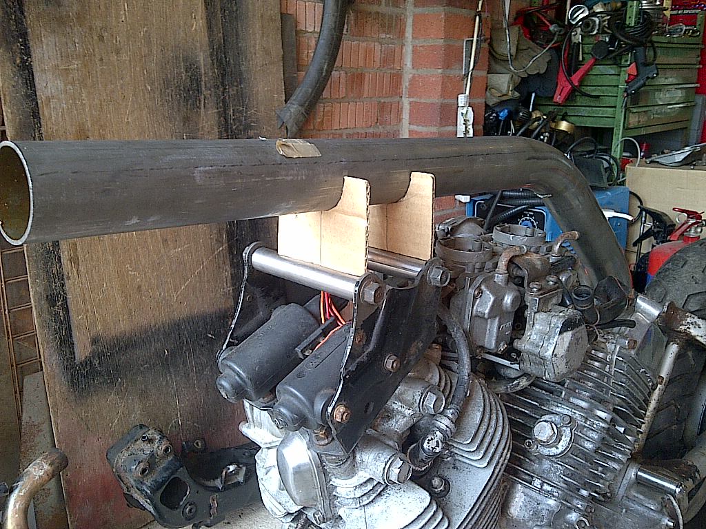

Next step is to drill the frame tube and mount to the engine.
My plan is to sort the headstock out after I've mounted the frame tube to the rest of the chassis...........

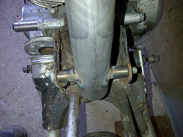

I've welded the backbone to the bush, although as my MIG is only 110amps I may have to get the joint re-welded. I've moved the frame slightly higher than my mock-ups as this will allow me to use pancake filters if I need to retain the original carbs.
This build isn't a carefully planned out project, more of a trial and error, suck it and see piece of work. But hey isn't that the beauty of garage built bikes...... :D

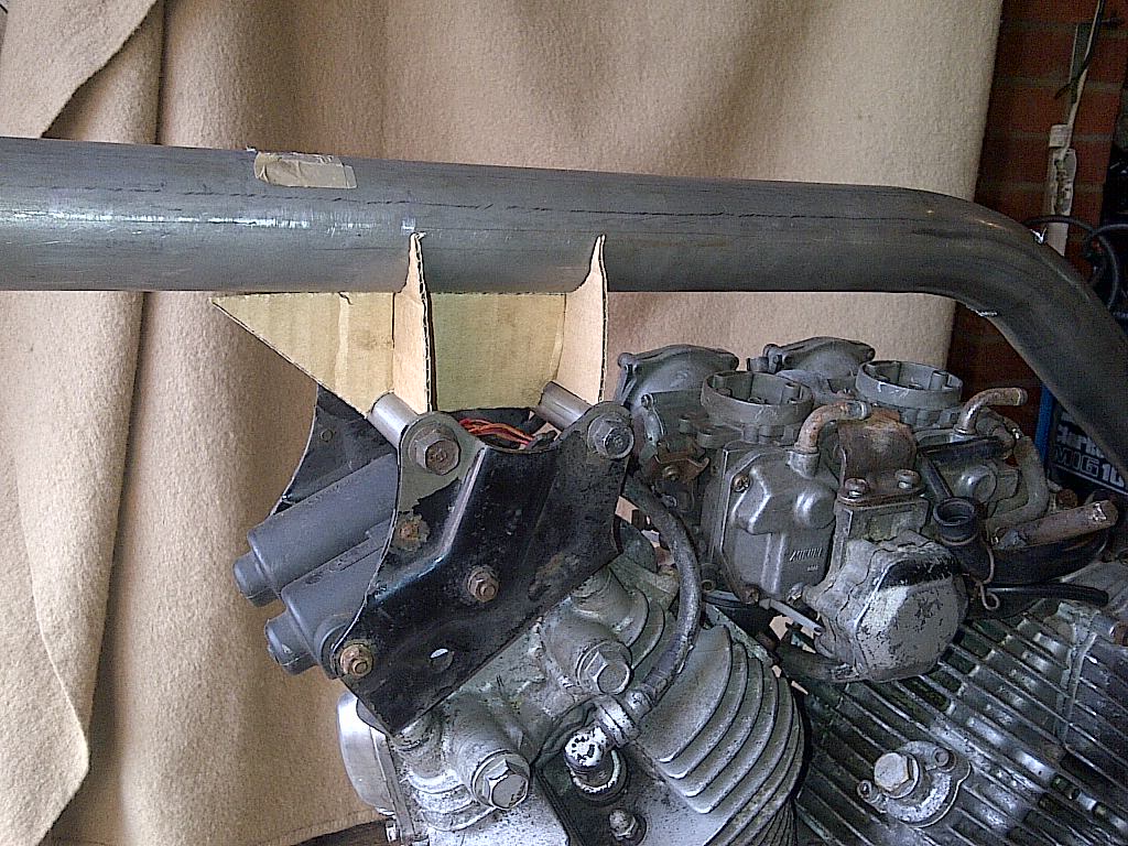

Found some time today to get into the garage. I've made some cardboard templates for the front frame mounting and did a mock up with the fuel tank (no idea what it's from) which cost me £16.

Not sure about the tank, maybe too small, once I get the front end on I'll be able to judge it better.
