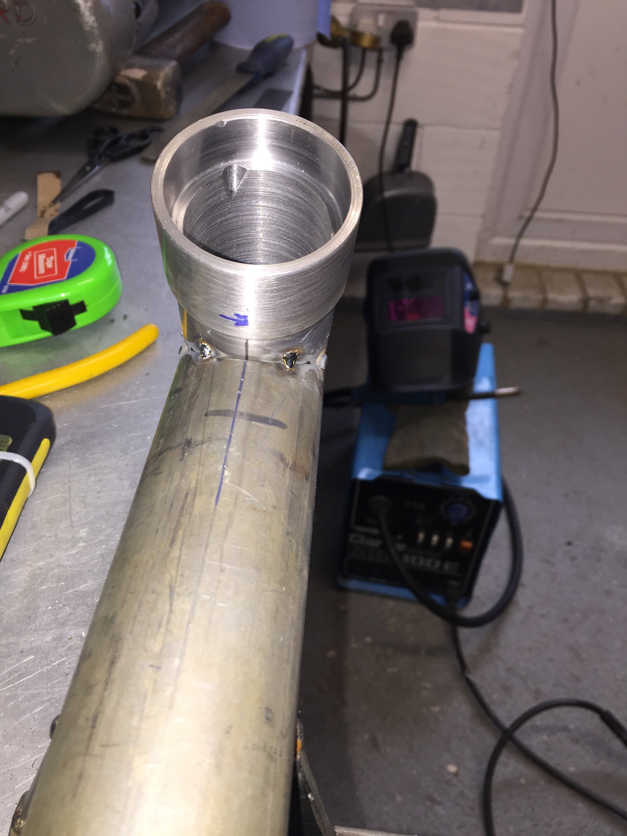

Not done much today, had jobs around the house to do. I have scored a datum line down the headstock as a reference when I come to weld it.

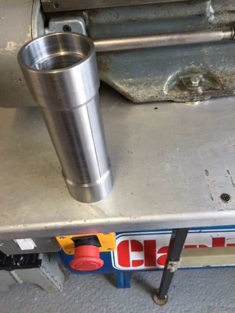

I machined it from a new piece of round stock. Boring it out was quite difficult on a small ML7 lathe, very slow and time consuming. The internal bore isn't as smooth as I'd like, but as no one will ever see it, its not an issue. The bearing seats are good though.
One thing I did find out, I have two sets of the same bearings from the same supplier, however one outer race is slightly smaller, which means that it in future if bearing replacements are needed, bearing fit adhesive might need to be applied as I machined the bearing seats to the larger size. Not an issue for me, but does highlight the difference in tolerances even on 'precision' items.
I can feel your pain, that would have taken a LONG time, still looks the ducks nuts mate

Tac-welded the headstock onto the frame spine today. Was a bit nervous, but heated it all up and then bit the bullet and went for it. Turned out ok.............I think.

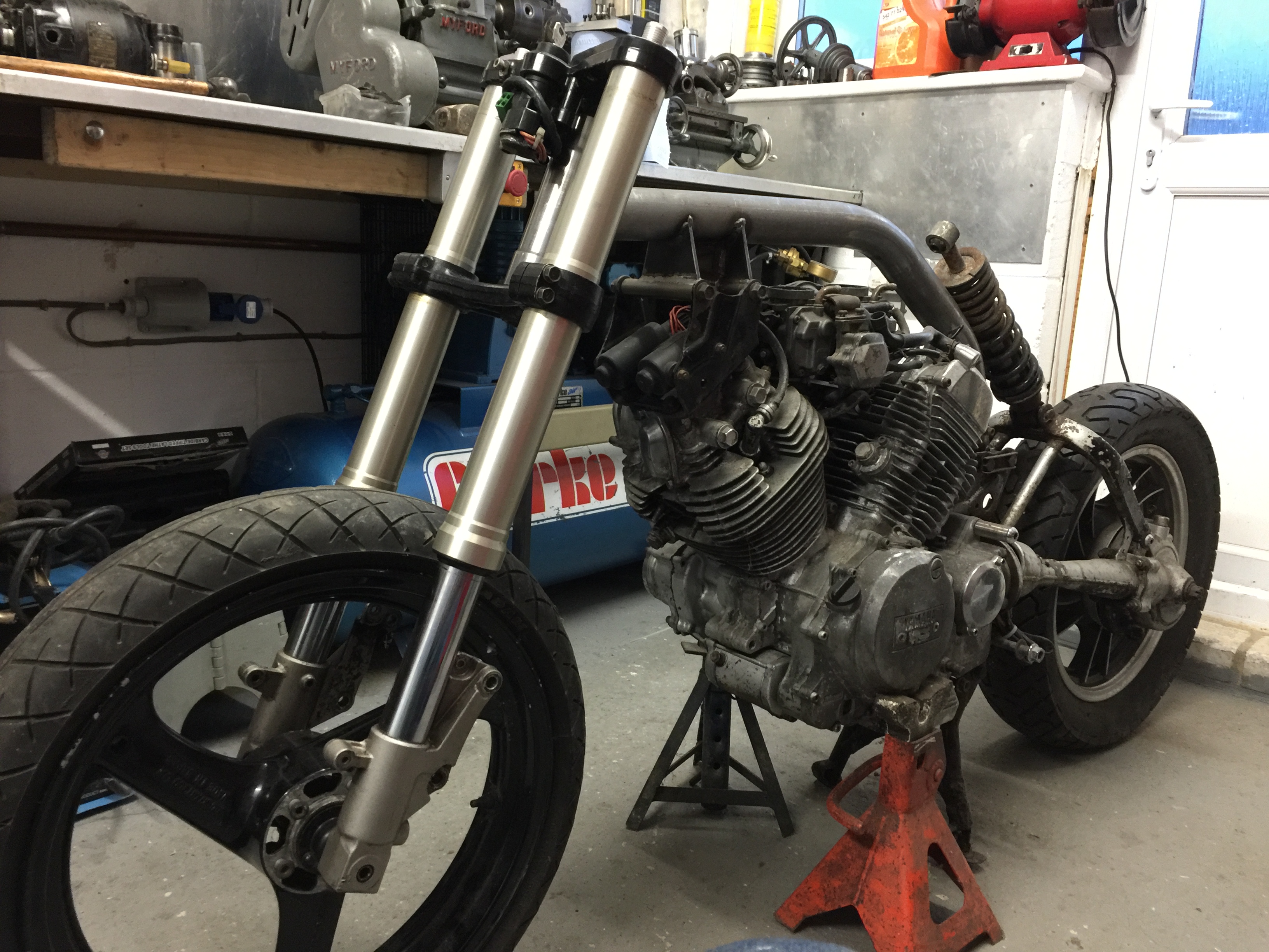

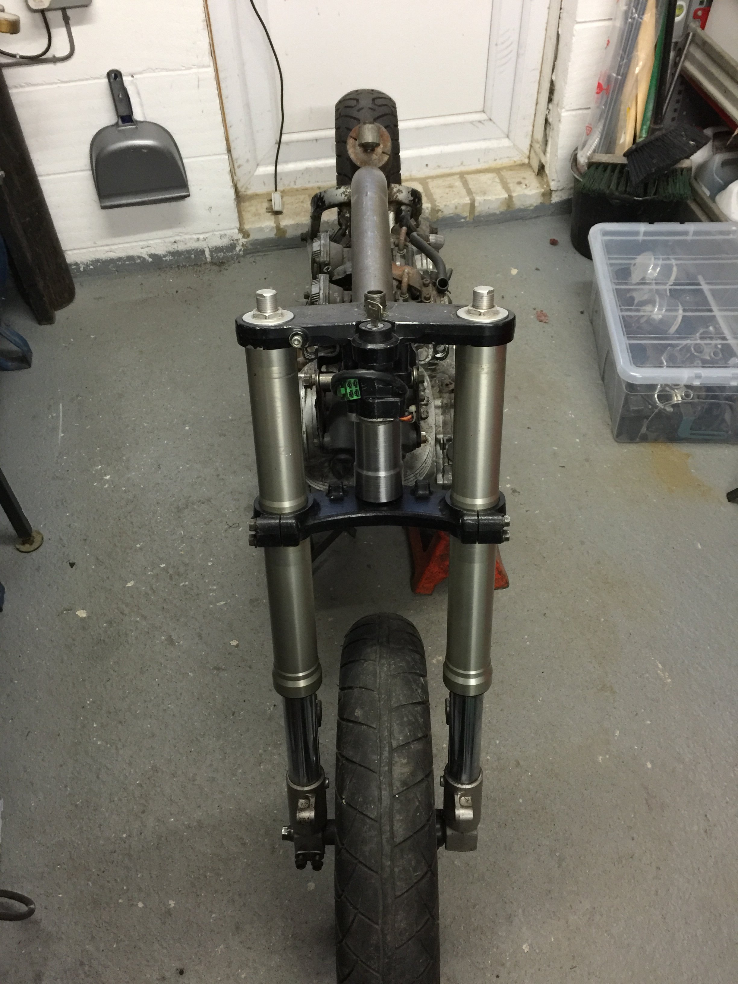

Then mocked it up with wheels and all. I need to level the machine and double check alignments before I final weld the headstock. I'm pleased with it so far.

looking good.

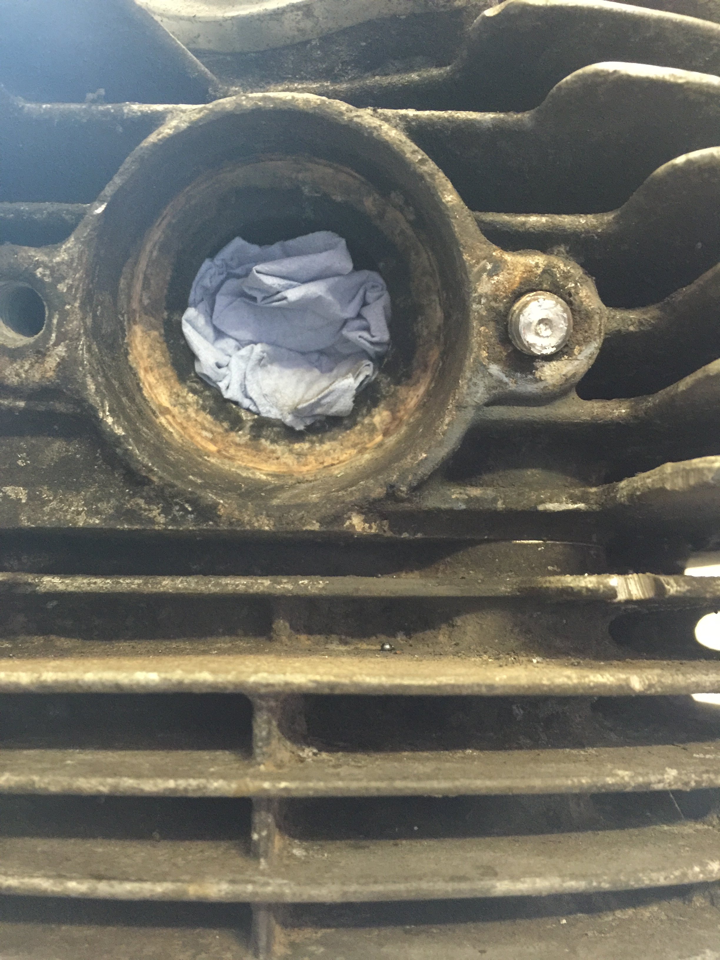

Managed to get into the garage today, although not a very successful day, I managed to shear off one of the exhaust flange studs, even after heating it up prior to remove it. >:(

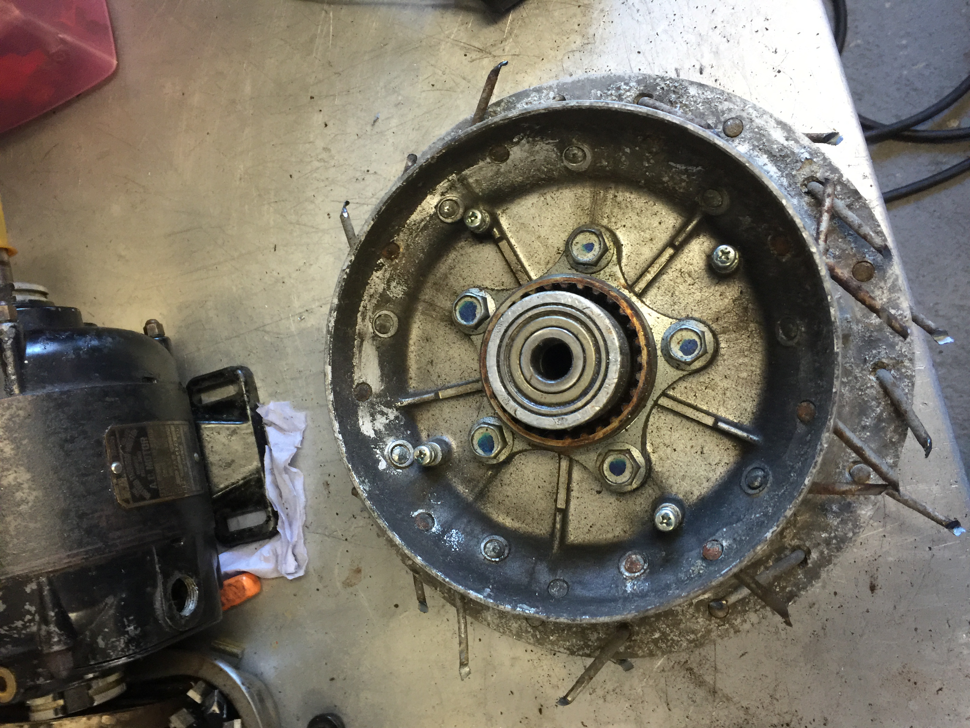

On a more positive note, I started work on the rear wheel. The XV500 has mag wheels as standard, however it's my intention to have spoke wheels on this build, so I acquired a rear wheel off a XV535. The rim is totally rusted, however the XV500 uses a 16inch rear, whilst the XV535 uses a 15inch rear, my plan is to use a 17inch rim front and rear, giving me more tyre choice.
The best way to remove rusted spokes is to soak the nipples in WD40 or similar overnight and then ease the nipples off one at a time. Bollox to that, an angle grinder sorts the problem in minutes!
Great work so far, especially welding the head of the frame. Have you checked the alignment? Most people build a simple frame jig when they chop their frames.
As for broken studs, the method I use when they break in the meanest possible way is ..... nitric acid 8) It works like a charm, eats steel and leaves aluminum without damage.
