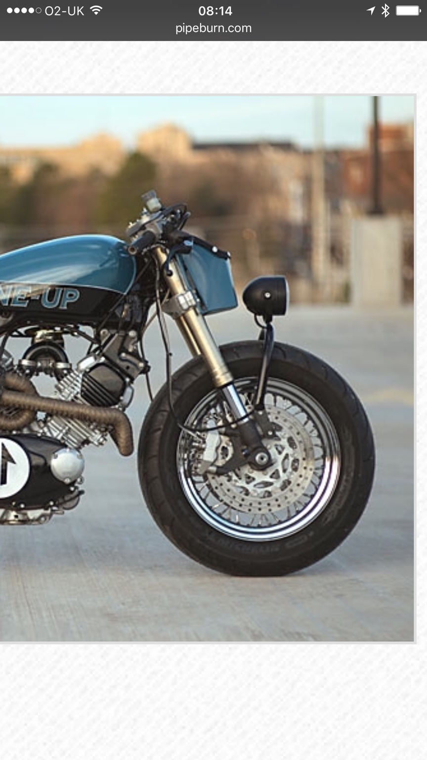

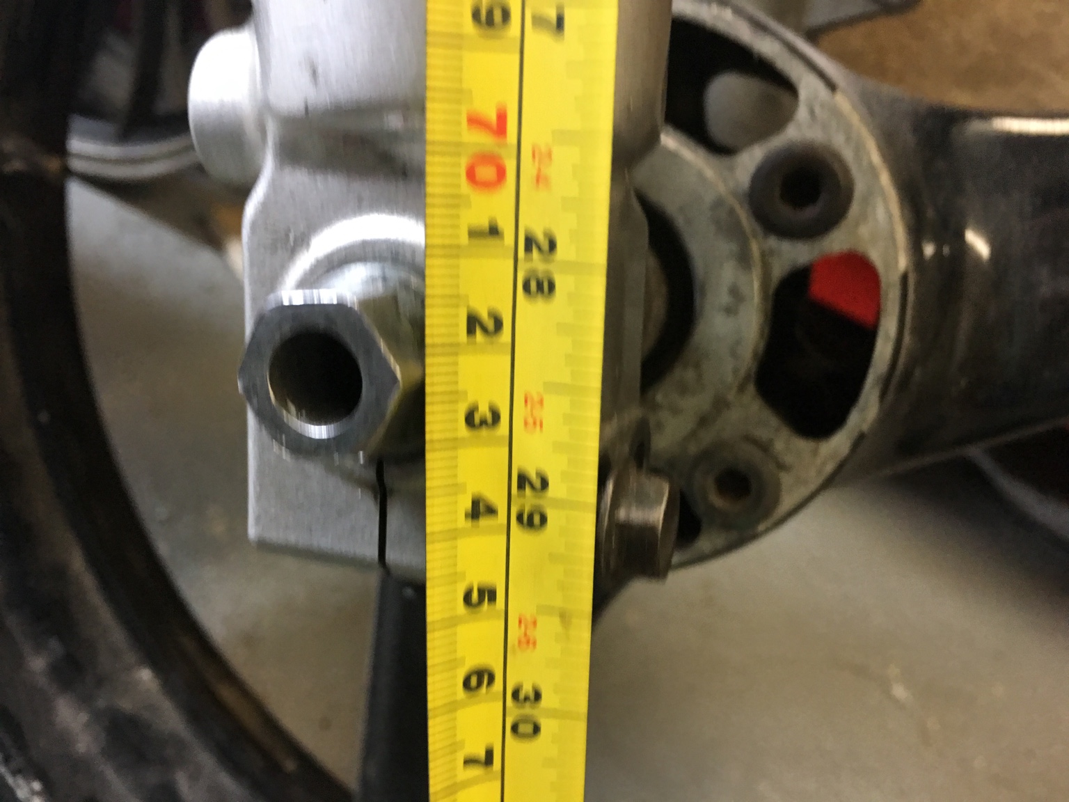

I've measured the front fork, from spring cap to wheel spindle it's 73cm with the tube being 45cm. The forks are on the bike but I tried to extend them as best I could. Here are a couple of pictures from professional builders, which were actually built after I started my project (guess it's quicker when it's your day job), look at the lack of clearance on the front wheel.
I'm not disrespecting others work but it looks dangerous to me.
Your forks are longer than the ones I have, but I'd keep an eye on engine to ground clearance.

I agree 100% with you that these projects look dangerous to ride... It doesn't help putting on such fat front tires either I guess. This one look a bit better though: http://www.bikeexif.com/yamaha-tr1-cafe-racer He used a Ducati fork and an 18" front wheel. He looks OK on clearance, even with the exhaust because it seems he hasn't done anything special to it so it 'runs down' right away from the cylinder.

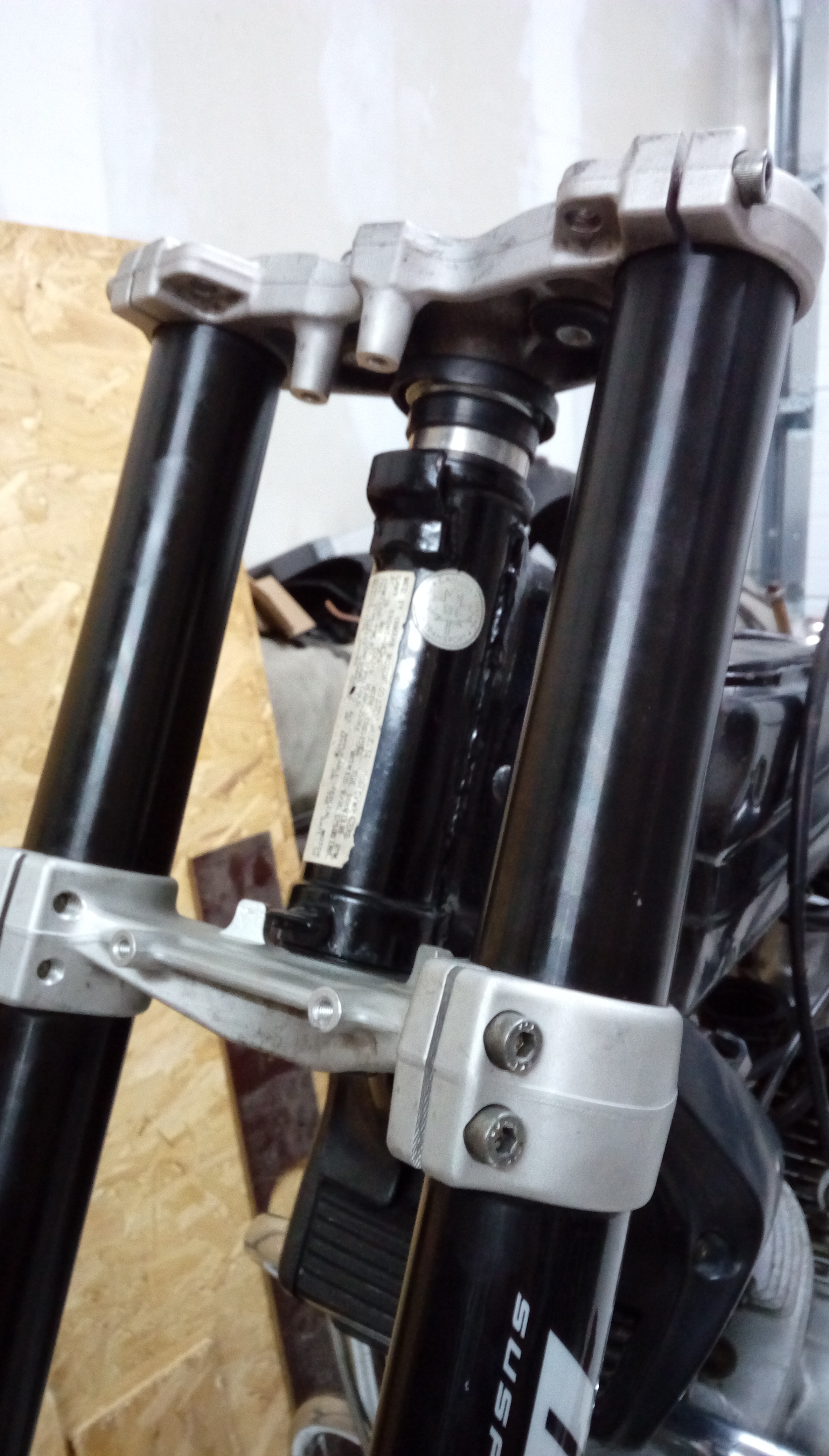

I've lowered the fork by about 2cm as I would when using a spacer on the underside. I then put in the original 19" front wheel because that does have a tire on (see picture). this is a 90/90-19 which is slightly larger than a 100/80-18 that would go on. As you can see there's quite a bit of clearance and I tried compressing the fork as much as I could by putting weight on it (not slowly but really hammering it down) and it didn't hit the engine. I had about an inch left, for what it's worth 'measuring by sight' from the top ;)
An 18" tire would have even a bit more space because of it's smaller diameter, so I think I should be fine there. On engine ground clearance, that could partly be solved by putting in a longer rear shock, partly by riding style... It's not a race bike so the question is how far I will put it down in the corners in real life, then again, you don't want to be caught out by lack of clearance in the middle of a corner. But I think the engine ground clearance is ok for now, and I'm going to replace the rear shock anyway so putting in a longer one is an easy fix.
