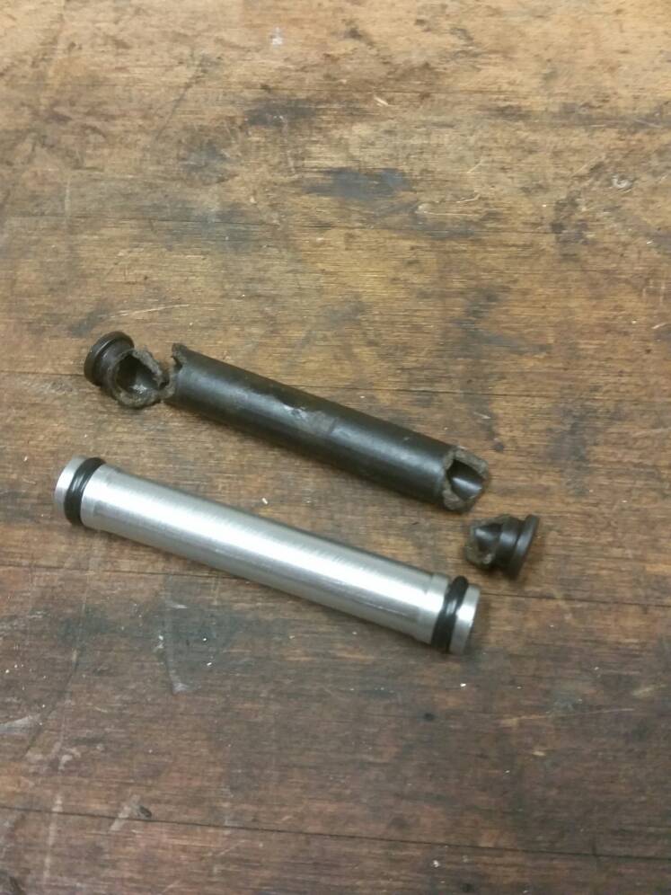

Another evening of fiddling with these carbs. Got them stripped down. At least as far as they are coming apart. They were pretty well laqoured up.
Genius me broke one of the fuel rails taking them father apart than I should have, only to find that replacements are not available.
Once again the old south bend 9 saves the day.
Soaking the bank in pinesol. Gonna try to get them back together tomorrow before I start losing little pieces

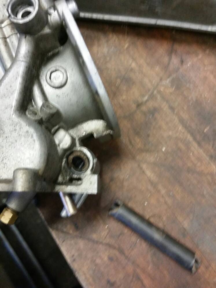

Here's the inside view of the jb weld fix. Still not sure how this happened in the first place...
Oh yeah, someone was trying way too hard to pull those crabs.
