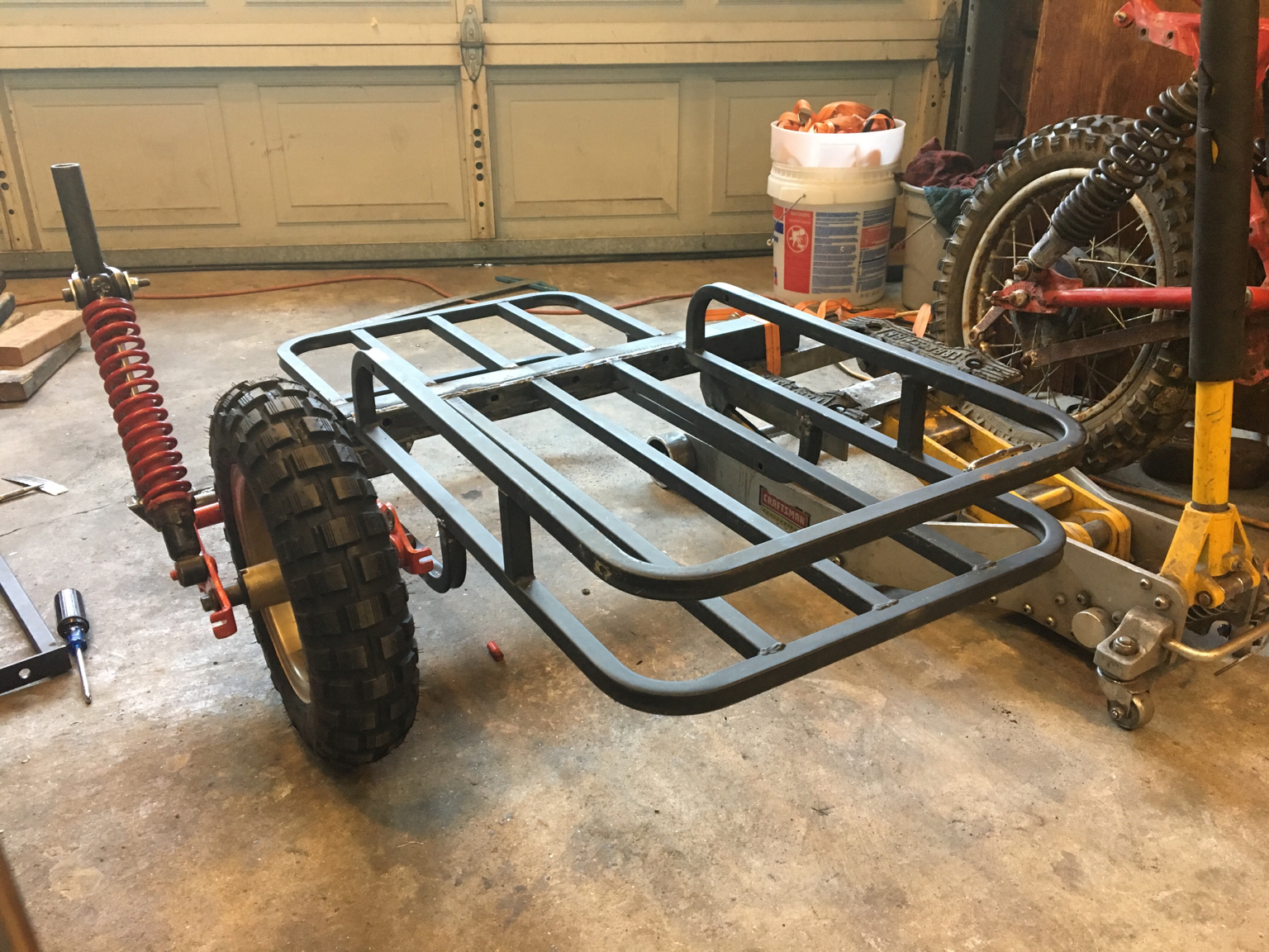

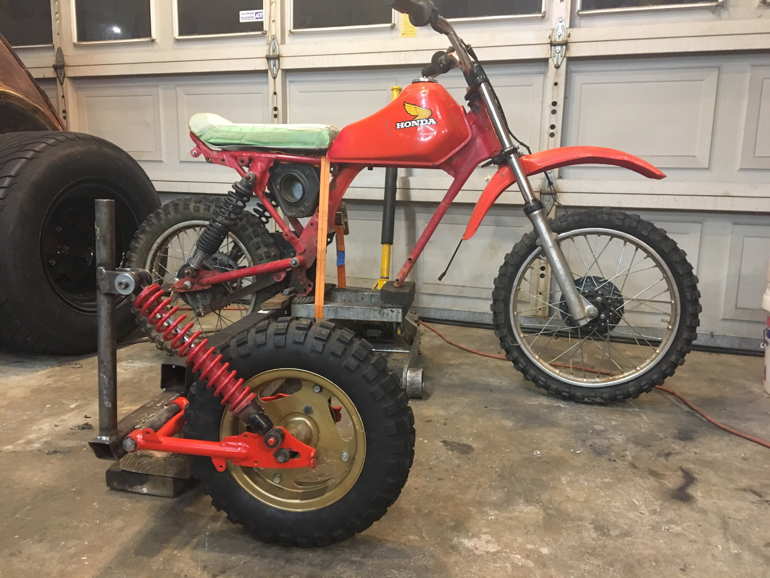

Well, I made a very large wheel lead error putting in at almost 3X what it should be. If I do it at the edge of the tugs rear wheel, it should be 7 inches. I decided to move it to 3 inches for less scrubbing. I also welded some toe-in to the fix.
This also reversed the swinger, which I like better. And made for an inbound shock (also better).
I still need to fab up a forward and aft strut, but it’s mounted through the receiver. Thanks Curtis.

Standard wheel lead for a hack is 8-12 inches.
But the inbound shock and new swinger setup is definitely better, man.
It depends on the size of the rear wheel, how you want weight distributions, and how much tire scrub you want. Standard location is at the leading edge of your tug's rear wheel. On a mini-bike with a 14" wheel, that is no more than 7". Race hacks run as much as 15".
Hopefully that last bit of fabrication before paint. I want a shock that can handle at least 200lbs in the hack. Luckily, I have a pair of cheap CB550 shocks that I have zero intention of running on a bike. Perfect.
