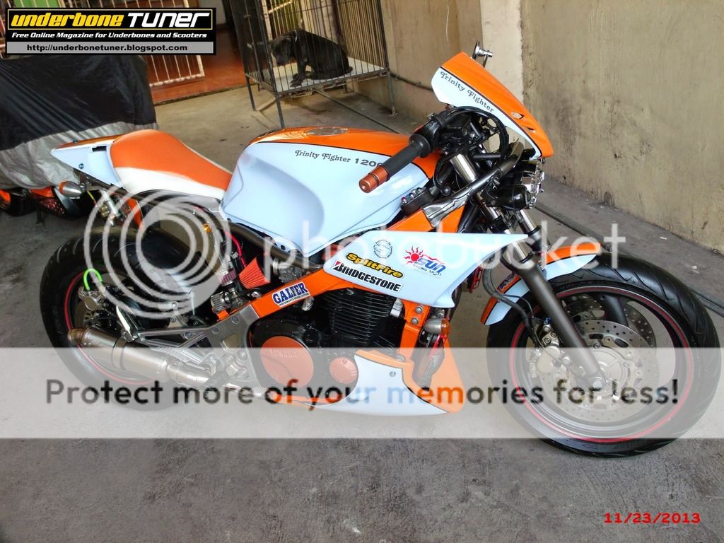

Does anyone recognize the front windscreen on my inspriational bike? It seems like it may be from an atv, but I can`t find any pics for confirmation.
Re: FJ1100 Street Turd
I never thought of that, but I guess it could be. I've never really looked straight on at a belly pan.
