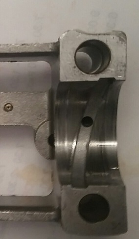

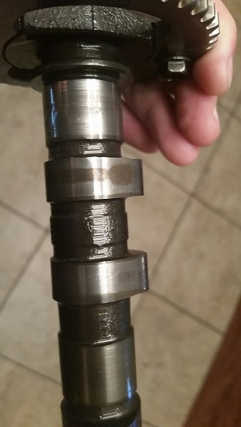

Well just an update. I've been putting a lot of time toward working/applying for my next job, and interviewing. Finally found some time to tinker. Main reason for the update is to state that the project isn't dead. Since the crank has to come out I'm pulling the cams tonight. Hoping the results of oil starvation didn't hurt the top end. What do you guys think of the wear on the cam/bearing? Thanks in advance.

Updated to more soberly taken pictures. Just showing the worst of the bearing surfaces which is the end bearings. All of the end bearings were similar, other surfaces untouched.
