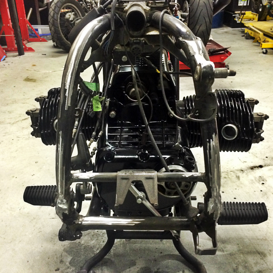

Clutch sorted and top-end sorted (mostly) - I now had the perfect opportunity to prepare the rear section of the frame. It was easy to chop the necessary tabs and brackets with the drive-shaft out. A better idea of what was chopped can be seen in the pics in this blog post:
http://findyourexit.com/one-up/
